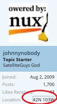

Isn't johnnynobody too far west to join the 30W club?
The Lat/Long puts it somewhere SW of Alliance, Nebraska.
On Dishpointer, it shows 30W for Alliance at 3.9° elevation. That low on the horizon, the corn and center pivots might get in the way
