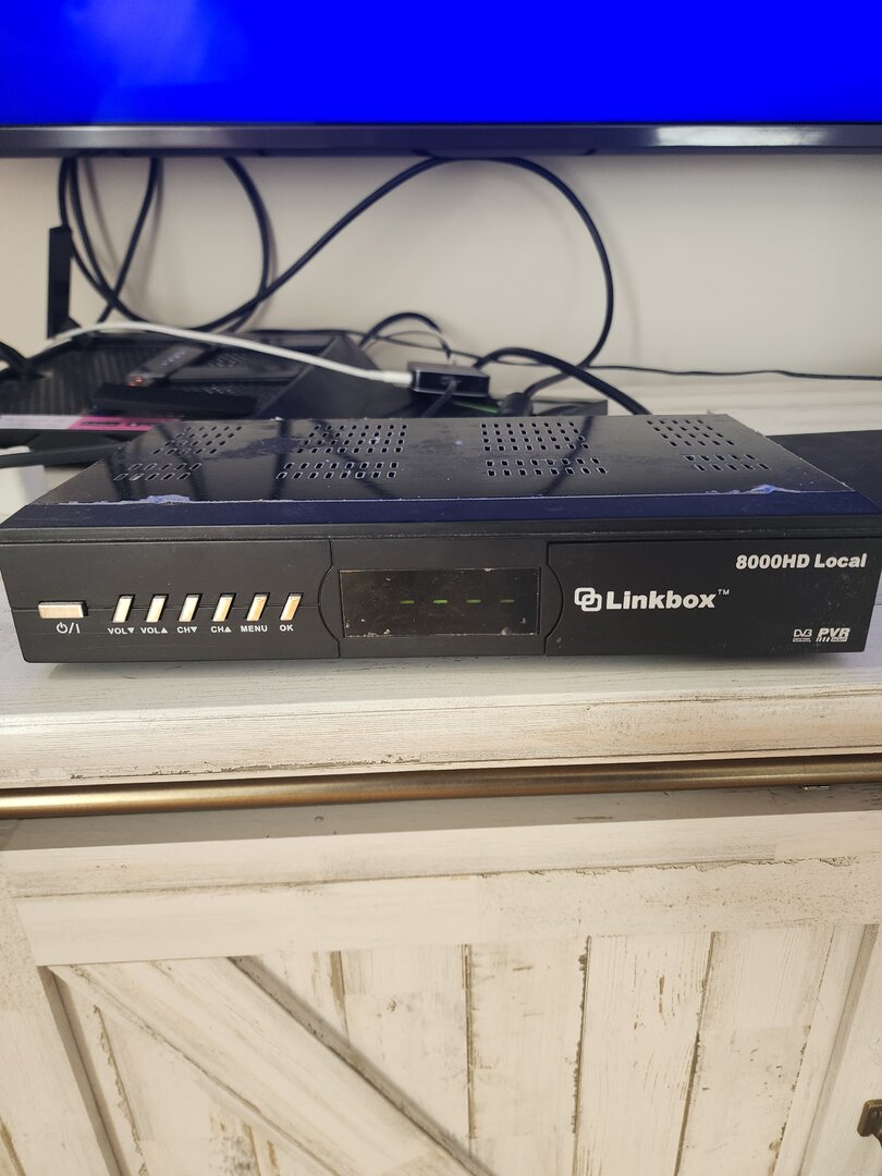

Thank you so much. Maybe my receiver isn't compatible with the dvb s2 signal.
Reactions: comfortably_numb
Yes that's the one! Yes makes sense now. Every other tp is DVB s and this is DVB-s2. Do you recommend any inexpensive receivers? Thanks :)
I'll defer to others, like KE4EST and Hyper Casey since I haven't bought a receiver in a while. One of those 2 guys will point you in the right direction
I may have misread the manual; it didn't look like it had support for S2
Weird, the manual you had posted didn't have DVB-s2 and the one I had found does. Maybe two different receiver versions? I guess the only way to find out is by getting a fully compliant dvb s2 receiver lol.
