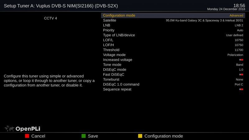

I have Ortho feeds for my C and Ku bands, and always had problems with the Ku having duplicates channels, tonight I follow your suggestions to set the threshold to 11700.
This is my setup now and I do not get any more duplicates so far on Ku.
Thanks this work for me.
Regards.
