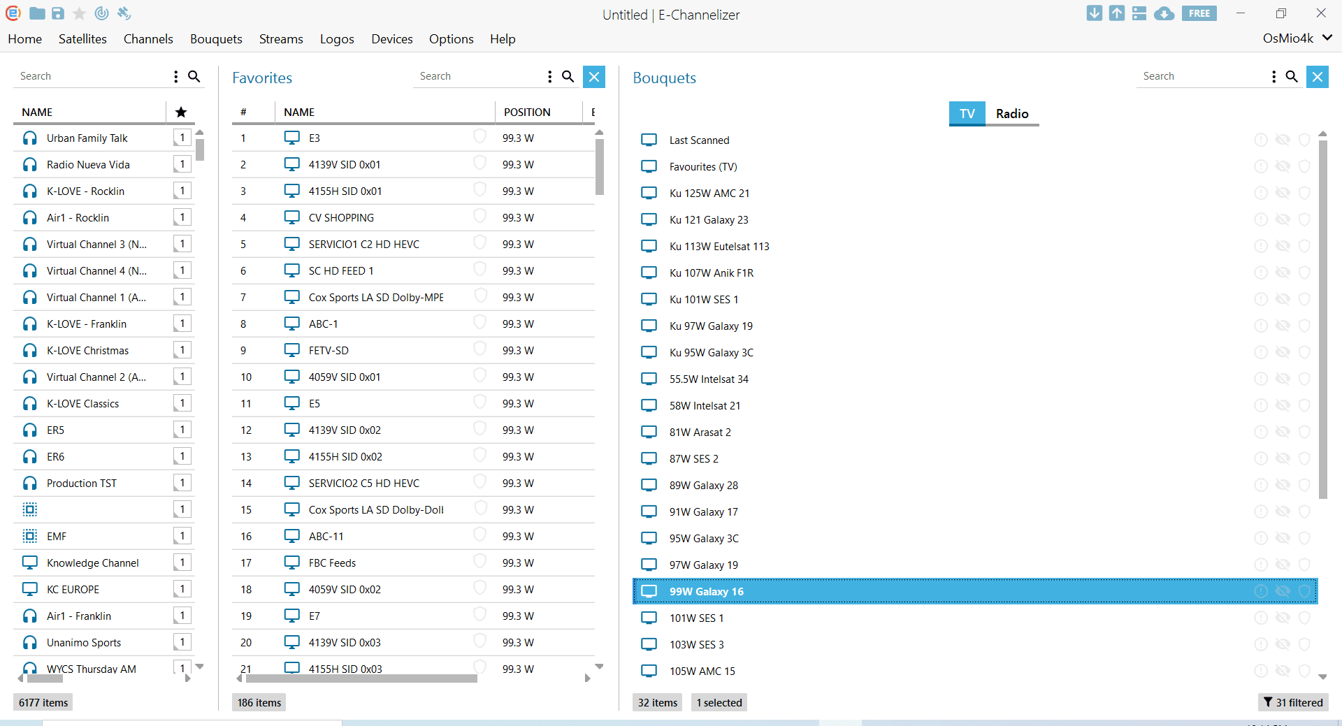

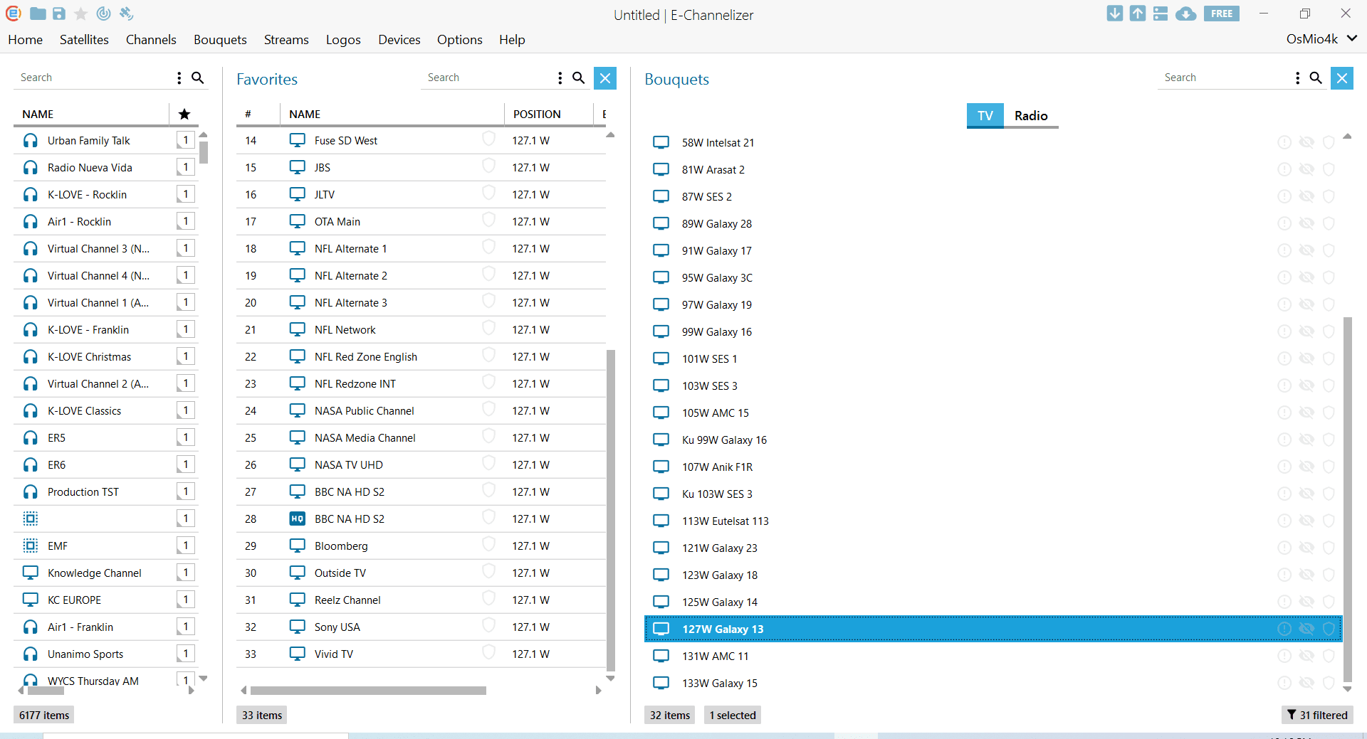

Just download E-Channelizer. Channel editors have been used since Dreamboxes were the thing.
It's easy to use, you can create your own bouquets and name them whatever you want to.
Rename channels. Reorder them, drag 'n drop. As I mentioned I use the TVROSat satellite charts for my reference.
Write, read, and save the lamedb on your pc so you can quickly restore it all. To other images even!
I know you're eager to do it all on your receiver but there are some things that applications do so much easier and better. And most importantly, faster. So you can get along watching channels.

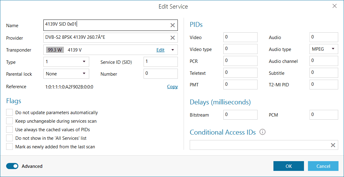

Hey arlo! Interesting program. A question for you. That option under flags - Keep unchangeble during services scan. Does that set a flag so that a channel you already have scanned in and have changed the name to something you understand is not renamed back to something like 4139V SID 0x01?

Hard to say. Try it out and give it a go. To be honest I just use it for the basics. I had a trial of the full version and there are a lot of other bells and whistles in it.
I would believe what you said may be true. I wonder if it's channel specific.I do know I have used a couple of other editors and once I had a completely borked lamedb file. So far this one has been rock steady.
I might try a blindscan of 127W today a couple of ways and see if the NASA channels get renamed back to TP & SID if I tick the check boxes. Sounds like a plan!

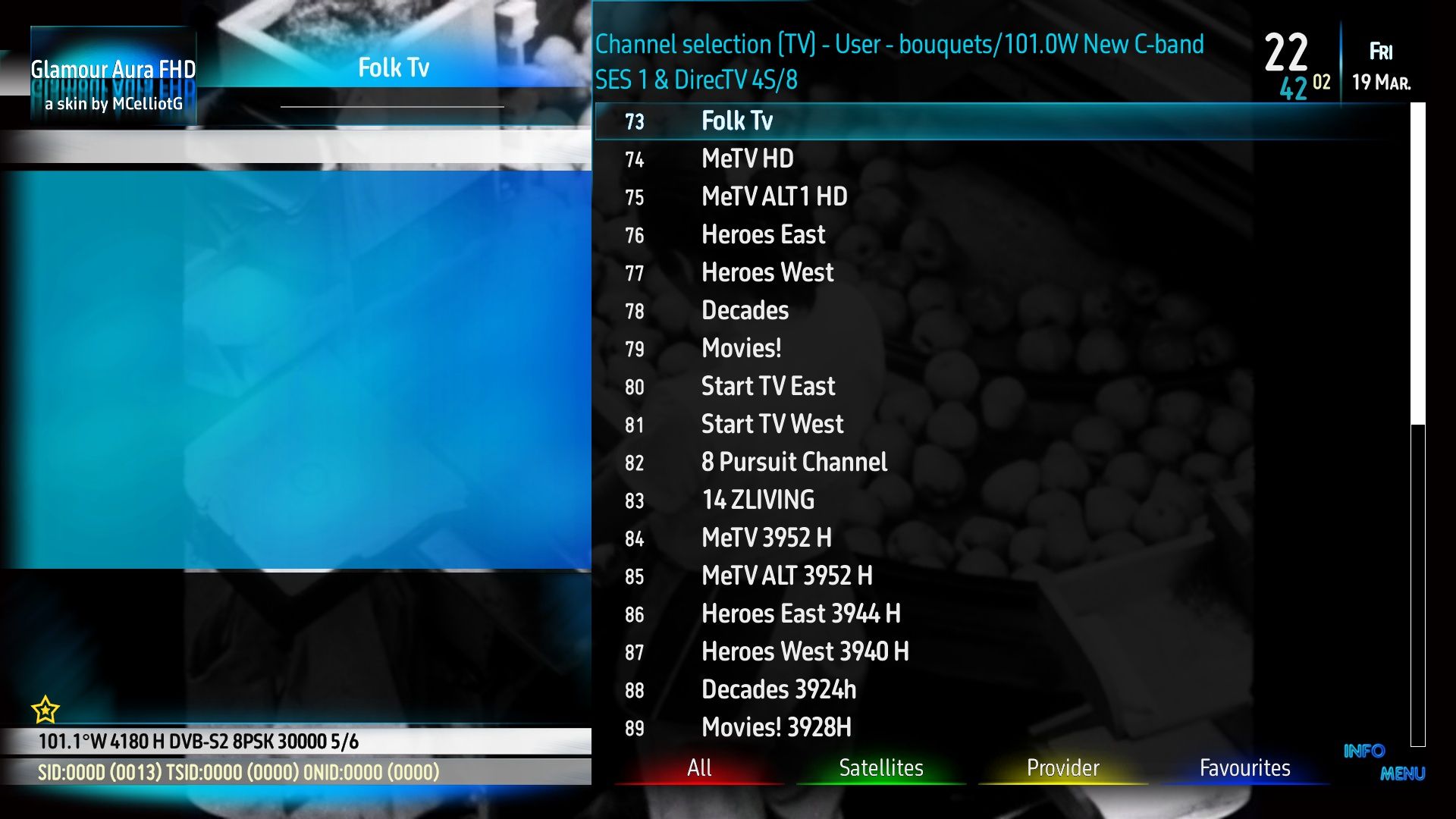

I don't understand the reluctance to create favorite Bouquets. It's a piece of cake to do it in the WebIF. Then highlight and put any channels in there you want. Once that's done, you can change them all you want. Otherwise, every time you do a scan, it'll overwrite the names.
I only have a couple of Bouquets set up and like the ability to include channels from multiple satellites and tuners. Here's a screenshot from one that includes channels from 87W, 101W, 103W, and the OTA tuner.
