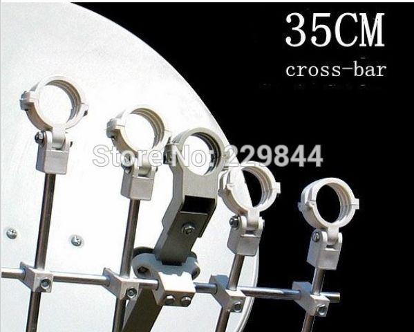

I have this on order.. This looked like a good method.
http://www.aliexpress.com/item/Free...-to-5-ku-band-LNB-5-satellite/1840755003.html
I just bought one of these and started setting it up this past week, it's ok, but the aluminum rods are cheap and tightening the bolts to the point where the LNBs will stay put gouges them a bit and makes it hard to adjust. Other than that, it's good, I only have 87W and 97W setup so far. I'm planning on replacing the rods that came with it with some solid stainless.

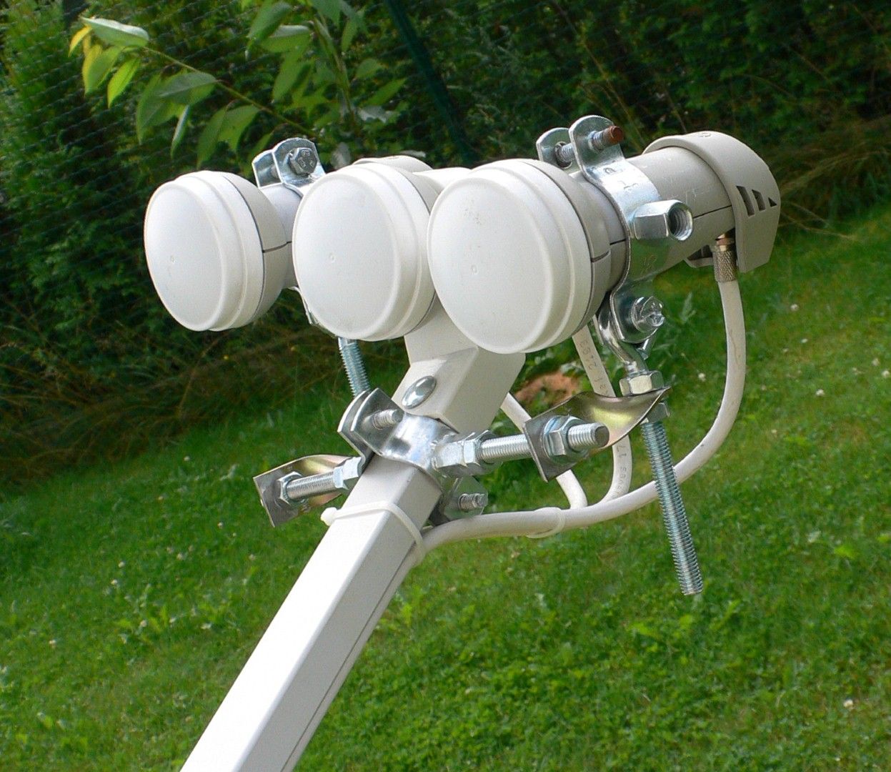

When/if I need to make multifeed I go to any Homedepot-like store and buy cheap galvanized stuff. And then just put everything together. Pipe clamps also available for 60mm pipes. :bday

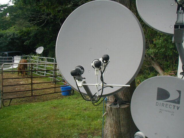

This is a old thread, but I was outside taking pictures of my C dish today and took a picture of the multi-LNB mount that I'd bought a while back, it's on a 30'' DS2076. Center LNB is 87W, then 97W and 103W. Getting 103W was a real PITA, as you can see in the picture, the LNB is crammed right against the one for 97W.
