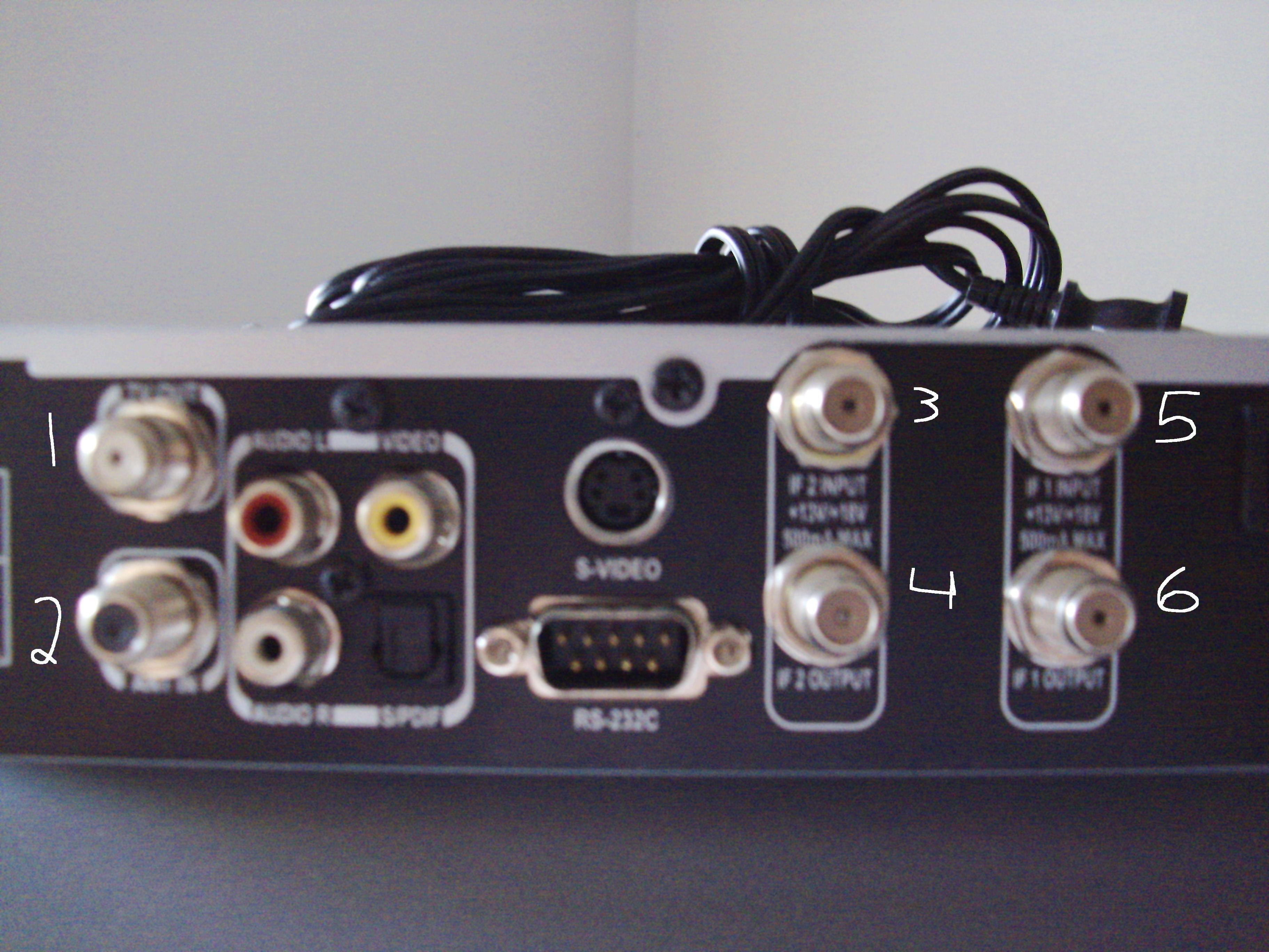

OK....its hooked up wrong
From the dish hook that into "Sat A IN"
Hook a cable from RF out to the TV
If you want to use the 2nd tuner, hook a cable from "Sat A Out" to Sat B in
ok...here is the back of my Pansat 6000.....yours probably looks similar but note the names of the inputs
cable from the dish/motor goes into the far right top input (#5 on the pic...IF 1 input)
cable to TV is the one on the far left top (#1 on the pic...RF out)
if I wanted to use both tuners, run a cable from the far right bottom (#6 on the pic...IF 1 output) into IF 2 input (#3 on the pic....IF 2 input)
#4 is not used
#4 is not used
Is IF1 OUT and IF2 OUT the same as an RF OUT? Wouldn't that need to transmit to analog channel 3 or 4?
The manual for the SV360 states the IF1 is for another LNB or to go to another receiver. IF2 is also for another receiver.
