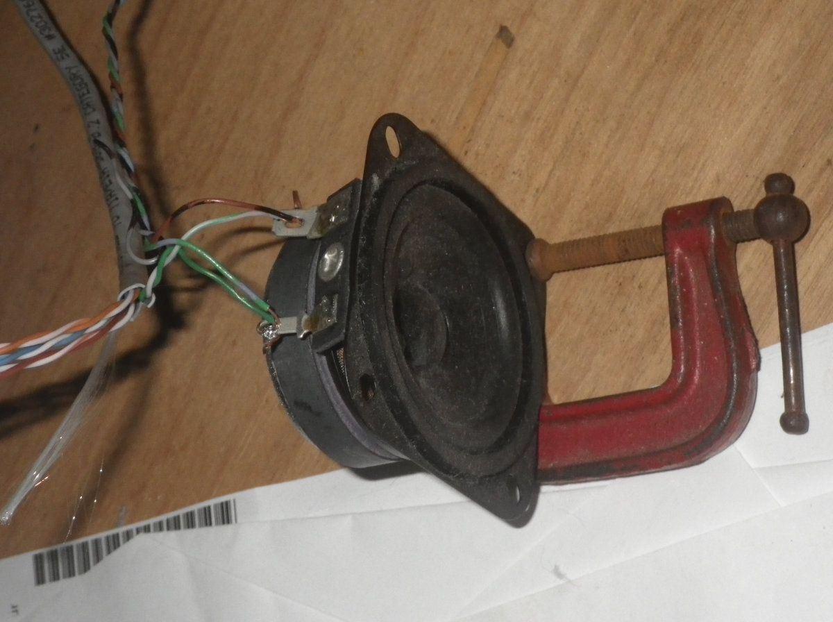

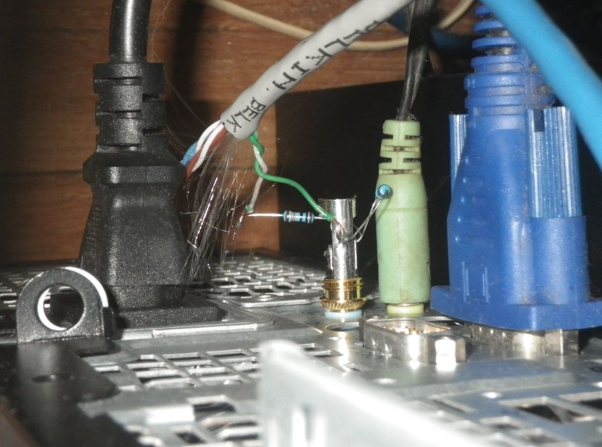

Hi all, decided to get back on HF and picked up a nice basic ICOM IC-718. Not planing on putting up much of an antenna so weak signal is important. Some of the digital HF modes do very well on weak signal and one of the new modes that caught my eye was FT8. While I'm not sure I will use it for contacts - seems too automated but it may be a good way to see what bands are open. Just got my 40 meter dipole up and have been playing around with the new rig. Decided to do a quick hack to feed audio from the rig to the computer Mic in jack. Check out the pictures below for a quick and dirty/dusty external speaker and audio cable. Used 10 to 1 voltage divider (100 and 10K resistors) at the computer mic line in to get the audio down to the correct level. Works great and will hold me till I get my interface and set it up. (SignaLink USB)

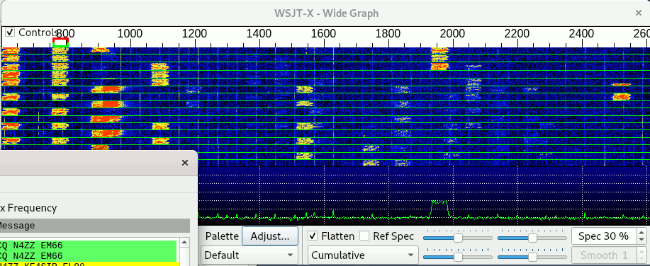

The FT8 is very busy and has a very distinctive 15 second TX and 15 RX. I found a lot of activity on 707400 USB even when the band seemed dead.

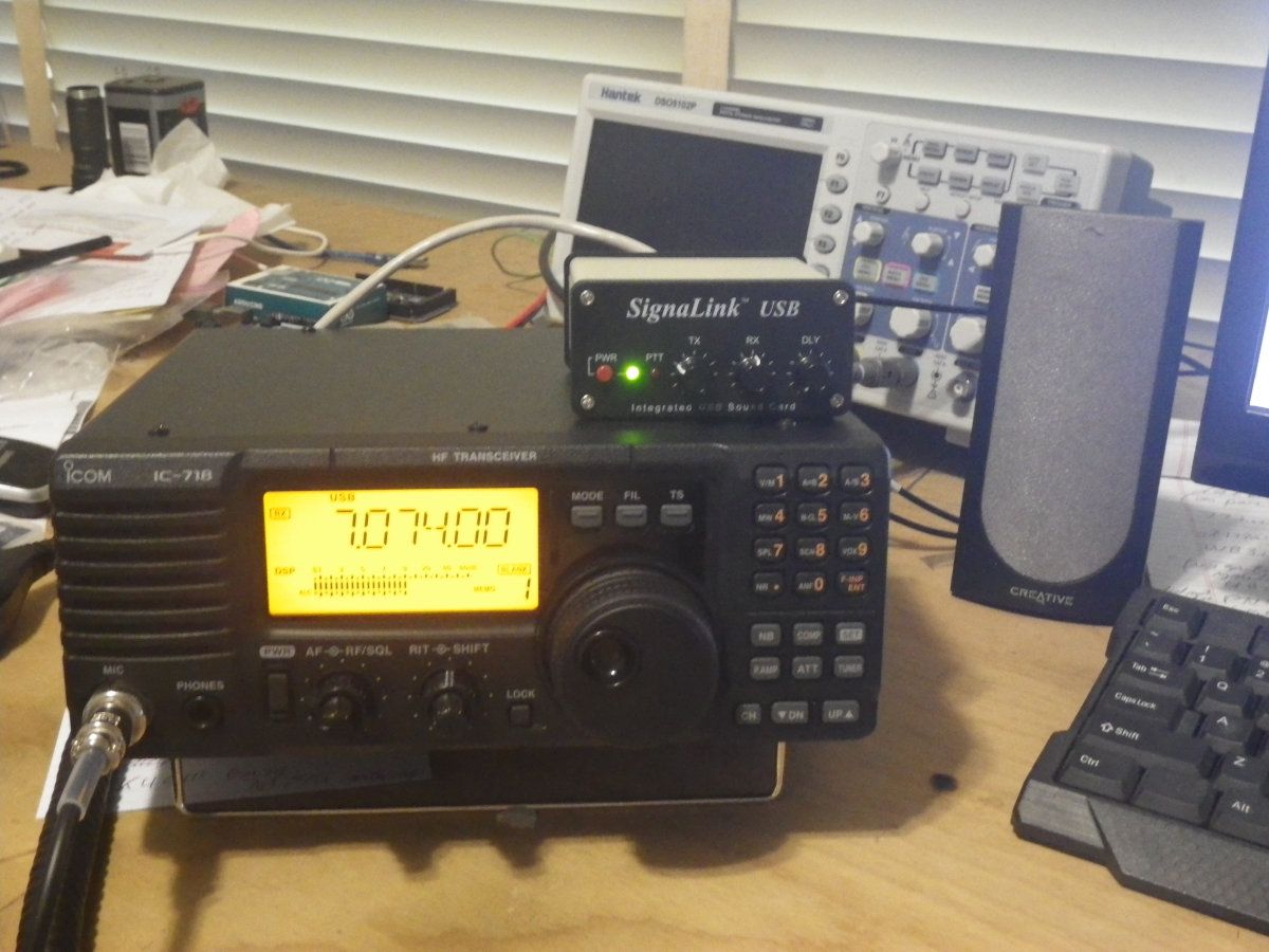

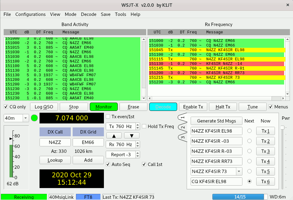

Have not tried WSPR yet but plan to. Just got my interface setup and after some TX testing on a quite part of 40 meters (7070) I moved up to 7074 and gave FT-8 a try mostly to see if everything was working and sure enough made some contacts.
Next I went to pskreporter.info and was stunned to see how many stations heard me. I was running only abt 20 watts into a low 40 meter dipole.
This new digital stuff is amazing!
Reactions: fred555
Here are a few pictures some might find interesting.
BTW - I'm running Debian Linux (Buster), the instructions that came with the SignaLink USB did not cover Linux - only Winblows. It worked fine with Buster :-)
