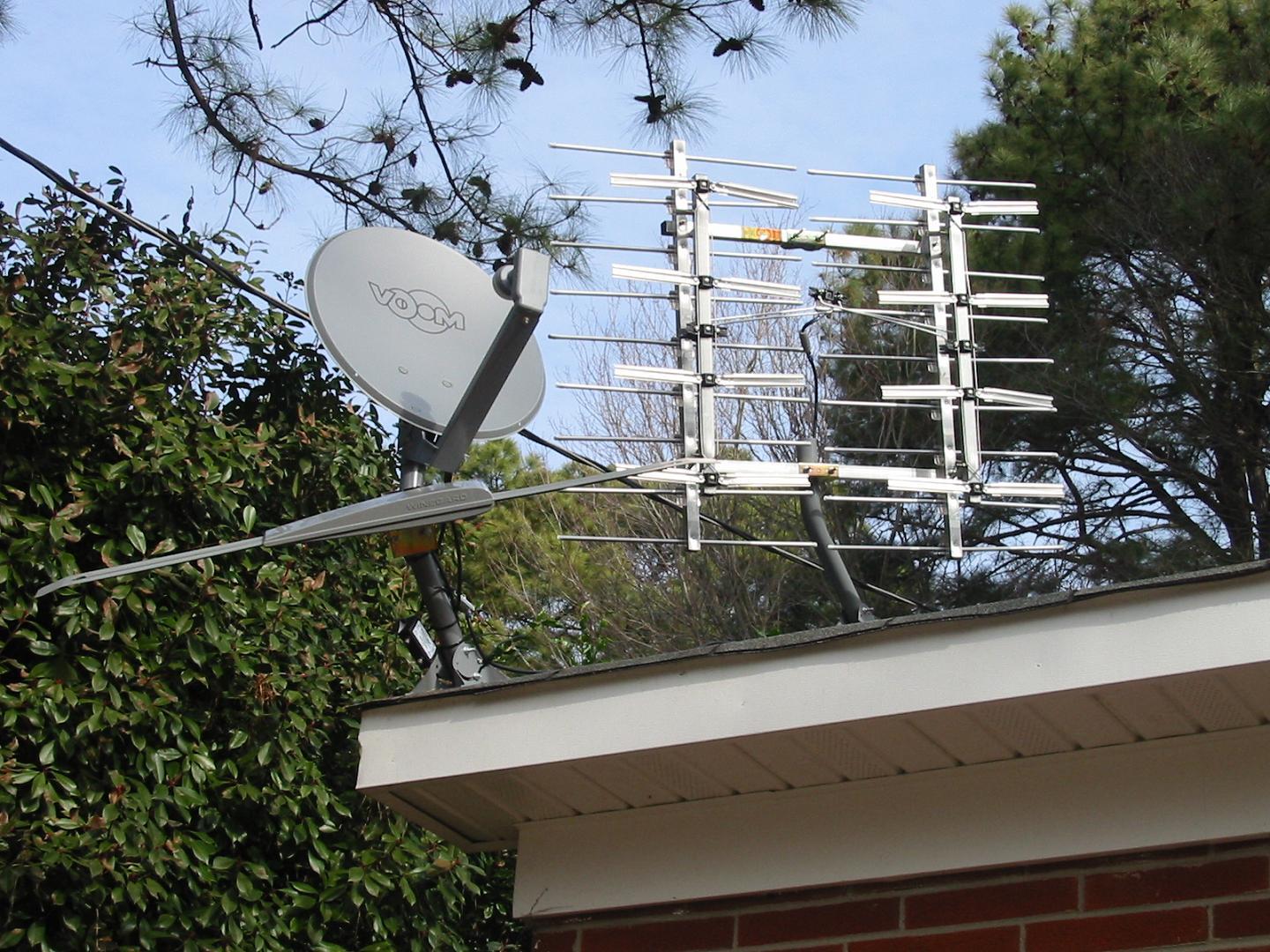

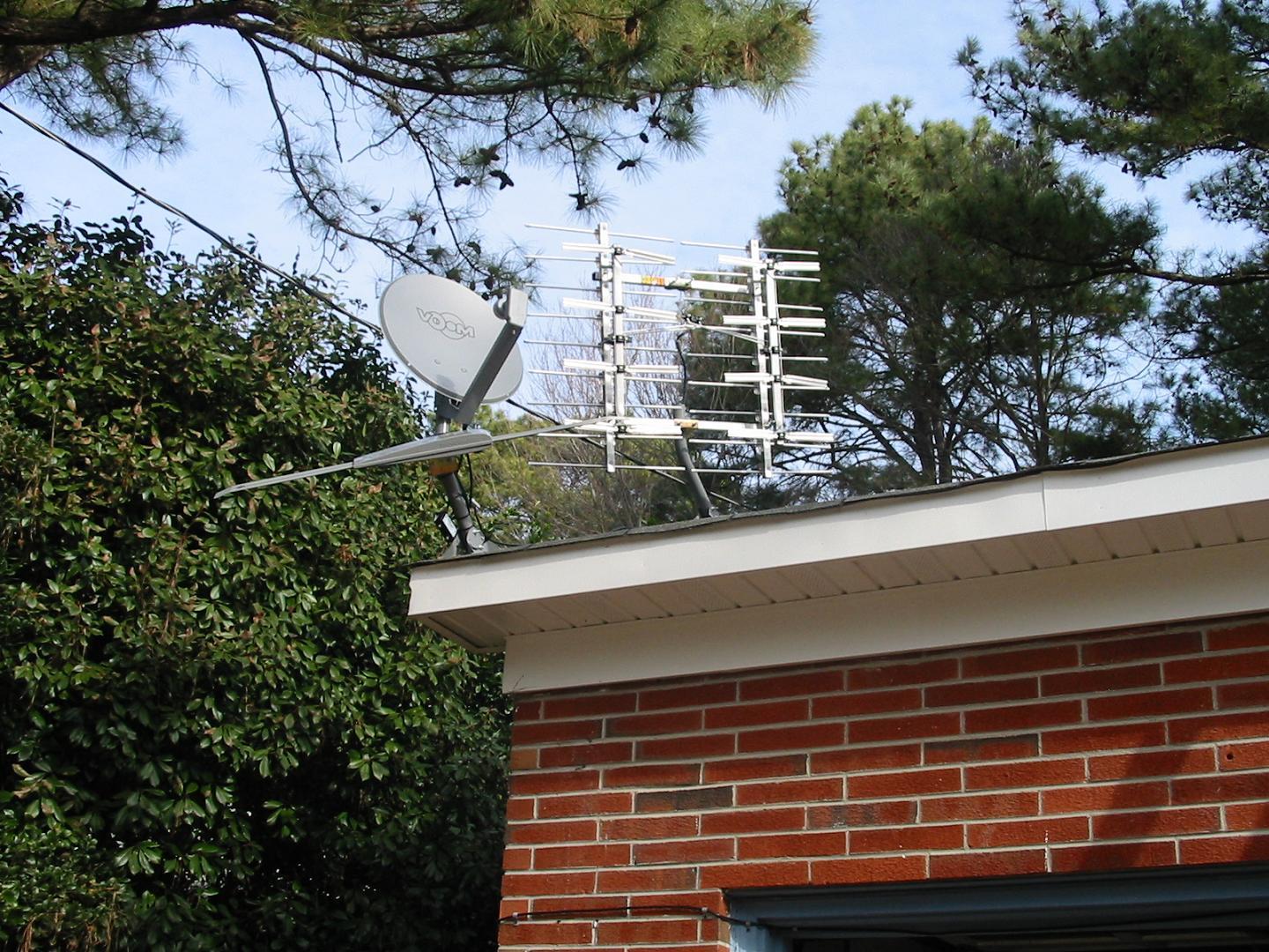

I've been with Voom for about a month now, and I'm having problems with OTA channels. I've had installers come out 3 times now, with 4 now call, no shows. Originally my problem was that I could get all OTA channels, but could not get certain ones consistently without breaking up. I finally got the upgraded antenna and now the only channel I can get is PBS. I explained my situation to the installer and he just shrugged his shoulders and told me, "I don't know what could be causing the interference." One thing I noticed was when he was aligning the antenna, he didn't use a compass. He just eyeballed it! I've attached a picture of the antenna. If anyone could give me any suggestions, I'd really appreciate it.

Judging from your photo.....the OTA should be located at a higher level. I had a problem with my OTA and called Voom. the installer came out and relocated the OTA away from the SAT and mounted to a chimney.... your OTA seems too close to your SAT ...have it relocated to a higher level away from SAT if possible...Get on the phone with Voom and demand to relocate and set up your OTA properly...eye balling the setup is rediculous...BTW I get all local channels now
.... OTA seems too close to your SAT ...
FYI the standard location for the "batwing" antenna is right on top of the dish, works fine there. 93-98 signal, my distance to the broadcast antennas is 18.1 miles clear line of site though.
Rudyr how far away are your broadcast antennas? Clear line of sight or do you have hills/buildings/structures in the way (maybe causing multipaths)? Though not directly related, do you get standard analog stations okay?

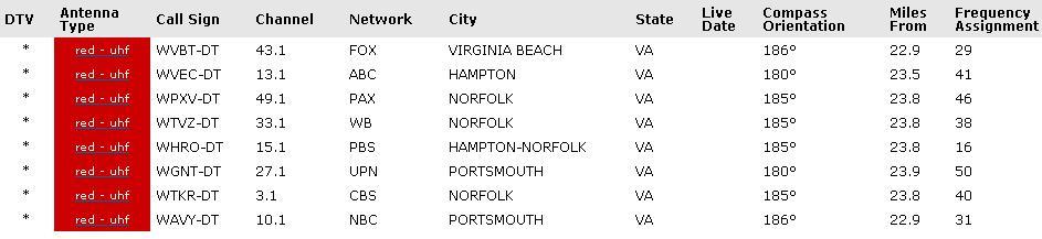

Thanks for the suggestions guys. I just called Voom and they said that they would send someone out Tuesday Feb.1 :eek: Hopefully Voom will still be up by then. The furthest tower away from me is 23.9 miles. There are no hills or buildings that should be obstructing either. I'm just baffeled how I was able to get more channels on the old Winegard than the "new upgraded" antenna. I've attached a photo from Antennaweb.org so you can see all the info.
This is my first time switching from cable, and I'm really starting to regret it. I'm hoping I can finally get this all resolved so that I can just sit back and enjoy my hd while it lasts.

Ok Here is my 2 cents . It is no wonder your first antenna is no work it is install wrong 1st of all it should not be below you dish and your sencond antenna is way to close to the dish and 1st antenna to be getting anything i am not sure who installed this but i can tell you what he need to go back to the voom training class cause i can asure you that is not how he was train to install the OTA . good thing he is in VA cause he would never pass a QC job from me . No wonder there is so may OTA problems if anyone else is installing these antenna this way.

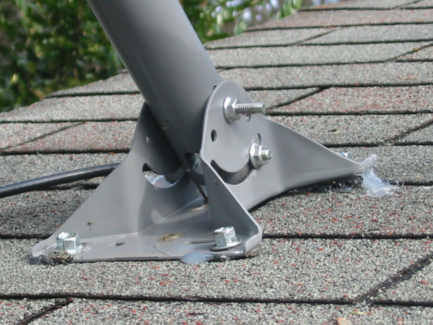

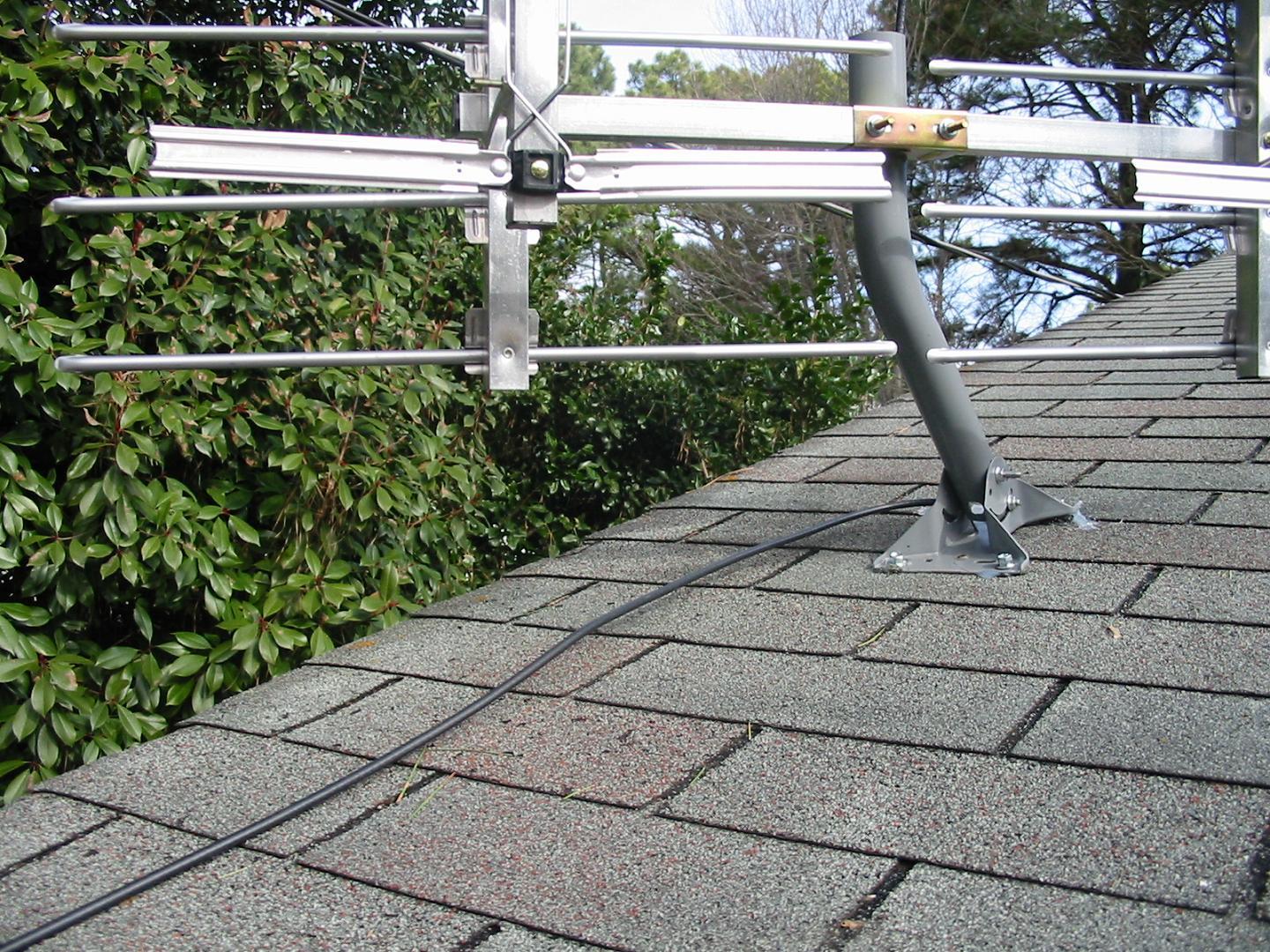

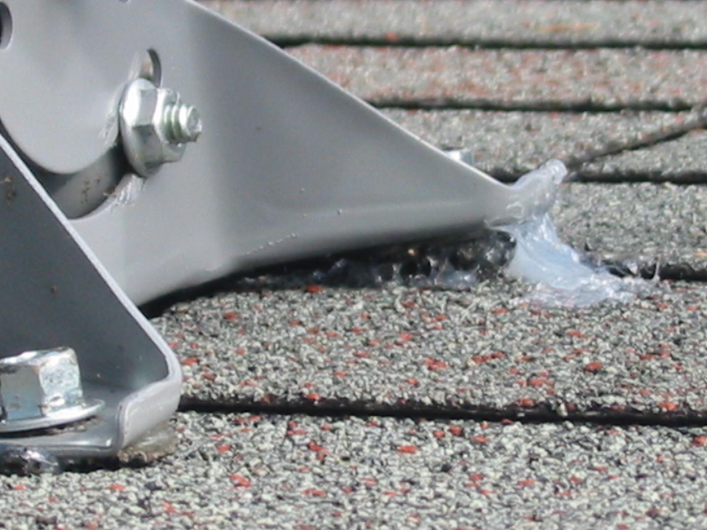

Tyork - After climbing a ladder and taking a closer look, I see that the installer didn't even mount the antenna all the way down to the roof. The metal bracket is not flush with the roof like the one on the dish which is going to lead to water damage. I will take a picture in the morning so that you can see what I'm talking about. By the way, I sent you a pm.

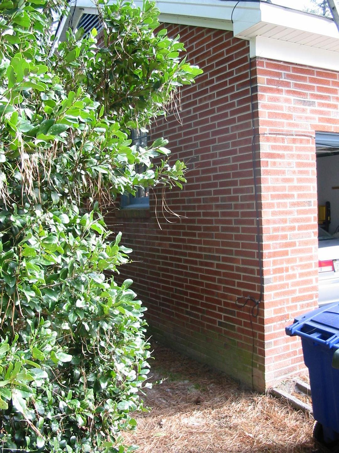

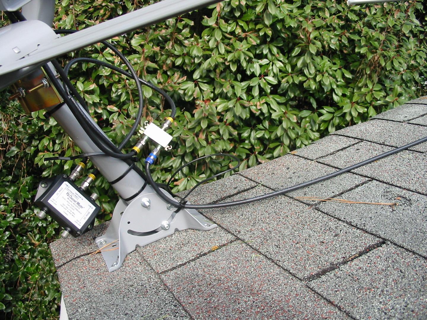

I've updated the pictures in the first post, so that you can see the whole set up in the daylight.

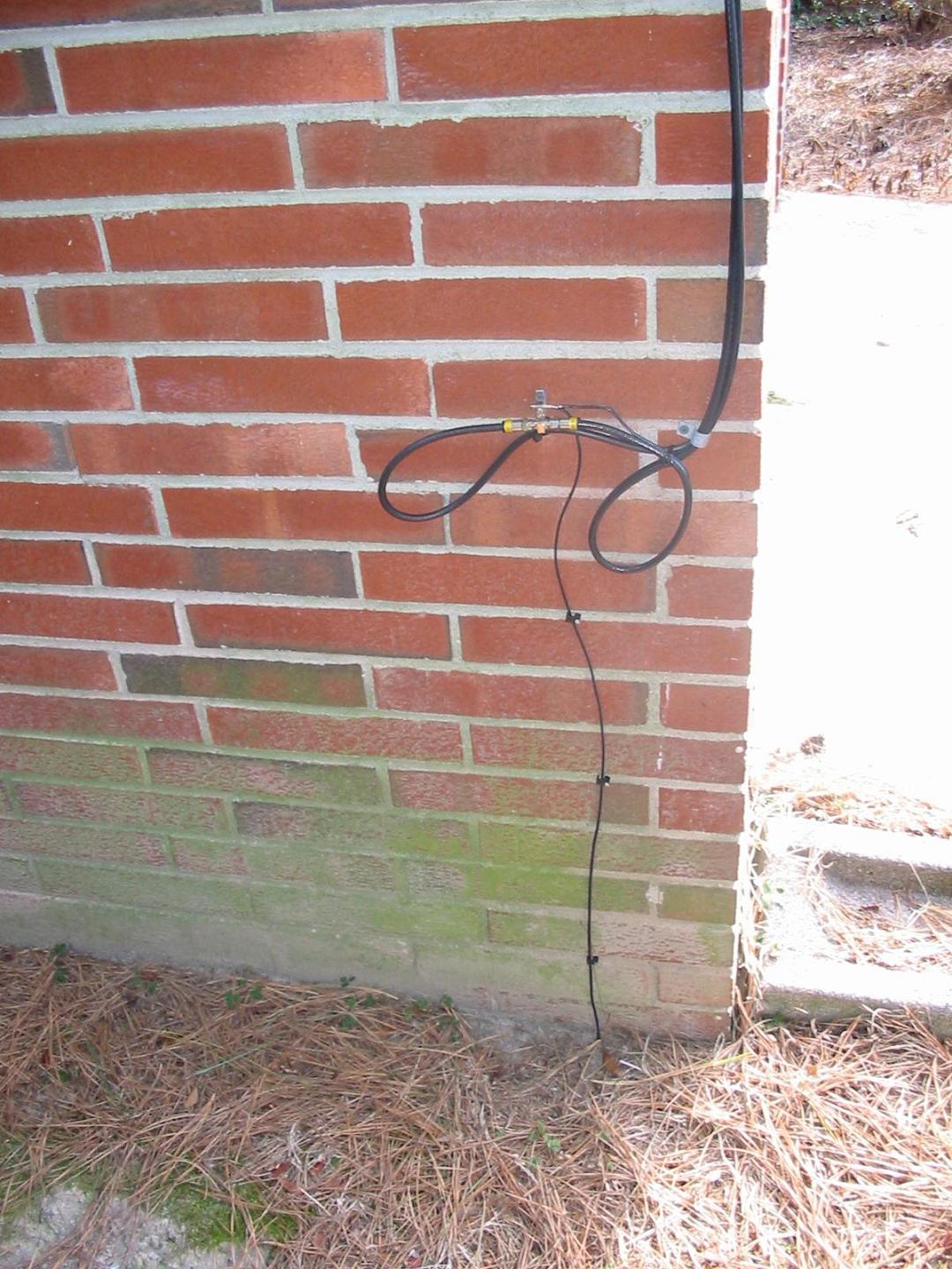

I've also attached all the pictures that I took this morning. You will notice what I'm talking about when I said that the bracket is not flush with the roof. I also noticed that the old diplexer (Channel Master Model 4032IFD) is still connected to the old antenna. The new antenna has a different diplexer that looks more like a splitter. Does anyone know if that makes a difference?

Rudy,
I just foward you picture on to the regional manger he will send them to you feild Manger in your area as soon as he get them. also just leave it the way it is cause if you bother it the installer will say he didn't leave it that way
the reason for the 2 diplexer is that the upgraded antenna will not work though the black on and i am surprised the old anteena did them are surpose to be for the stealth antenna not the sensor II i will let you know if i here anything.
