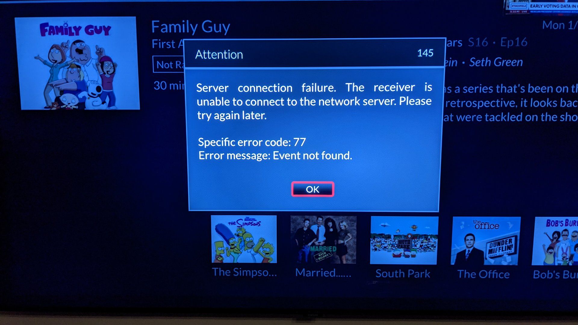

On the last one I deleted it gave me this error message.
I don't know if they are actually deleted or if they are just removed from the list. But they're not showing up in the on demand folder.
