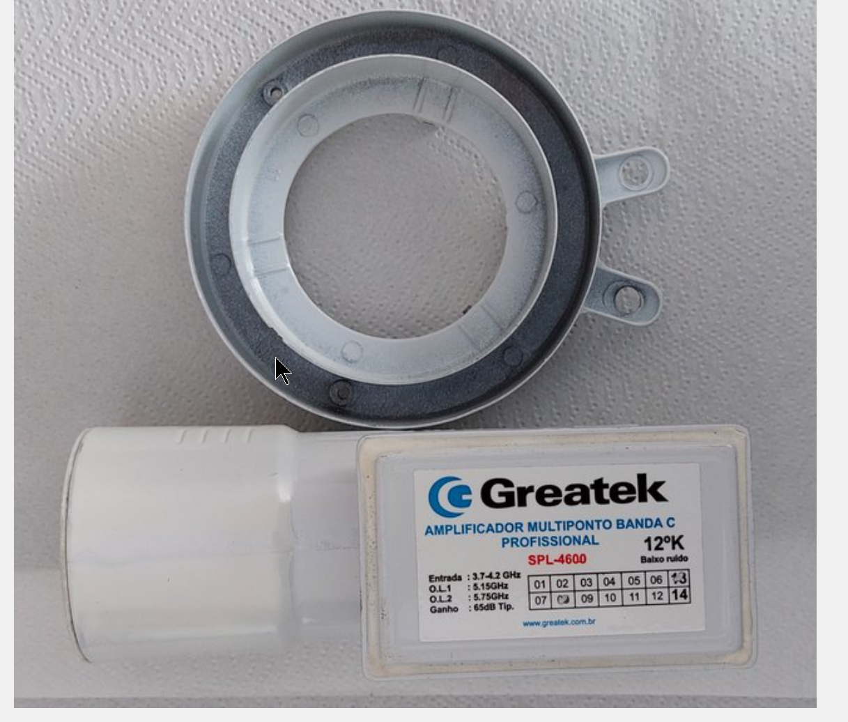

I wanted to ask about an LNB C band
this lnb has 2 values of O.L. what is the reason for these 2 values?
1 for vertical tp
1 for horizontal tp
then we read that it starts from 3.6 ghz inside there is a filter that cuts the signals of the wimax?

I thank you so much
so on the decoder or TBS I have to memorize 2 satellites (even if it is always the same satellite)
1 with O.L xxx
1 with O.L. yyy
in your opinion in this LNB is installed a filter x the vimax?
since it has a frequency range of 3.6-4.2?

ok, maybe the question is wrong
I repeat, in your opinion, the model in the photo greatek spl 4600 has the filter that cuts the frequencies below 3600 ghz?

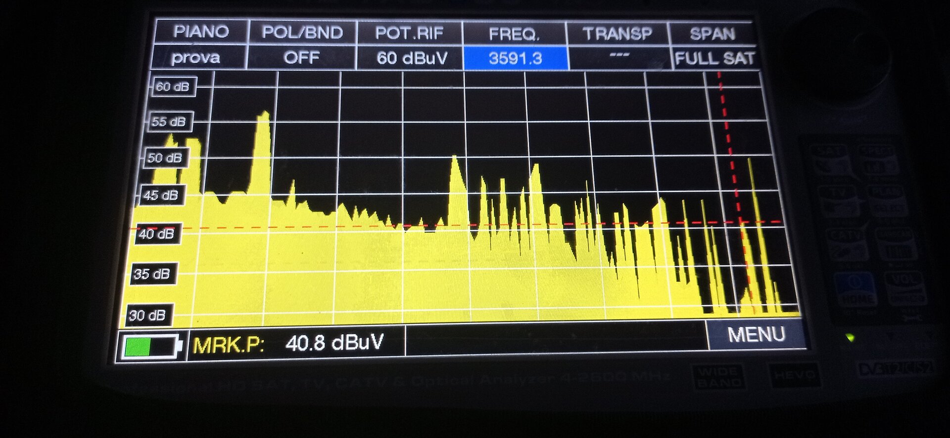

The giftbox would suggest that it has terrestrial interference filtering. Connect a spectrum display to determine if the signals below 3700MHz are attenuated. Do you know the frequency and source of the interference that you are attempting to attenuate?

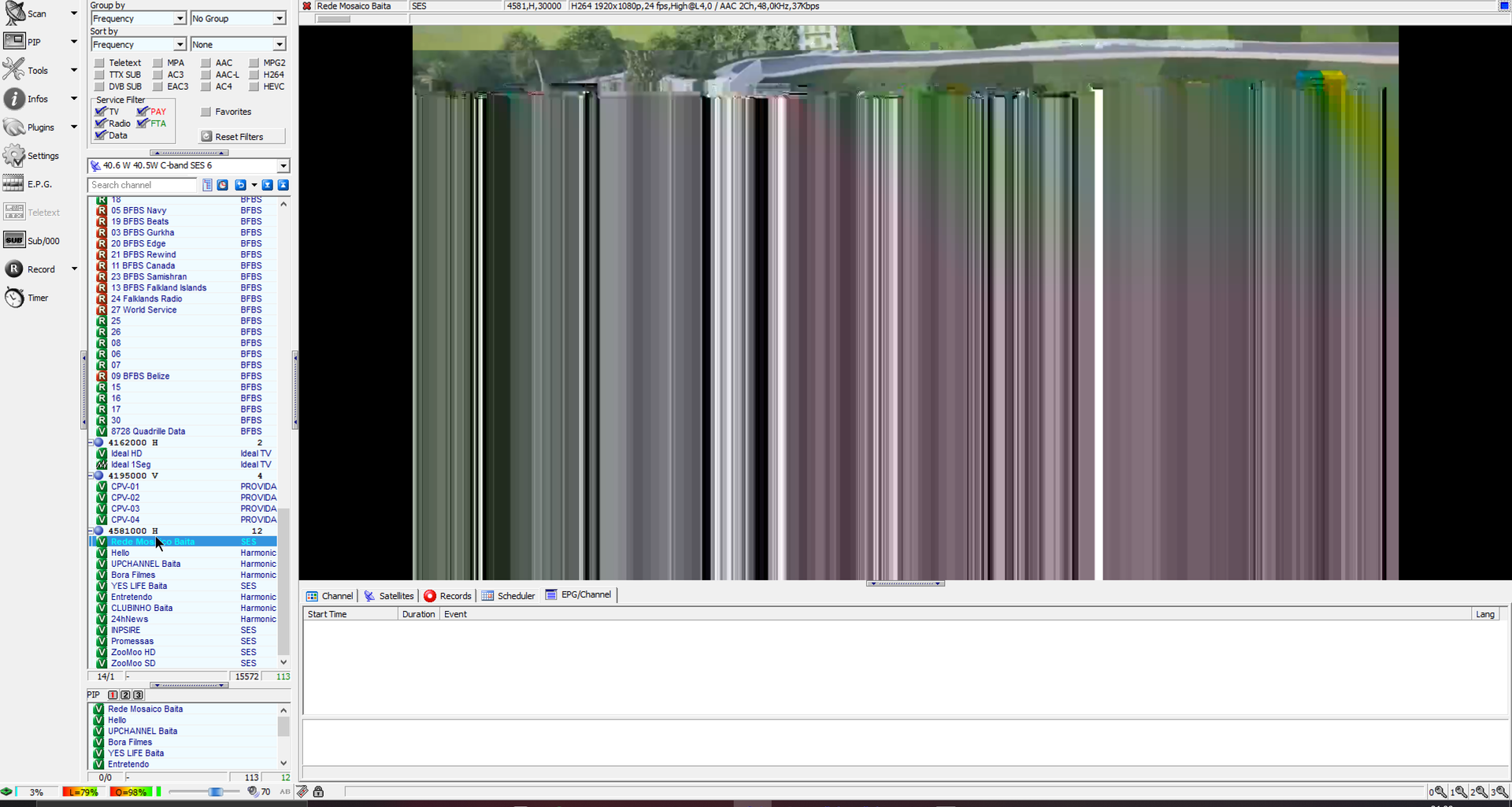

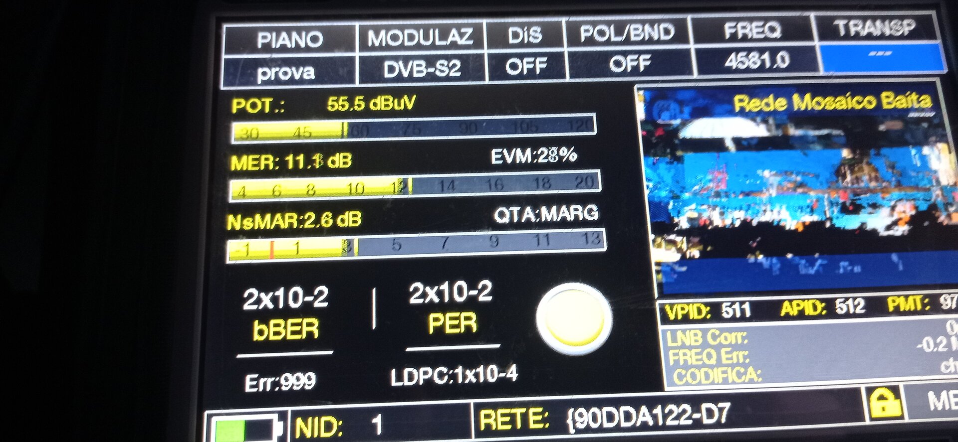

unfortunately the signals of the wimax pass the same and they give me pronlemi of vision of the images
even if the signal is good

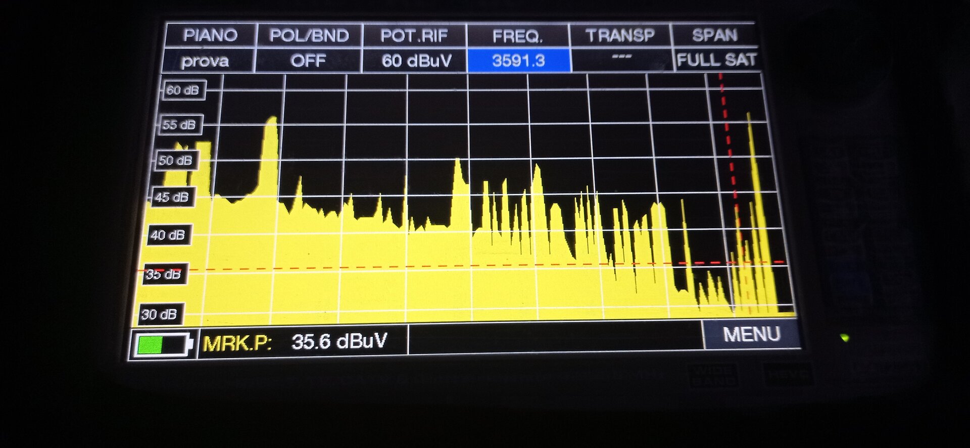

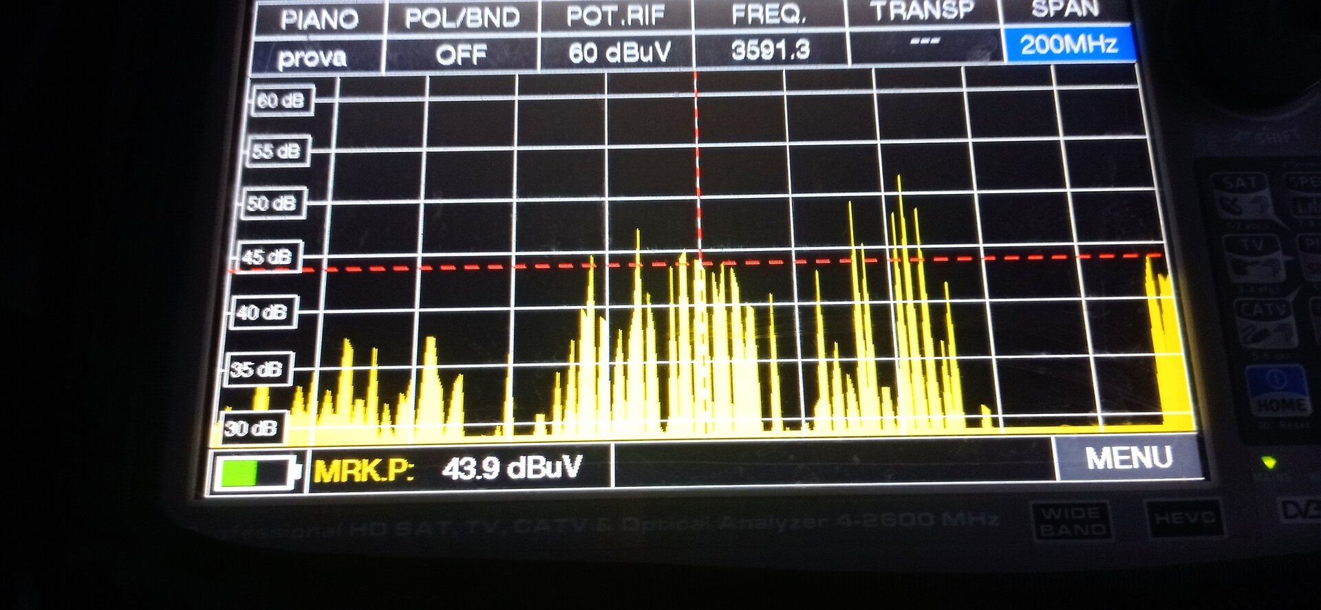

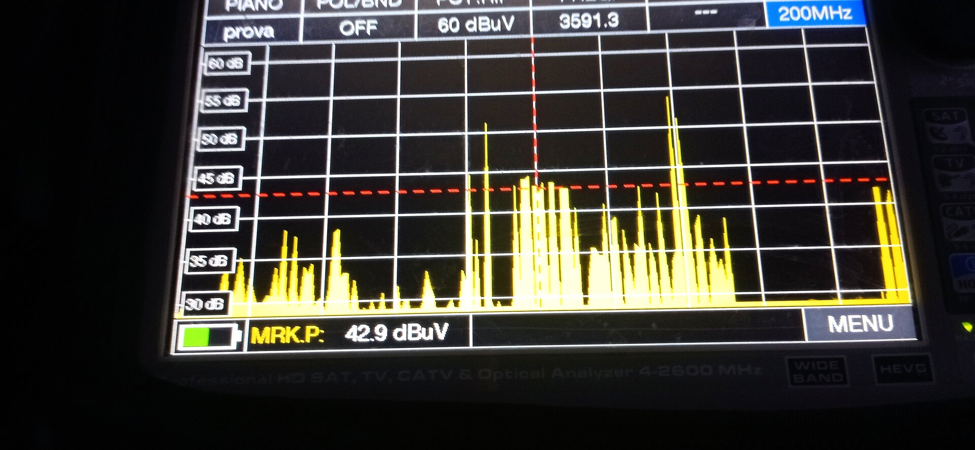

the wimax signals here from me soto from 3.4 to 3.6 ghz
in the photos you can clearly see the powerful signal of the wimax
