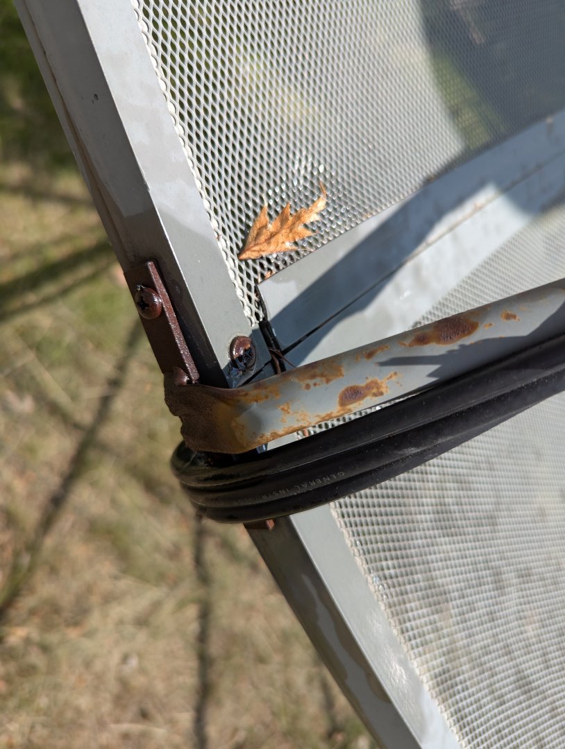

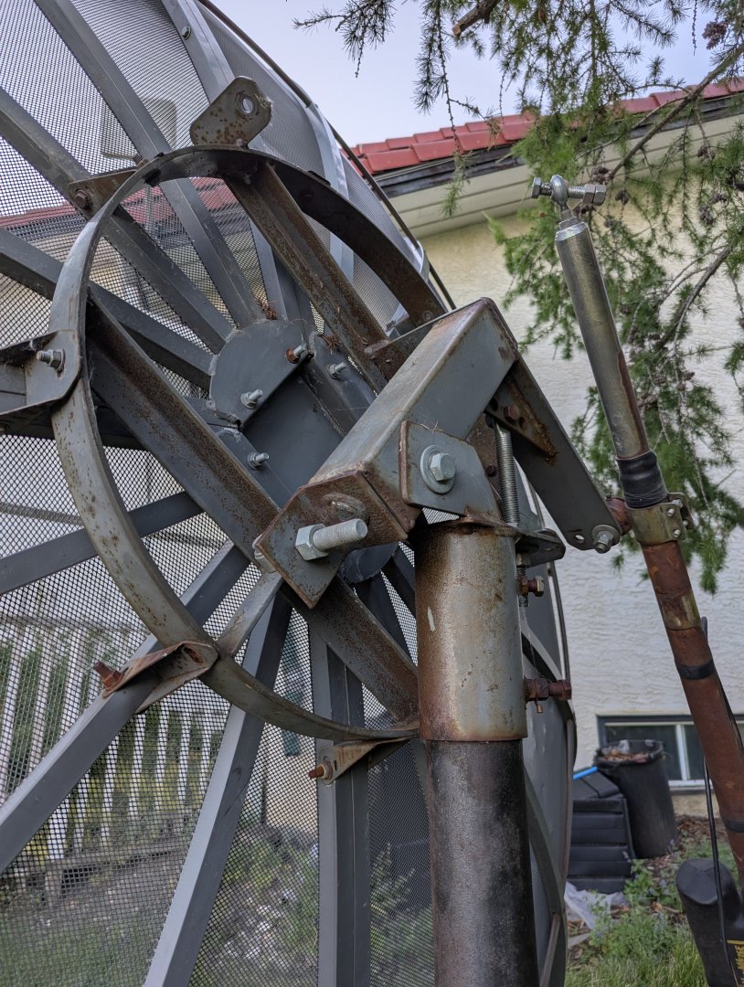

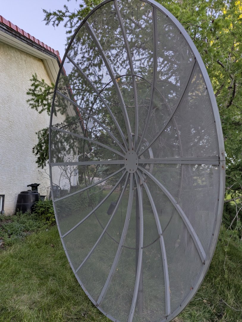

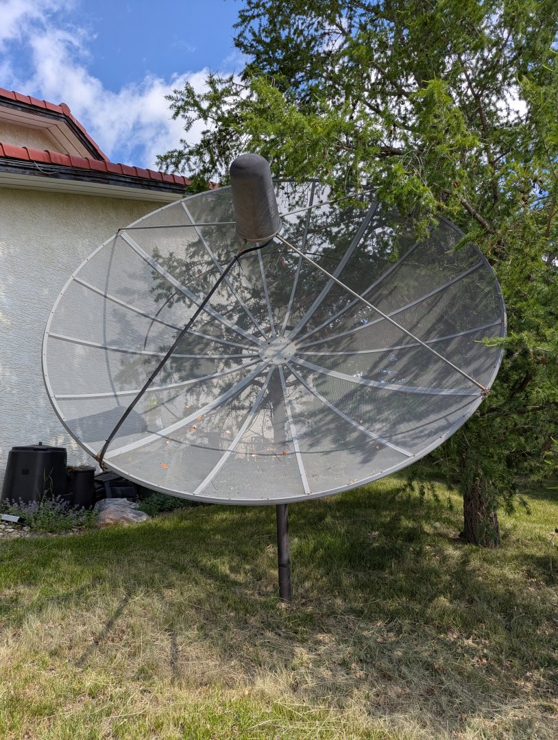

This dish measures about just over 10 feet from edge to edge. The top feed cover reads UNIMESH. There are no other markings on any other parts. The top feed contained a Chapparal LNB in effectively unweathered condition. The reflector ribs look like a Uni but the mesh is gray instead of black. Also, the feed legs attach to the outer edge and use screws rather than 1/4" bolts. The pivot assembly looks like a Unimount 10 H-H but the mount ring and the 8 reflector attachments points look close but not identical to the diagrams in the Unimesh installation manual I was able to find. The linear actuator is a Von Weise. Overall, this kit is in excellent shape for 30+ years of age. There are only a few minor dimples in the mesh and I was able to break torque easily on all of the fasteners except for one. This "feels" like it would have been an expensive installation back in the day. Only a bit of TLC and some paint touch-ups appear required. The Von Weise will get some basic inspection and attempts to re-energize, but it may be easier and more time-efficient to purchase a new actuator and positioner together.

I think that's a "Perfect 10" dish. GREAT dish if dialed in correctly! I have one in my shed. I uploaded all the drawings and installation instructions to this site years ago.
It sure looks similar to my Perfect dish if you check the photos. The instruction manual and design are good and practical. Maybe this site was the source for the manual I have on my PC.

Nice dish, and it looks like there isn't any torn mesh or hail damage. I don't think I have ever seen a grey Parabolics East dish before. I immediately thought it was a Winegard quadstar. As an added bonus you got a nice VW actuator with the 8 magnet wheel.

I also thought for a minute that it was a Quadstar - looks very similar to mine but the mount is a bit different and the round tube that serves as intermediate ring is much closer to the rim on the Quadstar.
It does seem to be a very nicely built dish and in great condition!
