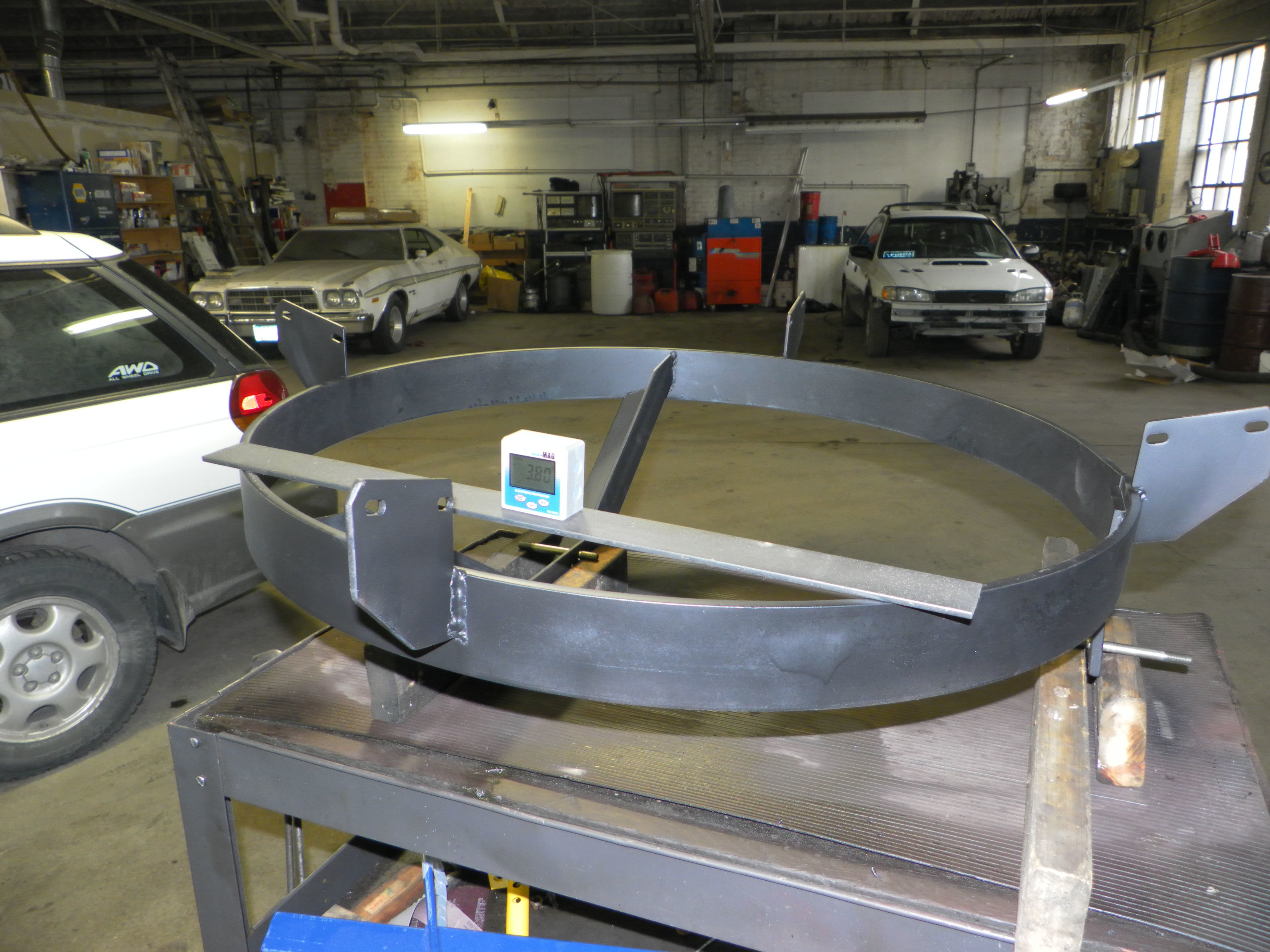

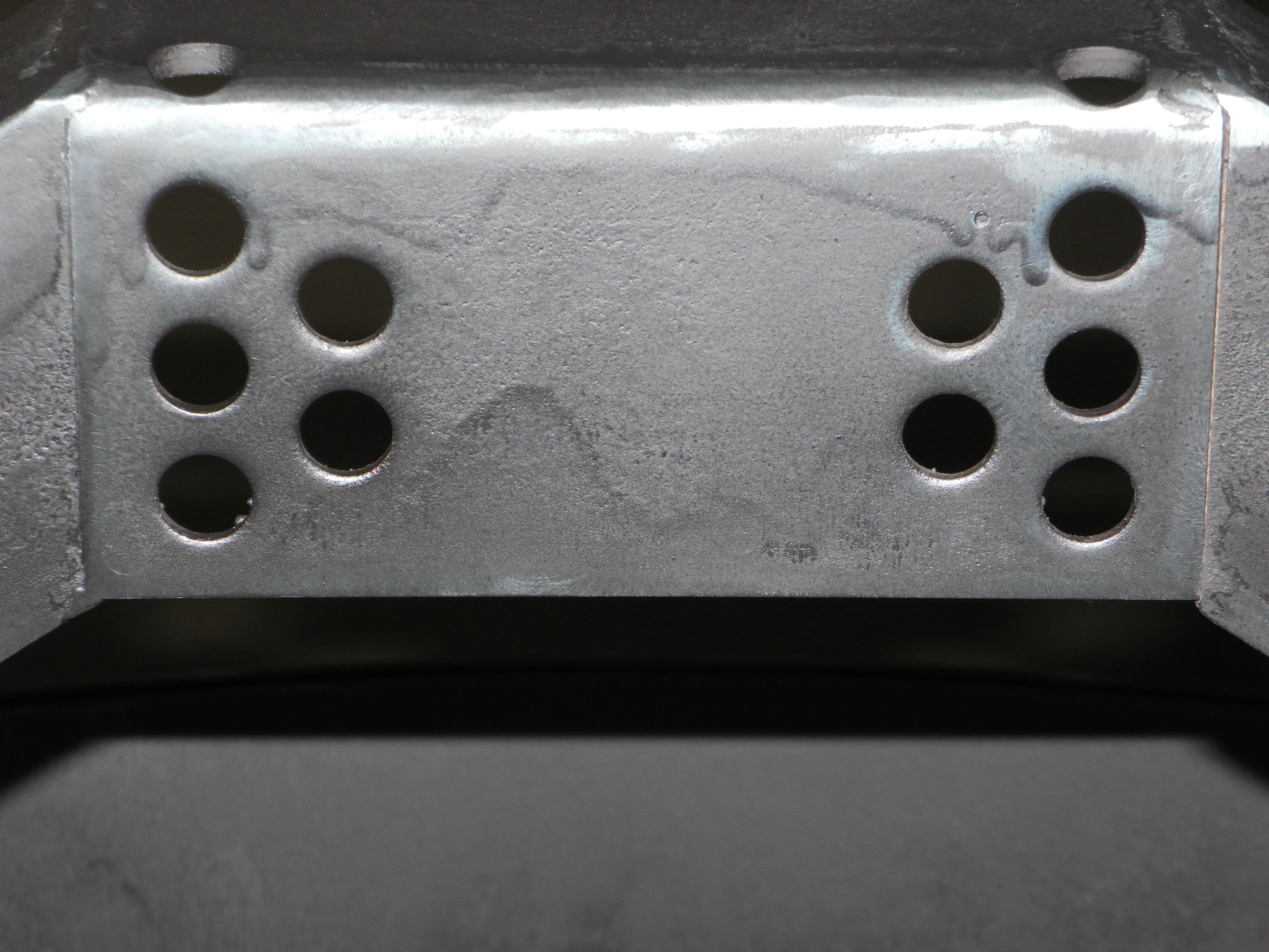

Some pictures of the ring that belongs on that. The holes are for setting declination 4°~8° . Those match up to the top of the AJAK mount.

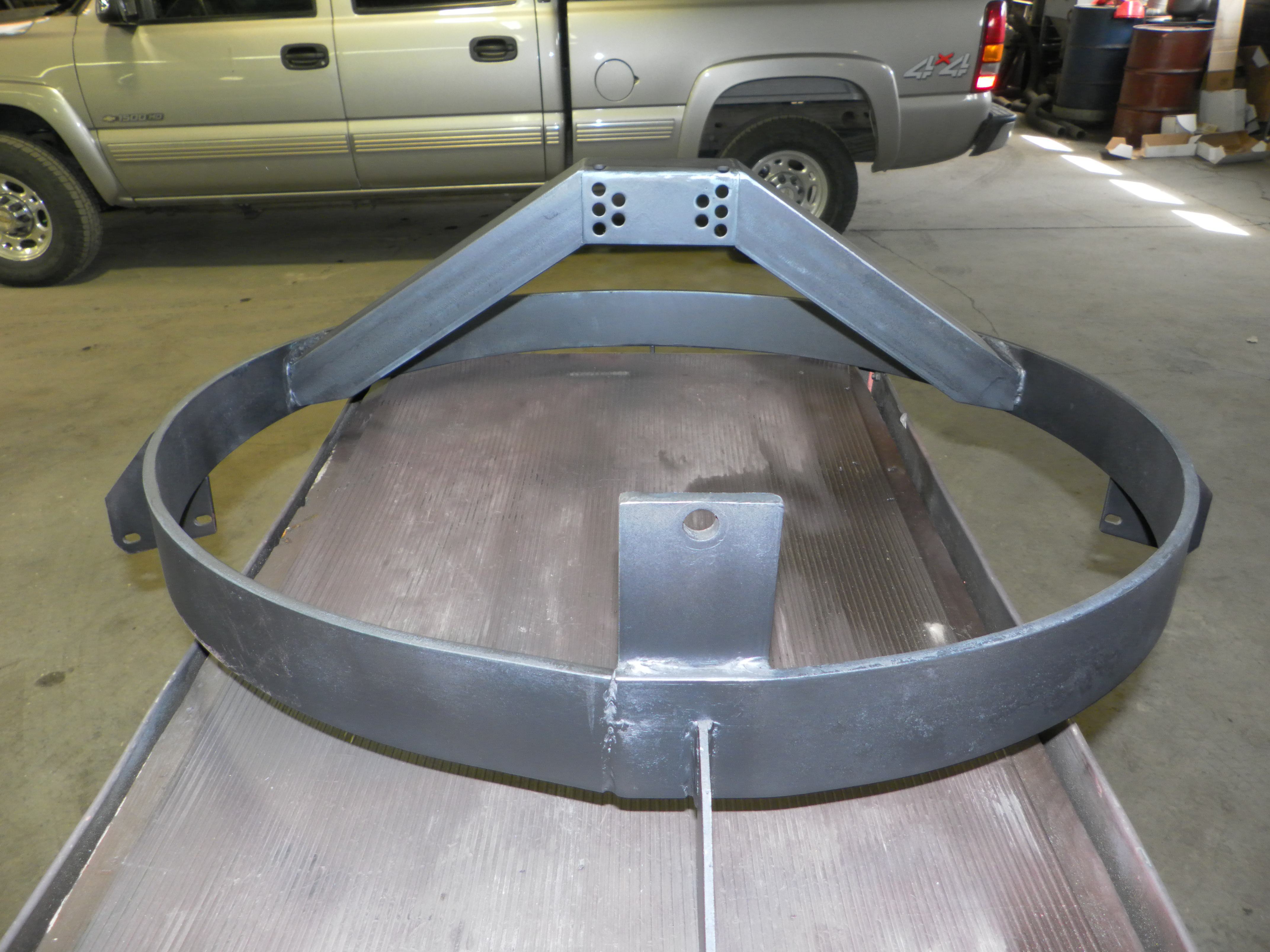

I would take the Proform ring and weld the tab on the bottom for the lower polar mount and then take angle iron and create the top mounting crossbar with the declination holes. When supported by the mounting holes in picture three, you can read the different declination adjustments. So now you have an angle to help you place the angle iron into the round ring correctly. Picture three shows the ring supported by the 4° holes. the angle finder is reading 3.8°
I have another AJAK with the same basic ring but different dish attaching points.
