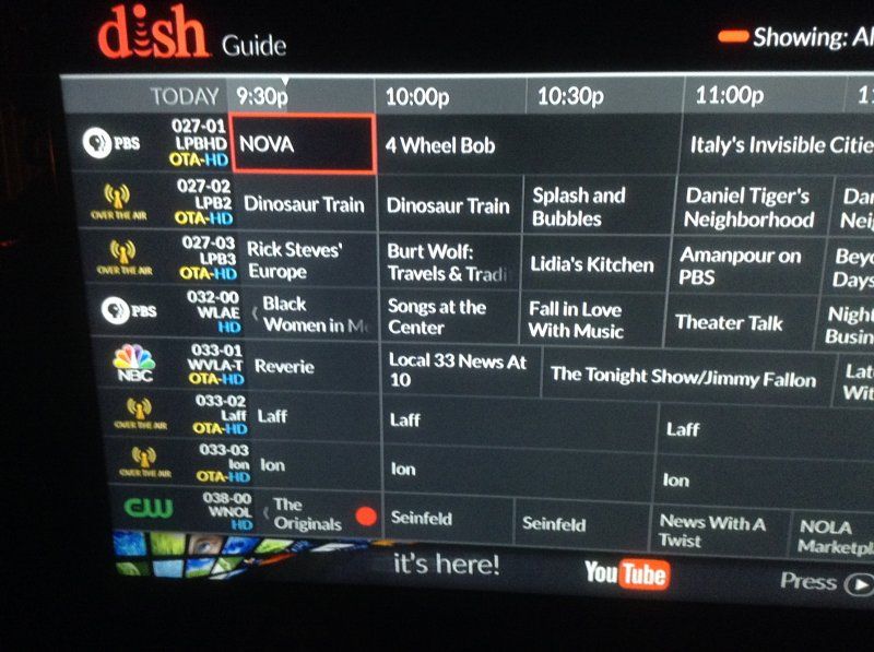

View attachment 134059 Dish can display more than one subchannel per number as I have a few sub channels per channel displaying on my hopper with sling. Try a rescan or wait til tomorrow and then rescan.

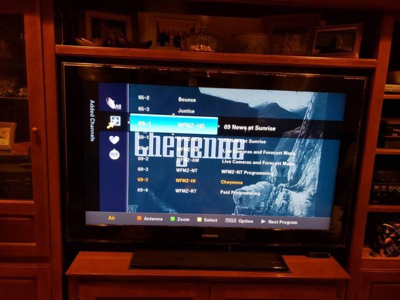

In your picture I don't see my situation. On my TV I have these 2 with the first one showing the place cards.
069-03 WFMZ-NT
069-03 WFMZ-HI
On the Hopper OTA scan, only the first one is found.

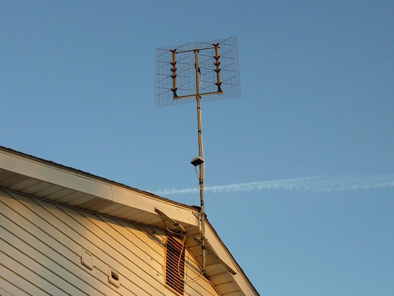

In the spirit of full disclosure you can read my signature below for a list of hardware I'm using. When it comes to TV antennas, bigger is better and a mast-mount pre-amp is a big plus. I recently rescanned and locked 73 channels off the antenna.
