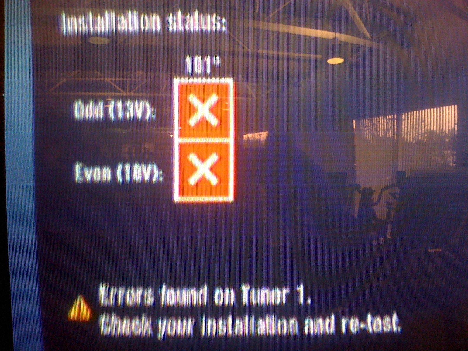

UPDATE: I forced the SW DL. It's working now. It still shows an error during the sat setup test. But, it gets EPG and programming OK now.
what is the ERROR code and then call in and see if you can get the error code translated...
if its code 0003.. PM me and i will tell you a way around it

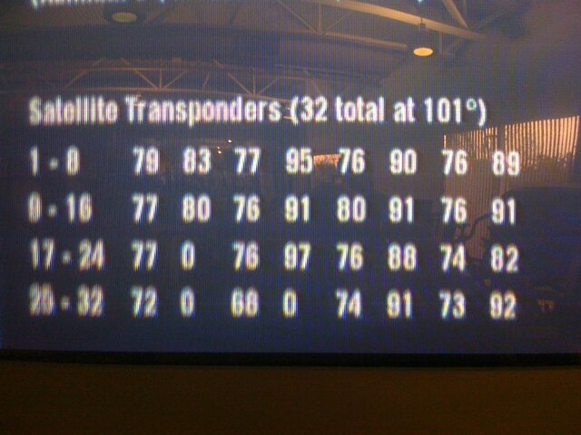

are you getting good signal? it has to hit 85% or better to pass... if it falls beneath that, it will say fail. make sure all fittings are tight on the lnbs. its possible you got a bad LNB.. but not likely.
are there diplexers? splitters? in the line to the reciever? lot of questons need to be answered.

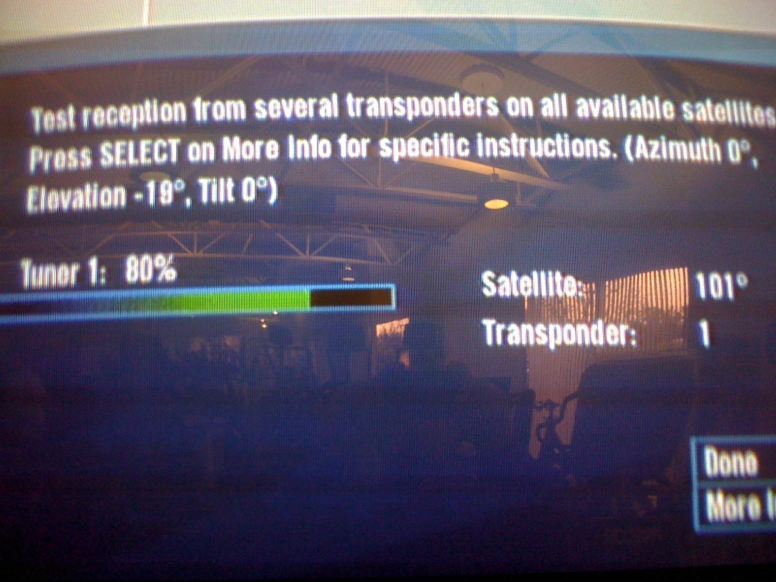

Thanks. The jpg above shows the error screen. I've also attached jpgs of the signal screens below. I thought I posted information that answers your other questions in my earlier posts:
-single LNB 18" dish
-multiswitch
-older SD receivers work fine with existing dish/switch
That's it. I'm not sure what other questions need to be answered.
The bottom line, though, is that I am receiving programming OK now, despite it failing the system test. I guess the new SW did it.
Wow. That's low? In E* world, that would be considered outstanding.:eek:
We've never had any dropouts, even in the rain. So, I guess those levels have been ok for the old Sony receivers. I'll make sure to tweak for higher numbers when we replace our dish with a slimline when we upgrade to HD.
My 101 numbers, except for the few spotbeams there are 96 or higher on all my H21's and HR2X's so yes you should see if you can peak that dish a bit better.
