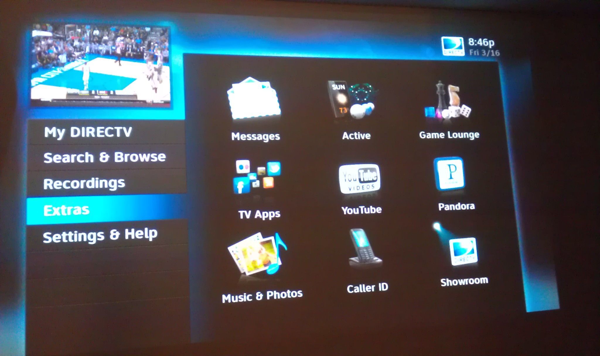

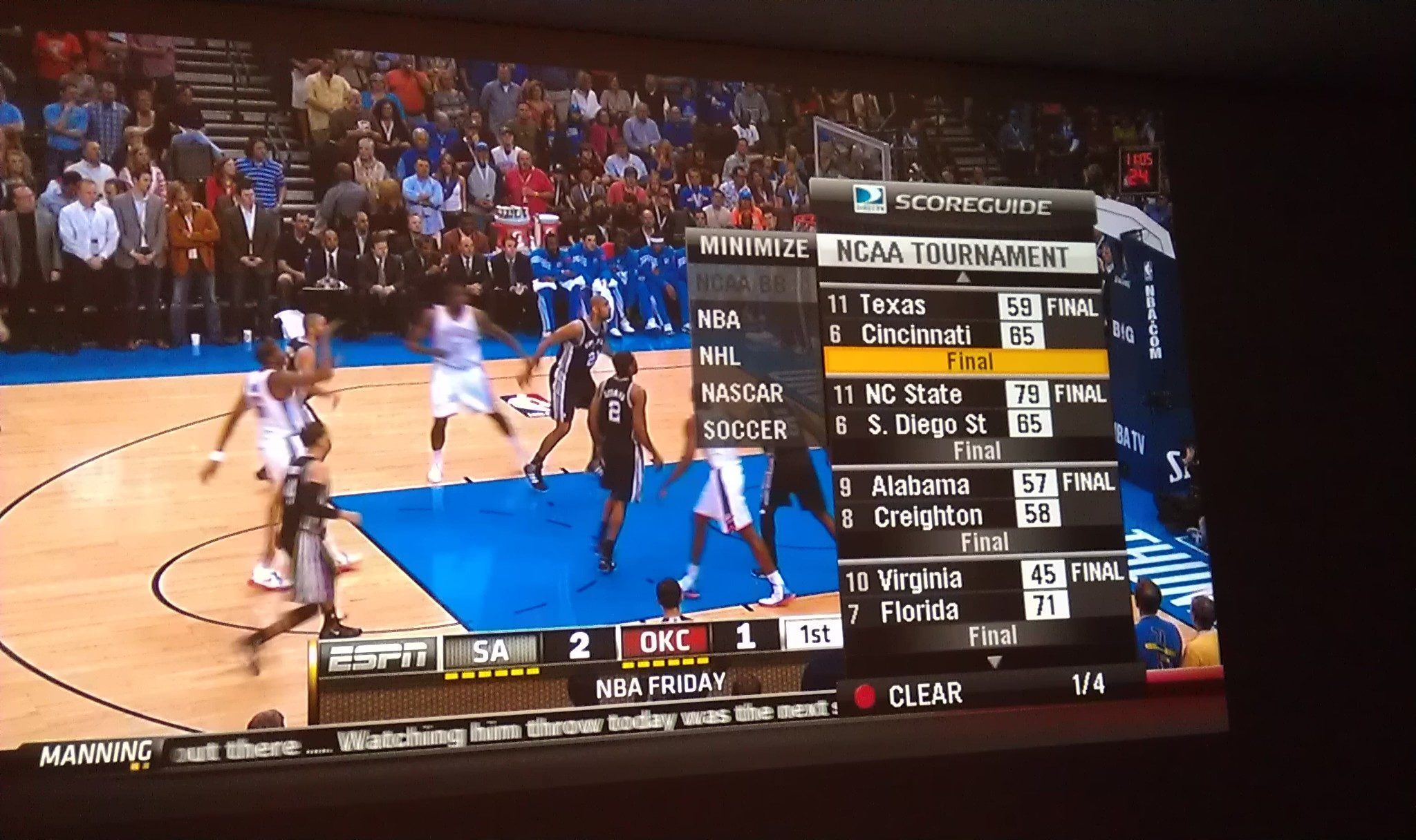

Not that you ever doubt me (LOL), but here are all those working for my unit on the current CE version.
Thats just it Charper,
On my older HR24-500, it's all there, but the one I installed last Friday, it not working at all.
SG gone, no My D*, Pandora or Youtube ...
