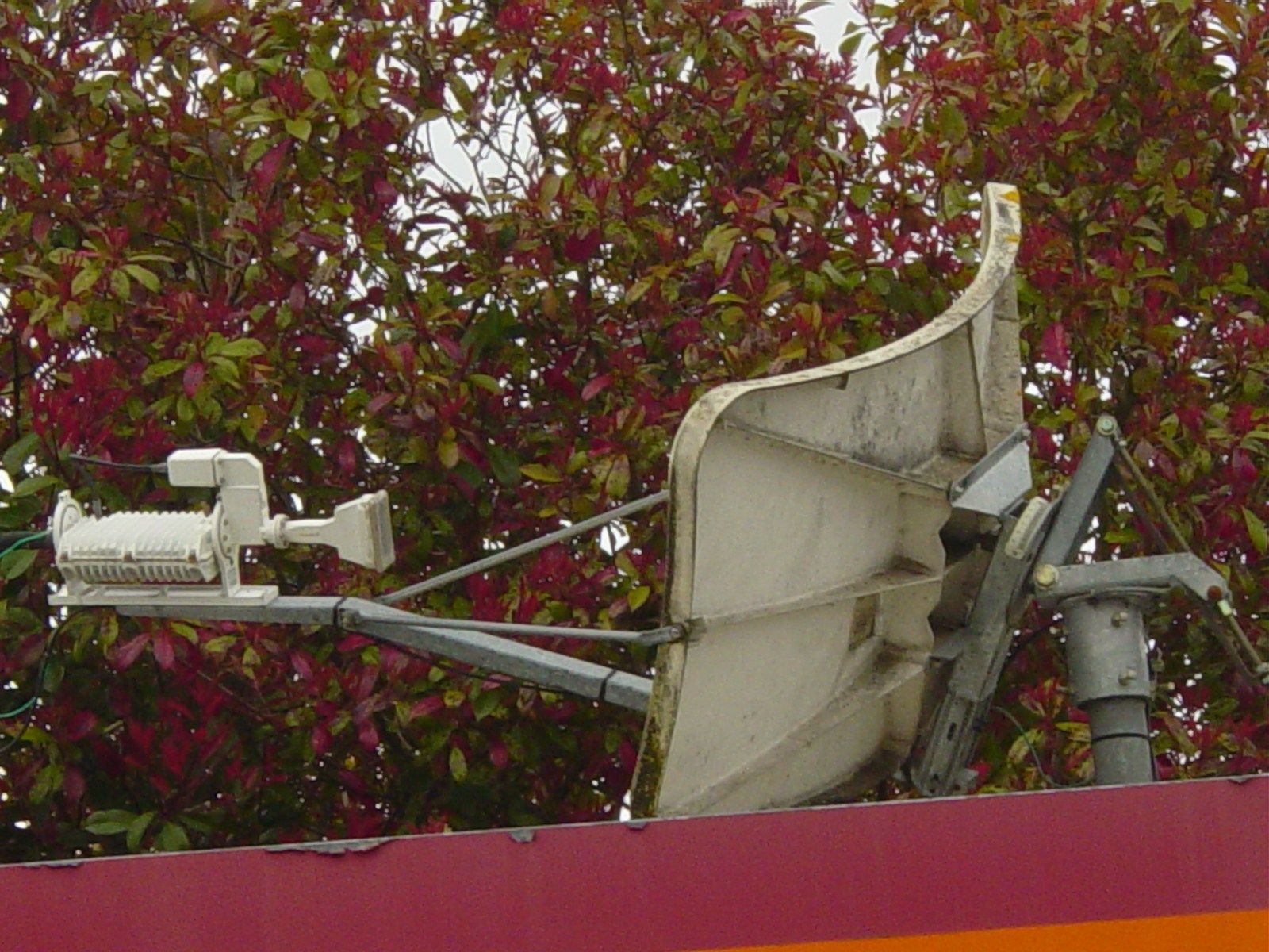

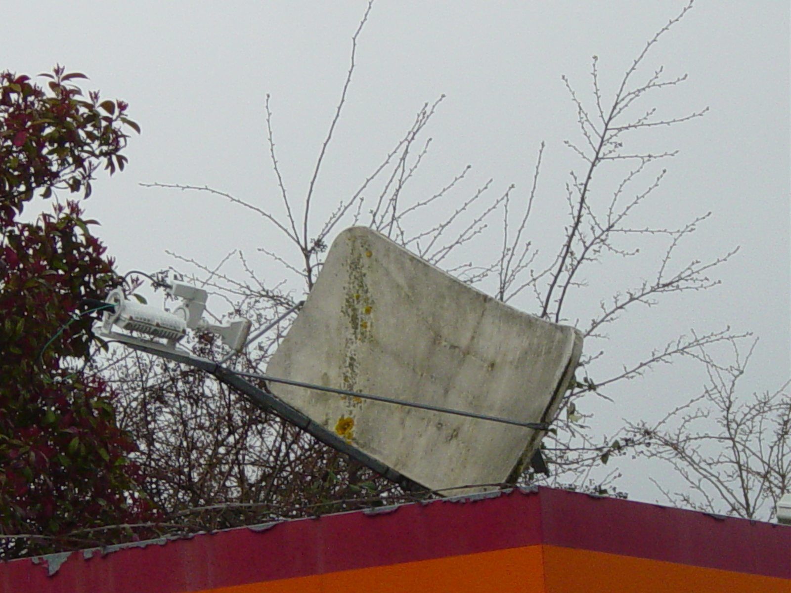

This thread reminded me of an oddball dish I frequently pass while driving around, so I tossed the camera in the truck and stopped when I passed it this morning. It sits atop a small utility building in a Pacific Pride station near my home. It's likely their data link authorizing access cards and so forth.
Around these parts, a skew like that and such a low angle off the horizon would mean it's pointed at a bird over the east coast. 72W or 83W, maybe. You can get a sense of what Brian said about a corner of the dish rising tall when swung to an extreme. The dish itself has obviously been there quite a while, what, with all the environmental filth and moss growing on it, but the feedhorn and LNB look fairly new and well maintained. The shape evokes what Lone Cloud says about cutting off the top and bottom of a dish to get the desired height.
Anyway, I guess the point is someone actually commercially made "half a dish", and there are feedhorns designed for such. Other than the pictures, I don't have any more information. Maybe someone here will recognize something about it.
