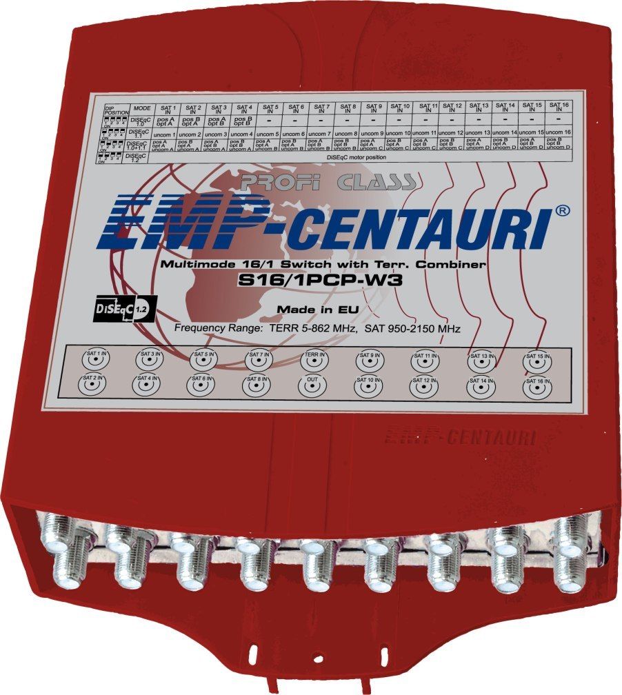

I'm out of space on my 8-way DiSEqC switch. To avoid complicating my system, I went searching for a bigger switch and ran across this on EBay. Not being familiar with the brand, and the fact it's made in the EU, I'd like to run it up the flagpole and see what you guys think.
When looking at the power consumption, I'm a little concerned since my receiver's power supply is rated at 400mA Max. I don't want to create a problem by overloading my receiver's power supply, and the fact I'm not up on cascading switches. I figured it would simplify my installation if this one will work.
s-l1600.jpg About $52.00 with shipping.
This product allows connection of 16LNBs to one satellite receiver !!
17in/1out DiSEqC 1.0&1.1&1.2 switch for up to 16 satellite positions and 1 subscriber, equipped with combiner for terrestrial band. It is designed for switching between 9 to 16 LNBs. Control mode is configured using built-in DIP switch, see Instruction manual for details.
The product allows joining terrestrial band to common down lead.
HDTV and UHDTV compatible

I just ordered its 8-port sister the other day. According to a33 those are reputable switches. Looks like the projected 5 dB loss is the same as the 8-port model.
Reactions: wvman
I have not used that particular one, but have used their switches. They make good stuff!
If only one LNBF is active at a time you are fine at 80 mills.
5db loss is horrible. That's a 68.4% reduction of signal level.
I don't think it literally equates to a 68.4% loss of signal QUALITY, though. My current Pansat 4x1 has a 3 dB loss and I notice virtually no difference going straight to the receiver or through the switch.

I was thinking that since I don't use a 22Khz tone, I should be fine, but wanted to make sure. Right now I'm using a Pansat PNSW81 with a 3db insertion loss. Wouldn't the insertion loss be higher cascading two of the PNSW81 switches than using one of the 16 port switches? :)
