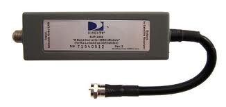

Like the kitty said, if you are only running one line, you don't need a swm setup, but you will need a bbc inline. They look like this:
