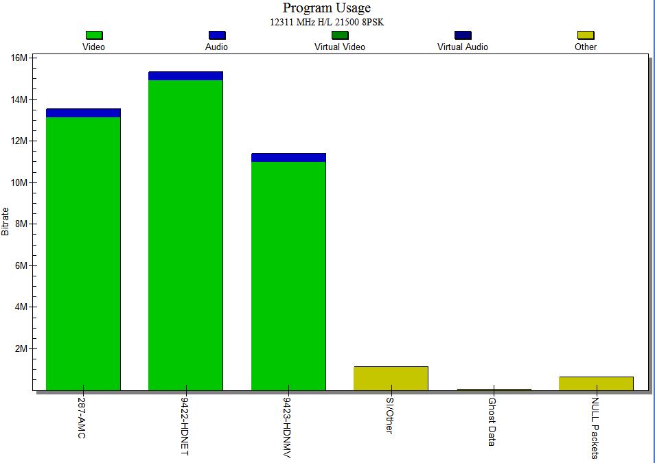

Yes, I have the same Dead Like Me Episode from HDNET as well - back before they reduced the bitrate and resolutoin of the channel. Try it now and see what you get. Posting figures from a cap done last July doesn't relate to today.
Yep. Attached file shows statistics from a capture taken within the last hour on HDNet. 1440x1080i, like all of my recent recordings of HDNet.
And yet with all these figures you still fail to realize that 26 Mbps that TSReader is reporting for NBC OTA is higher than the 19.39Mbps that ATSC is capable of or the 15.00Mbps the station is transmitting.

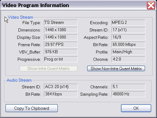

I was only trying to point out a bitrate of 14.5-16Mbps is enough for 1920x1080i and used the clip as an example.
----Close Encounters----
MPEG Video: Bitrate 65.000 Mbps Resolution 1440 x 1080i
MPEG Video: Framerate 29.97 fps Aspect Ratio 16:9 Chroma Format 4:2:0
shows a bitrate 12.5Mbps.
I read several times about hdnmv was 15-16Mbs at 1440x1080, that did make sense (to me) but 12.5Mbps hdnmv at 1440x1080 does.

Close Encounters 1440x1080 at 12.58 Mbps (Calculated multiplex rate: 12988529 bps) has a peak bitrate of 22.8Mbps. A 26Mbps VBR biterate would indeed be nice.
0x0000 (0.08% ~ 0.01 Mbps)
0x0000 MPEG-2 Program Assocation Table
0x0010 (0.04% ~ 0.01 Mbps)
0x0010 MPEG-2 PMT for program 1
0x0011 (96.76% - 12.58 Mbps)
0x0011 MPEG-2 Video for program 1
0x0014 (3.12% ~ 0.41 Mbps)

And you have proven again why TSREADER is faulty and gives high readings as the video is set in stone at 17.57Mbps CBR on their distribution.
Once again, this was choosen so HDNET and HDNET Movies would fit on 1 38.81 256QAM.
2 22Mbps channels will not fit.

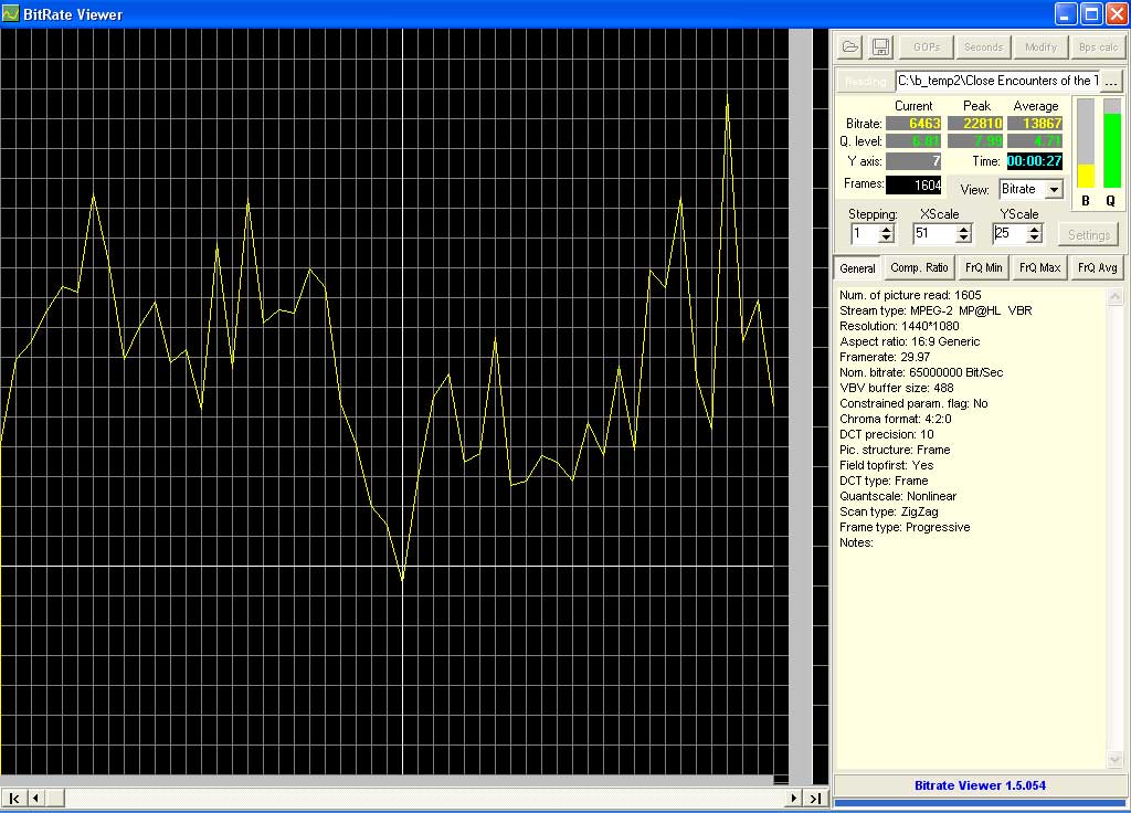

It's a little more complicated then that. Multiple MPEG-2 video streams from broadcasters are compressed at a variable bit rates (VBR) and these are multiplexed onto a single constant bit rate (CBR) stream. Statistical Multiplexing is a method of making the most efficient use of the bandwidth available for a given transponder, whilst maintaining a quality of service across all of the multiplexed channels. CBR stream with multiple MPEG VBR payload.
Never said it would. The clip 'Close Encounters of the Third Kind' from hdnmv viewed from a BitRate Viewer had a VBR peak of 22Mbps (very few frames of less than .1% of total length).

great - however there is a hard limit on HDNET and its not even in the 20s for 1 frame as I have tried to tell you.
HDNET uses the same bitrate for every frame in distribution - regardless of what it really contains.
That is why so many titles do not look as good as they should at 17.57Mbps.
If I record a cassette on a DVD, it will have take the full DVD Bitrate - but still sound like a cassette.
