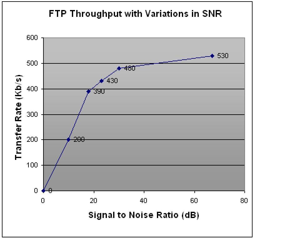

Here's a graph, too.
The signal meter on a Dish Network receiver does not represent the bit rate of the stream.
That's over IP NETWORK
Just did. Glad there is no dispute on the bit rate/PQ relationship.
FTP is File Transfer Protocol. We don't receive sat via WAN, LAN or Fiber and it doesn't use FTP to do it either. It might relate to the downloads we can get from E* over the net but not coming down thru sat.
