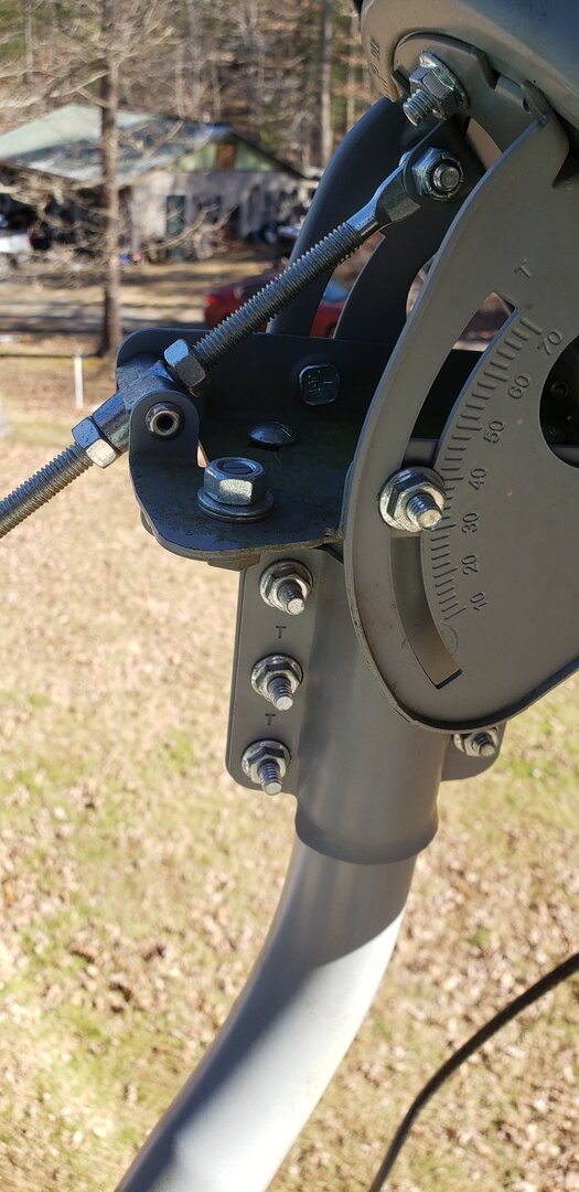

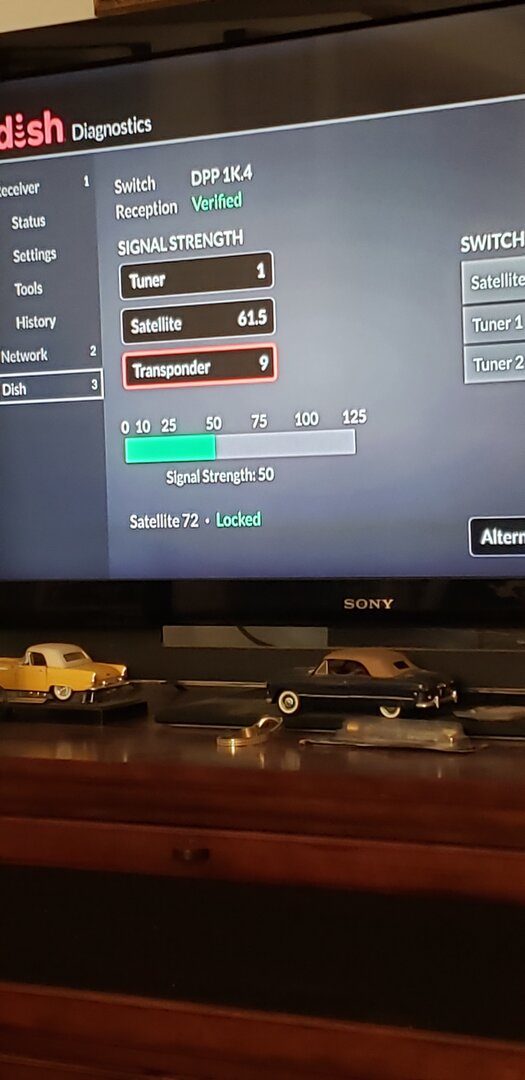

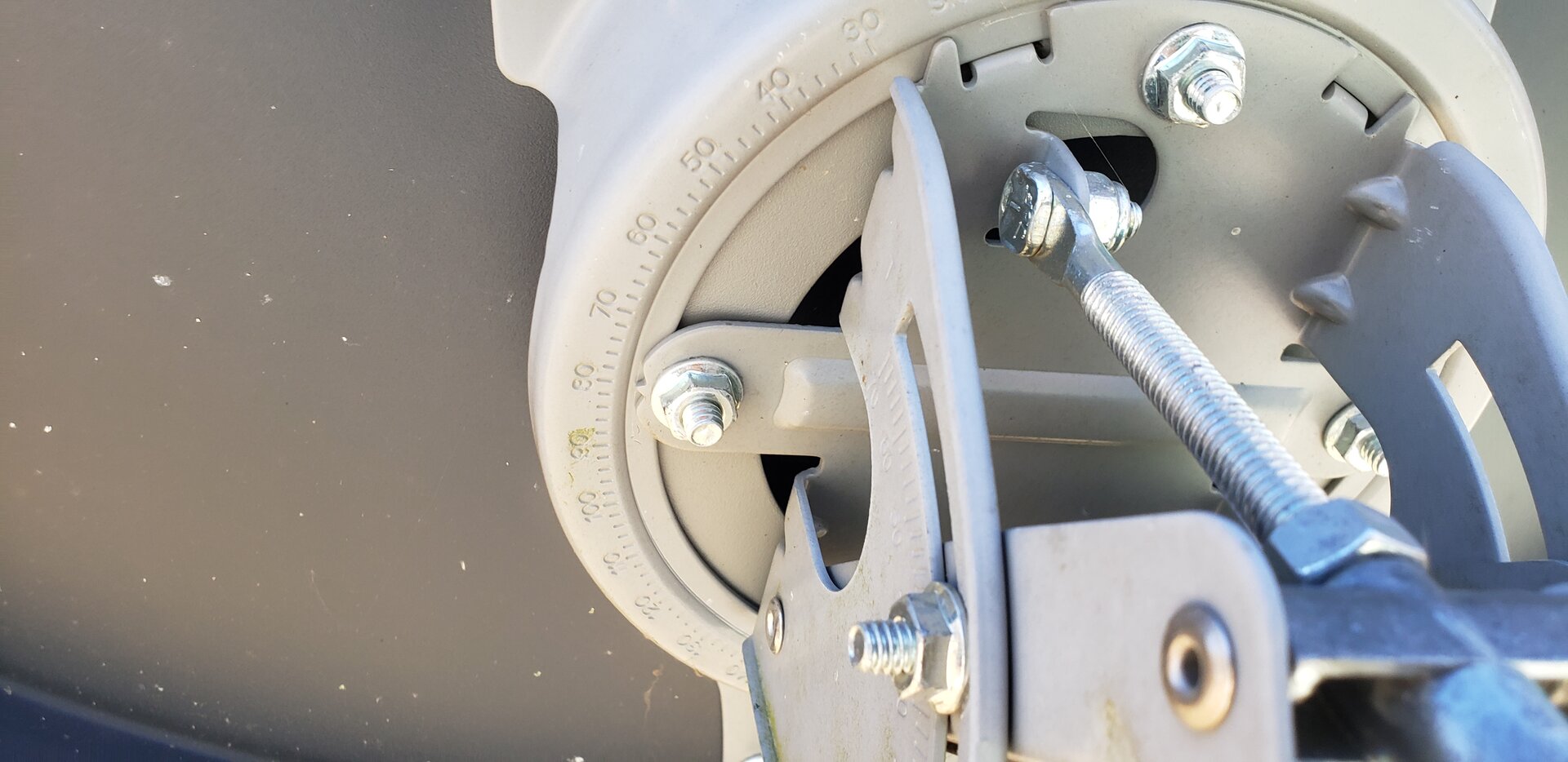

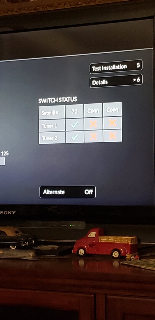

1000.4 manual dish mounted to side of out building.
New cable from dish to wally.
24941 zip,
Setting 175 azmatih 45 angle 80 skew
I had 60% on 72 but nothing on 61.5.
I had like 50 on 61.5 but had to move the dish to the left to get it and lost 72.
Can't seem to lock on both at the same time .
It has to be something small I am missing.

72 is being received on the incorrect LNBF. The settings you provided seem correct, so for that to happen your mast might not be plumb. The order for a EA 1000.4 is 77/72/61.5, and you are receiving in the order 72/X/X. Of course 77 is no longer a valid option, so you should aim to get 72 in the second slot for starters. As you have it now, you are aiming a few degrees too high and a few degrees to the South (or "Right" from the back of the dish). Try covering the first LNB with aluminum foil (the leftmost one of the two that are close together), lower the elevation by about 2 degrees, and then swing slowly to the SE (or "Left"). If that still doesn't work, make sure your mast is perfectly plumb and your dish is not warped or damaged.
Thank you,so the lnb that is far right by it self is the 61.5 land the right one of the pair is the 72?
