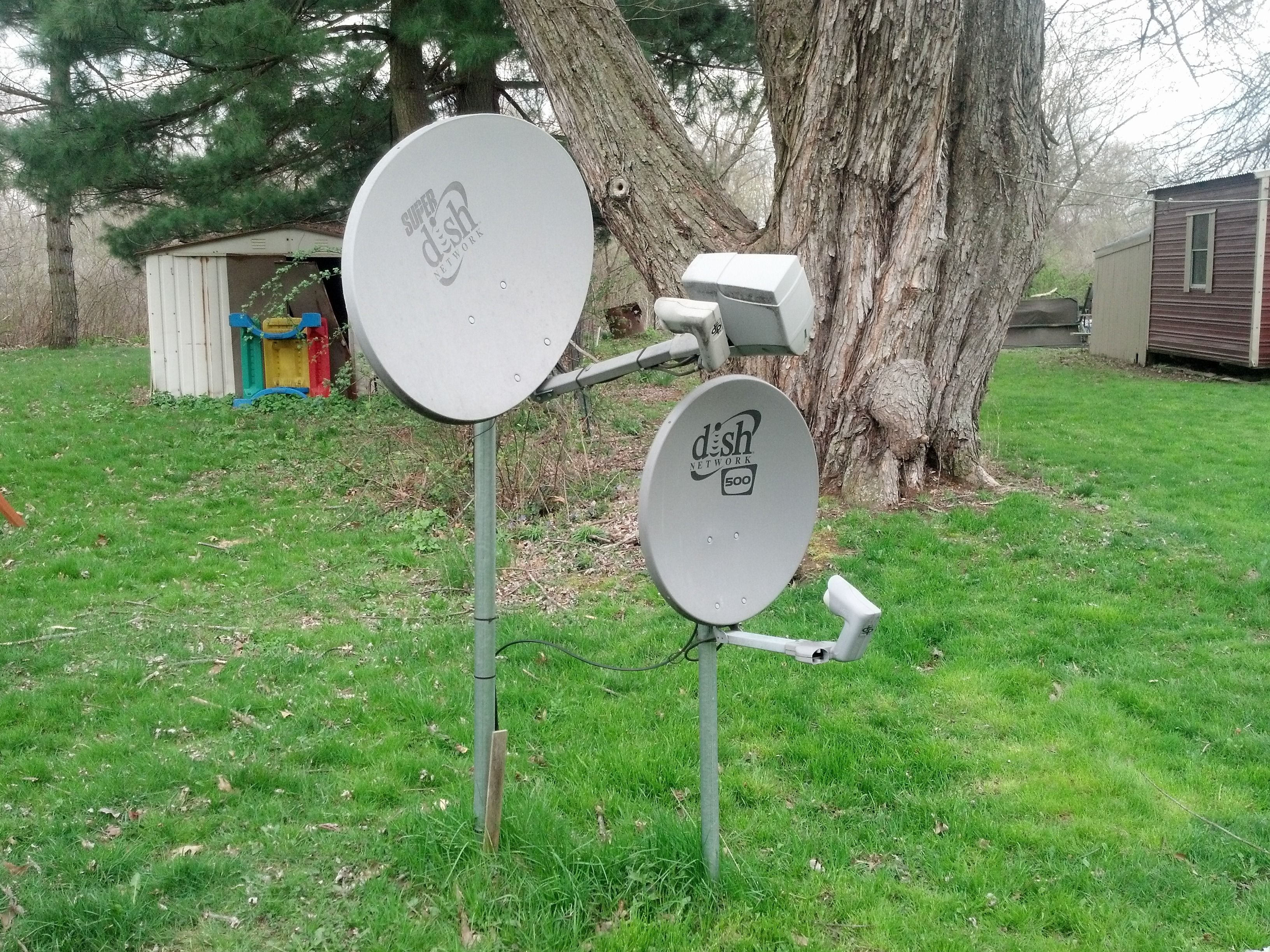

I think my super dish is the 110 & 119 and the 500 is single horn for 129.
Will this still work agentc13?
Find a new installer... If you have all three sats now, then it can be made to work.. Some Dish/Lnb changes may be needed, but it can be done. Find a local retailer if you can.
If your are in NE Ohio I would think there is a good chance your locals are on both arcs. What city do you get locals from? If it is Cleveland they are on both arcs.
Now how do I get Dish to install it? I could do it but Dish wont sent me the equipment.
You could buy the equipment online, or try contacting Dish (or if you have a reliable one in your area a Dish retailer). I am guessing that the DIRT members who check this site could probably help you out somehow.
I wouldn't try to use the Superdish (I'm an in-house Dish tech and they make us remove them on sight whenever we run into them). But you could get a 500 dish in it's place to get the 100/119. It doesn't seem like a difficult setup, how close are the two dishes that you have from each other?
That setup can be easily replaced with a 1k2 dish.
