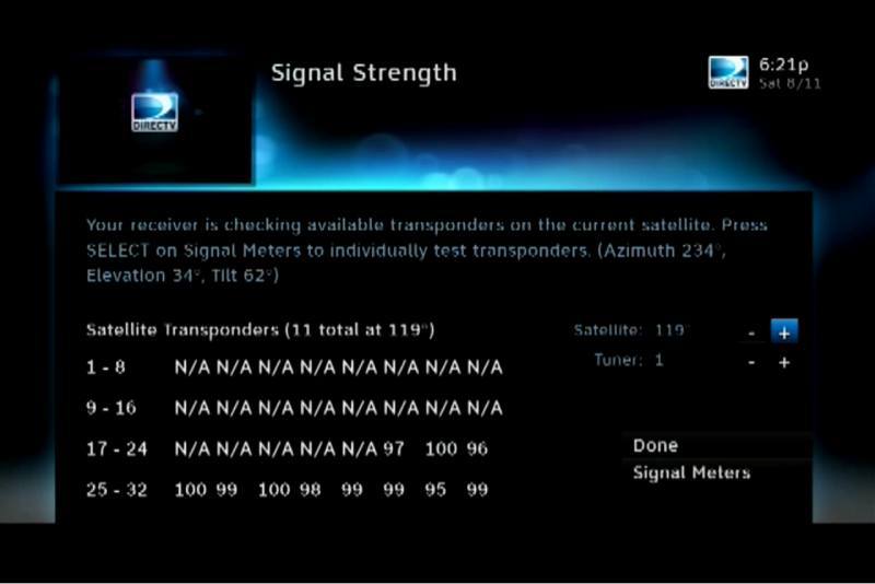

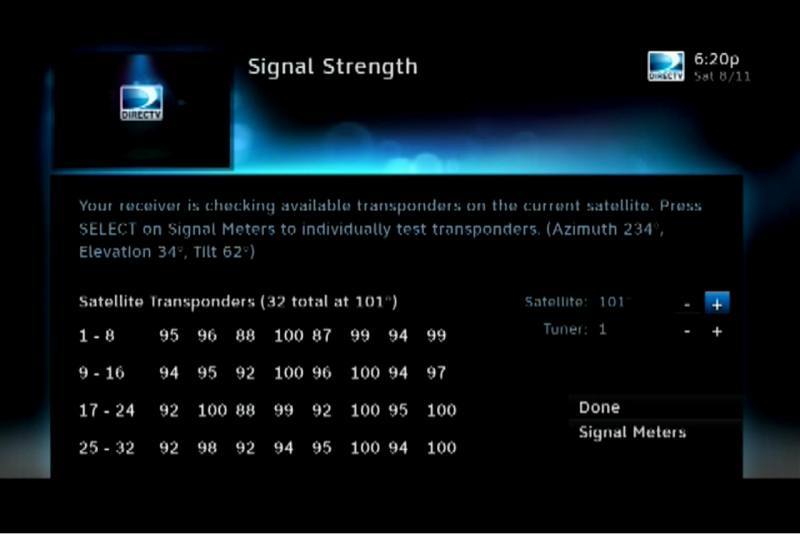

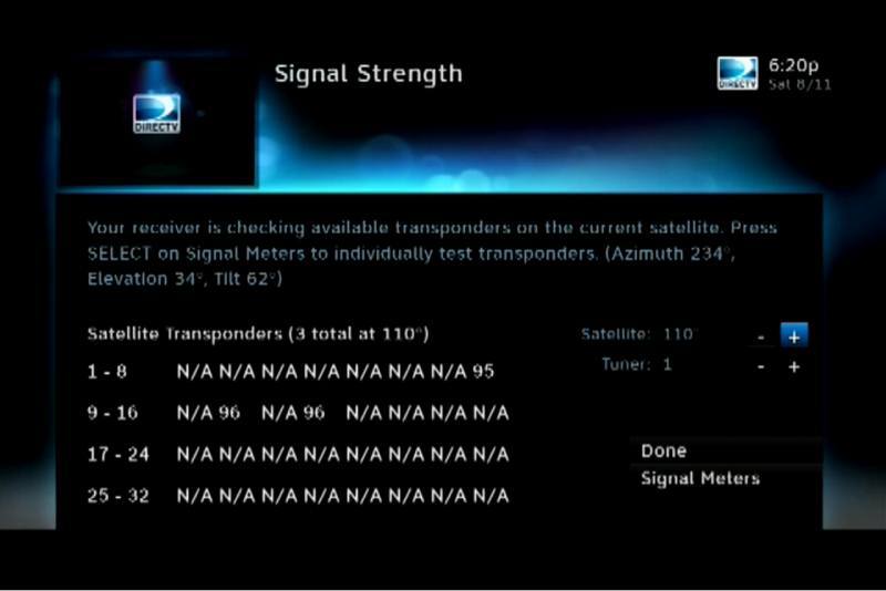

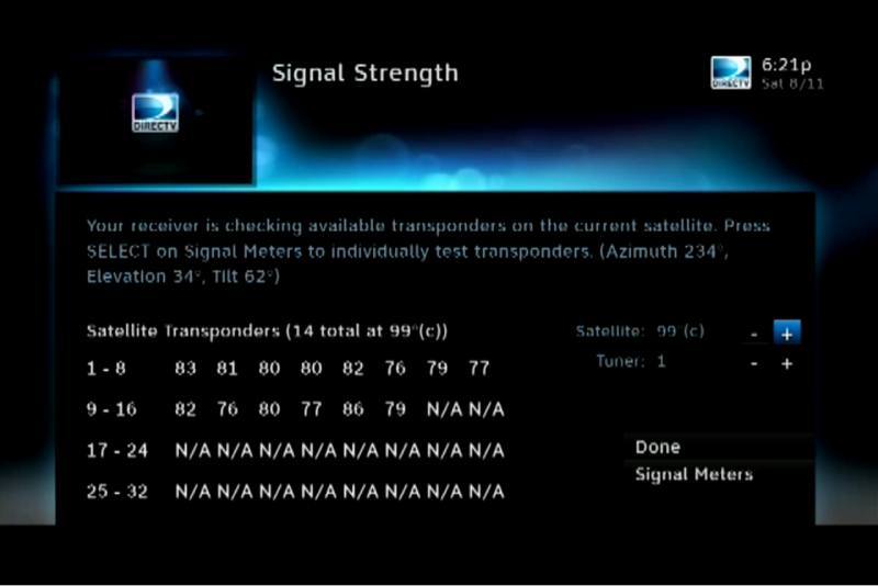

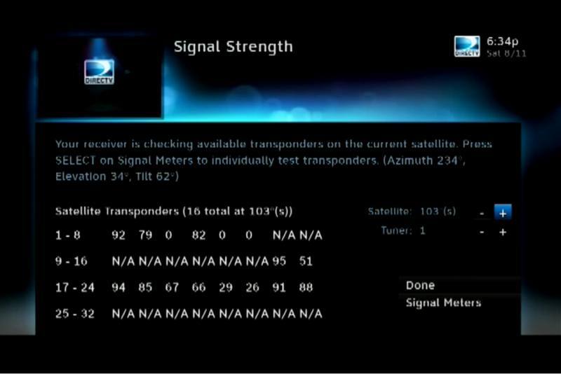

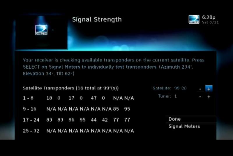

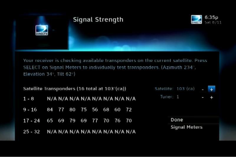

I have HR-24, which is hooked up to an original SWM-8 Switch which is hooked to a old 5 LNB DIRECTV AU-9 DISH.
The issue is I am not getting any HD channels. So I went through and did an Antenna setup and it tells me both 103 and 99 are bad.
I went out to the dish and tested it with my SuperBuddy and things seem fine. But to be safe I replaced all the cables going from the dish to the switch. Ran the setup again in the house and got the same results.
When I go to the Signal Strength screen it shows me good readings for all the satellites, however 99C and 103C are really slow to get readings from, while the rest of 99 and 103 screens are quick and show good signals. I will attach all my signal level screen shots below.
But even with this all done I still can't get my HD channels back.
Do I have a bad AU-9 LNB, or a bad switch? Has anyone seen anything like this before?
Thanks!
Here are the screenshots

same readings on tuner 2.
I have not bypassed the switch.
I do have an old Zinwell switch down stairs to try taking the SWM out of it, but that will leave me with a single tuner system (which I guess is ok)
Hmm might have been a CE issue...
I reverted back to the national release, and upon reboot everything has come up and is working. (And yes I rebooted it before a few times)
I know the week ago download not only knocked out my MRV, but when I ran system test on my HR24/100 it told me that I needed the 99 and 103 relined. So I went back to the NR and it worked fine. So I downloaded 0611 this past Friday and everything works fine. So it's possible.
