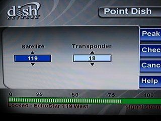

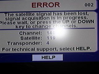

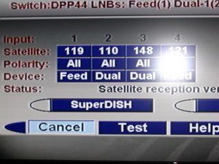

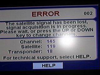

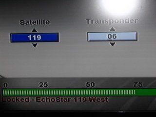

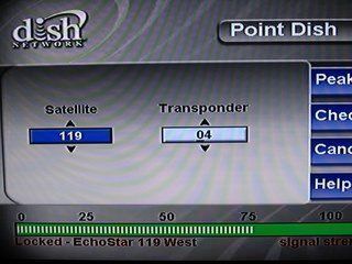

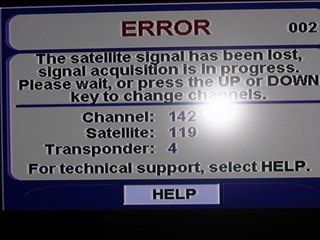

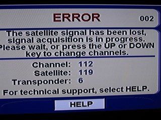

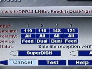

I had dish network service for 3 years and I never had any reception issues. I had disconnected my dish network service like 9 months back, but never removed my superdish/dpp44/inside wiring. Last week I reactivated my dish network service and from then on I am having intermittent reception issues on Satellite 119 transponder 4, 6 and 18. Before calling dish network, I had replaced the wiring from the switch to the receiver and still had the same issue. Dish network rolled the truck and the guy replaced the lnb, DVR 510, switch and rewired from the lnb to the switch and still I’m having the same issue. Now the dish network guy is complaining that the line of sight is not good and asking me to move it to a different location, but. I don’t have any option of moving the dish to a different location, since I’m living in an apartment. I’m attaching the screen shots for reference. Any help will be greatly appreciated.
Thanks for your help in advance
