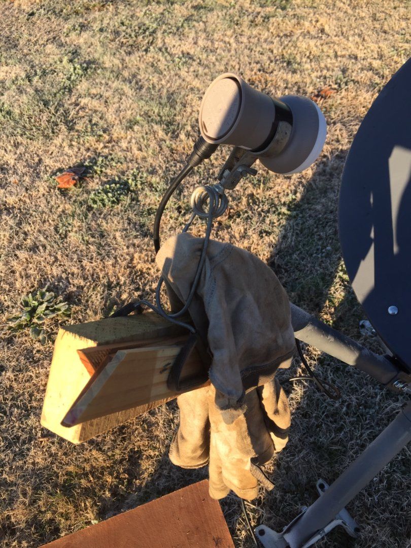

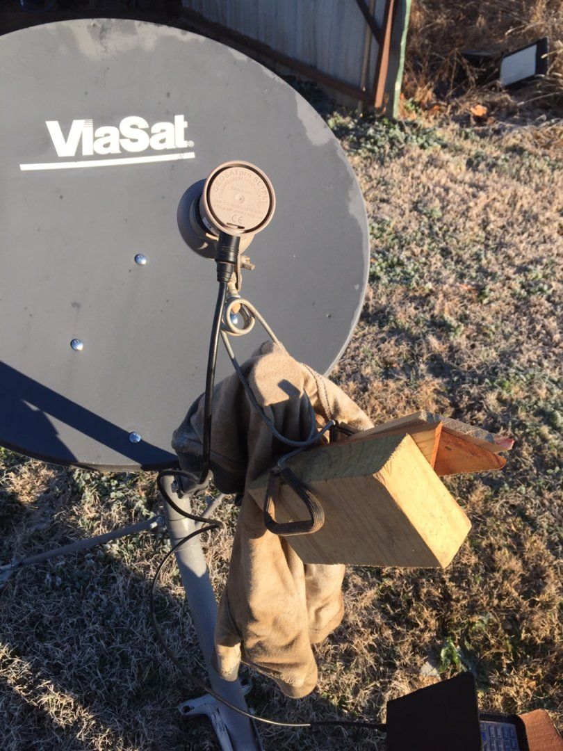

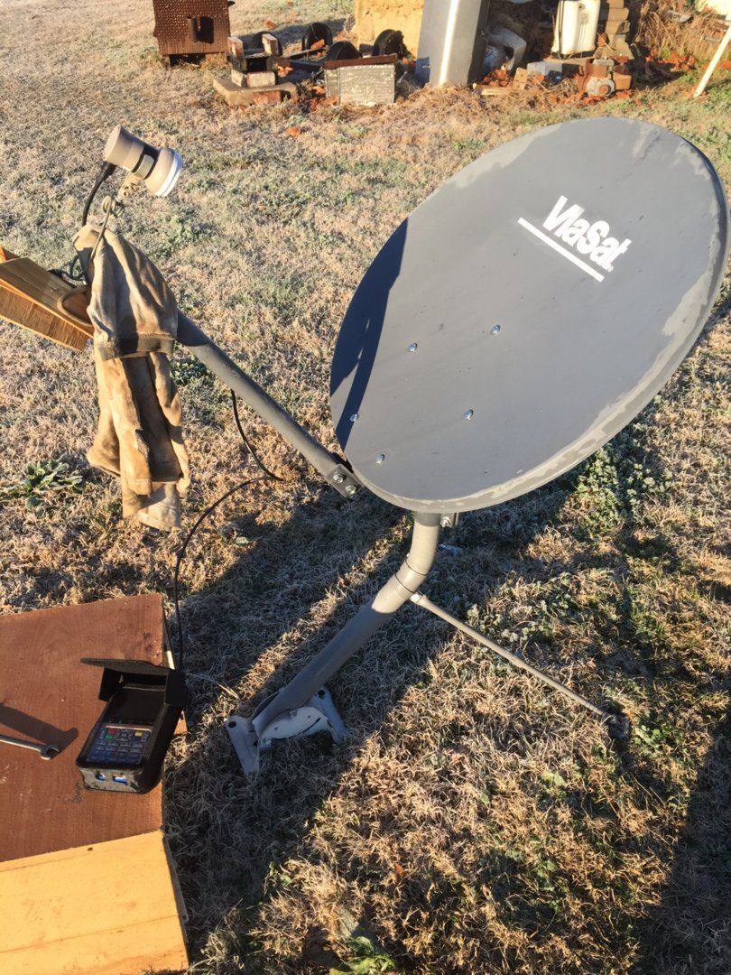

What transponder should i use for G19 and also the best lnb mount you have ever seen! Is it good enough?
Reactions: spongella

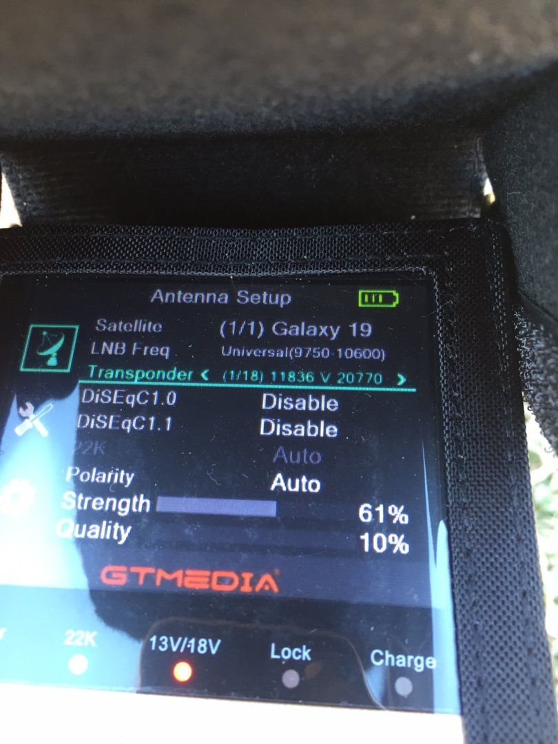

I recommend transponder 12152 H 20000 as it is not duplicated on adjacent satellites and reduces the chance of a false positive.
LNB Type: The screen shot shows the tuner setting of 9750/10600. Is the LNBF a Universal type with LO 9750/10600? If not, change the LNB setting to match the LNBF type and LO. If the LNB type and LO setting does not match the installed LNBF, frequencies will not match and it will be nearly impossible to locate the satellite.
LNBF Placement: Is the replacement LNBF placed at the EXACT position, angle and distance from the reflector as the original feedhorn? The center of the LNBF throat cover must be placed in the sweet spot where the reflected satellite signals are focused. If the replacement it not in the exact position as the original, either the signals will not be focused inside the feedhorn opening or the dish aiming will need to be aimed at a different angle. This will result in poor performance or no reception.
LNBF Skew: I see that your location is in Louisiana. This means the satellite is West of your location and standing in front of the dish, the LNBF rotation will be counterclockwise. The amount of rotation is determined by your location. Use www.dishpointer.com to calculate the LNBF skew rotation and the dish aiming. The signals coming g down from the satellite I'd linear polarity.
When a satellite is directly South of your location the vertical and horizontal polarity signals would come straight down at 12 o'clock and 3 o'clock and be received with no skew rotation. When satellites are located East or West of your install location, the vertical and horizontal signals arrive at a different angle and the feedhorn is rotated to align the vertical and horizontal antenna probes to match the skewed angle.

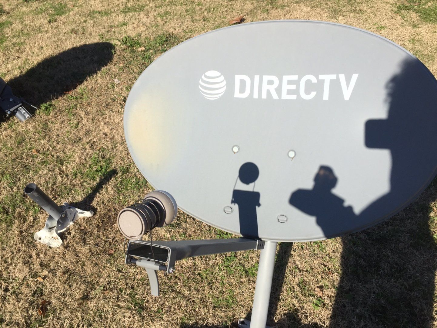

Is this a better plan i have the lnb for the direct tv so i can match it up better is this a better plan?
Reactions: Titanium
Use the largest reflector. Whatever dish you decide to use, the center of the replacement feedhorn cover must be in the EXACT position (height, angle and distance from the reflector) as the center of the original LNBF feedhorn throat cover that it is replacing. This photo appears to place the replacement LNBF in an incorrect position. Looks like it is too close to the reflector?
The regular LNBF for DirecTV is not compatible as it is circular polarity and higher frequency range.
If you have a DirecTV World Direct dish with the OEM linear polarity LNBF, it is compatible.

Regular DirecTV or Dish Network LNBF(s) will not receive FTA linear services. The LNBFs tune a different frequency range (12200-12750), use a different polarization (circular) and different LO frequencies.
The smaller Dish Network or DirecTV dishes will receive stronger transponders when retrofitted with a linear LNBF, but the poor performance will be frustrating on most satellites and services.

i will try updating or downgrading if possible to fix this transponder issue
nevermind i cant figure out how to make it save ANY of the transponders any ideas? i daddled around seleting transponders on other satellites but it still won't save
note i did do the update!
