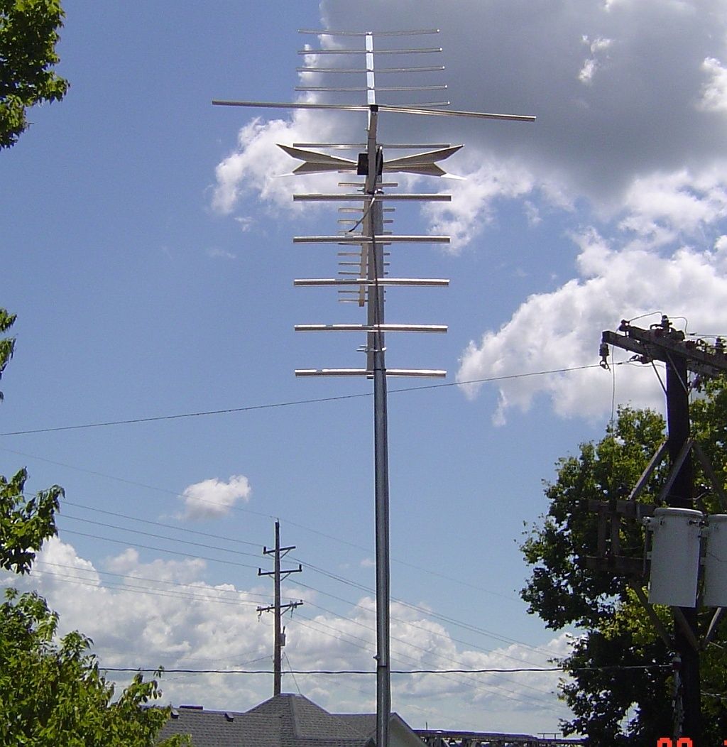

I was using an old VHF/UHF/FM antenna I bought off Craig's list a couple of years ago with a pre-amp. See pictures below.

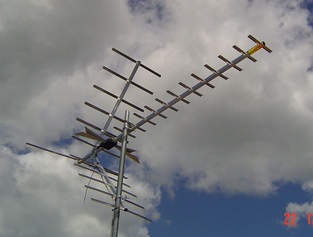

I went out Monday and bought a Digi-Tenna DUV-XF antenna to replace the old one. See the link for specs and the pictures below.
I have been struggling all week trying to get all the channels viewable from my home to work on my setup. I now have the antenna about 25 feet off the ground. It is on a tri-pod and about 12 foot off my flat commercial roof.

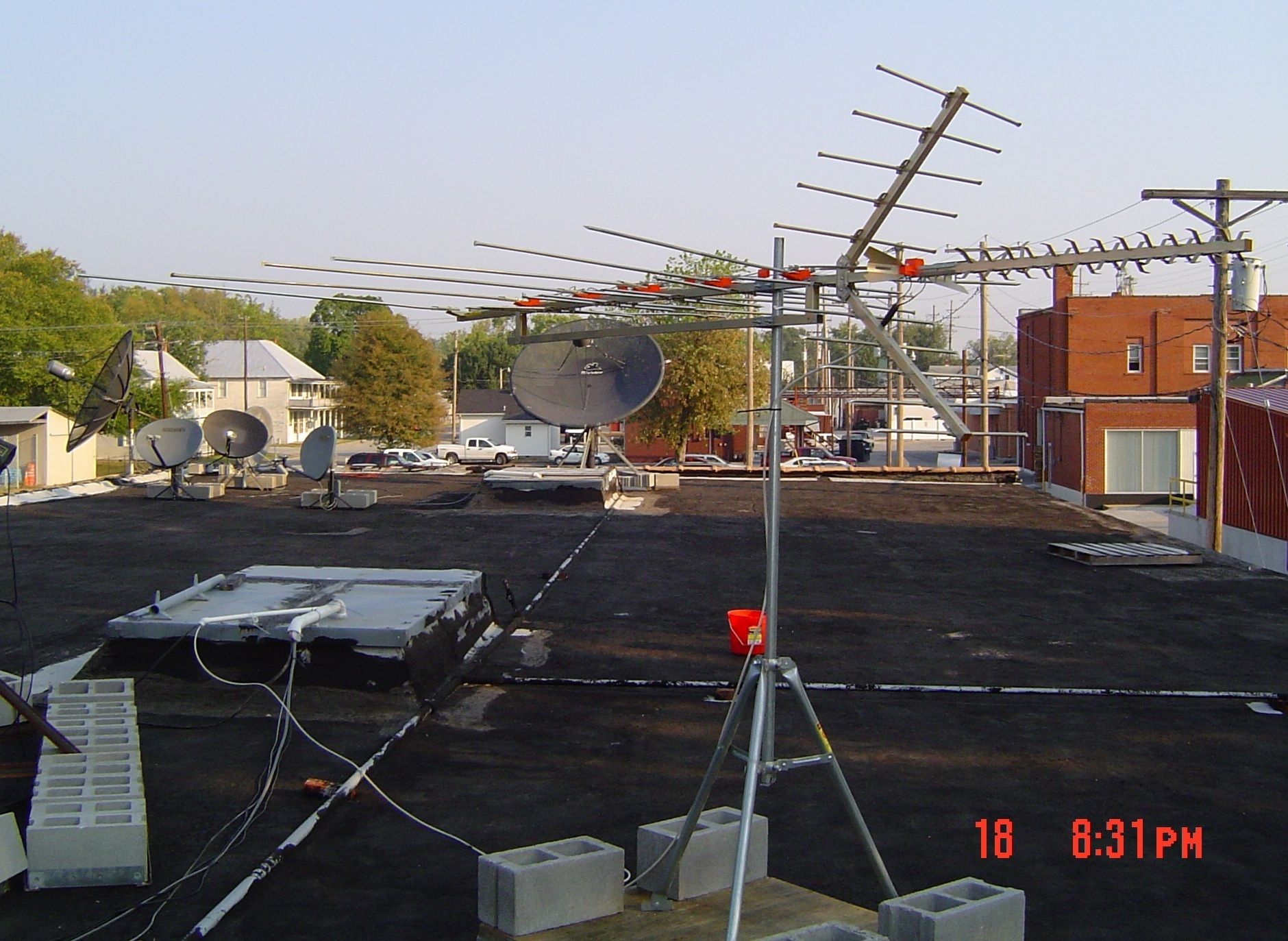

Take a look at the chart, and the pictures and let me know any suggestions you might have. I have not yet tried using the pre-amp and the distribution amp in combination, so that may be an option. The distribution amp does have a potentiometer, but I have not messed with that either. I don't know what I am doing with the POT, so have not messed with it. The distribution amp also has an FM trap, and I have tried switching it both ways and it seems to have no effect.

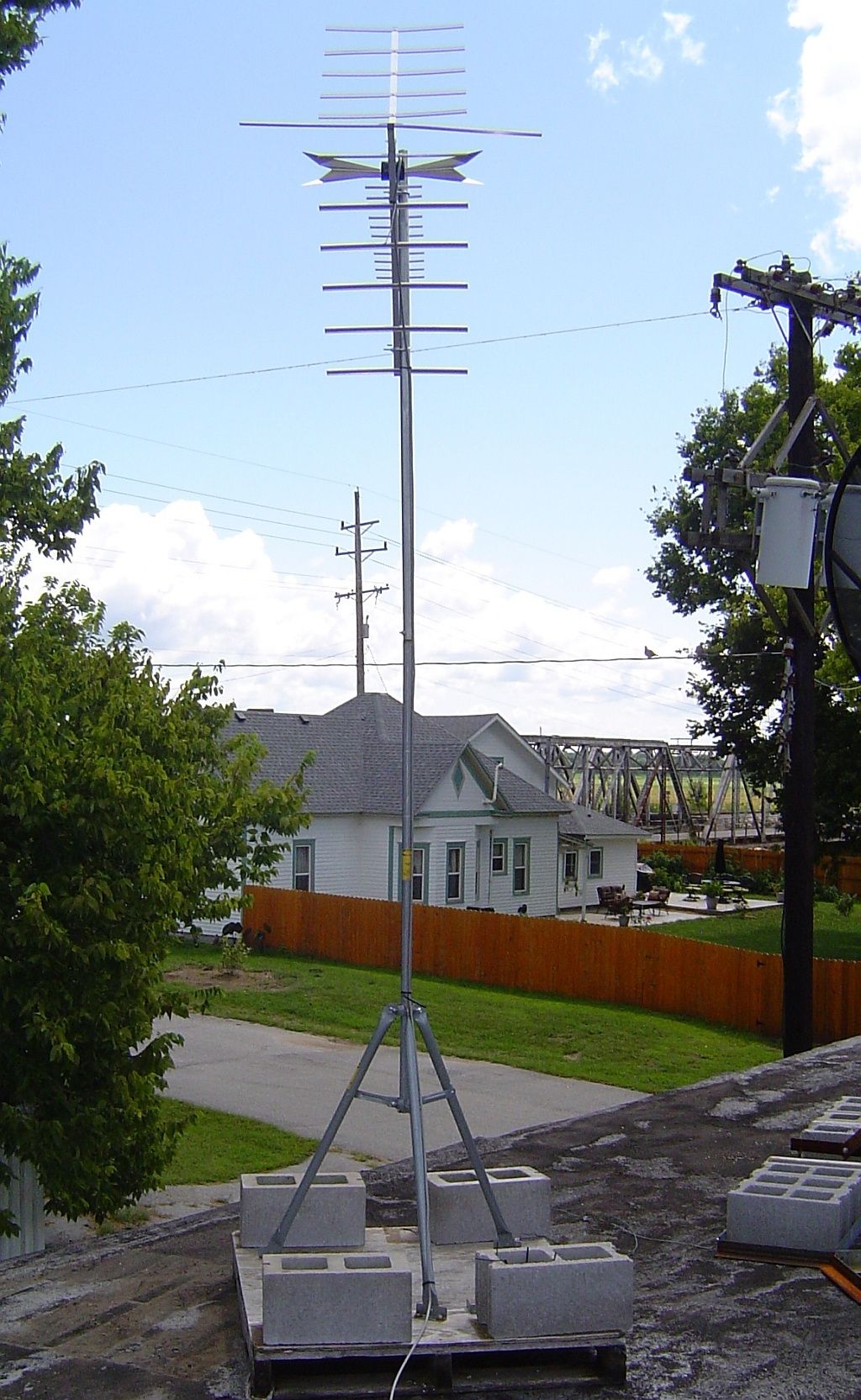

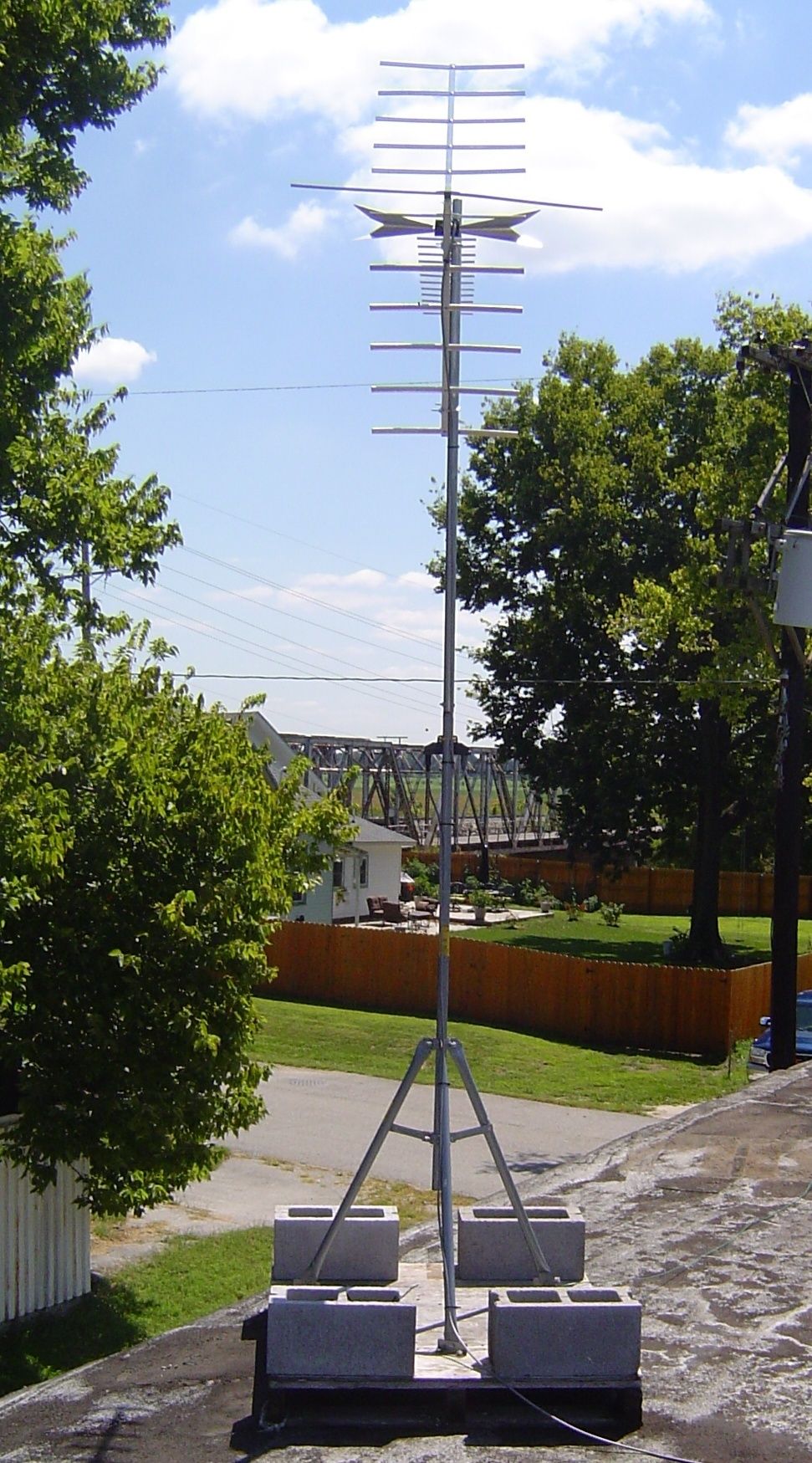

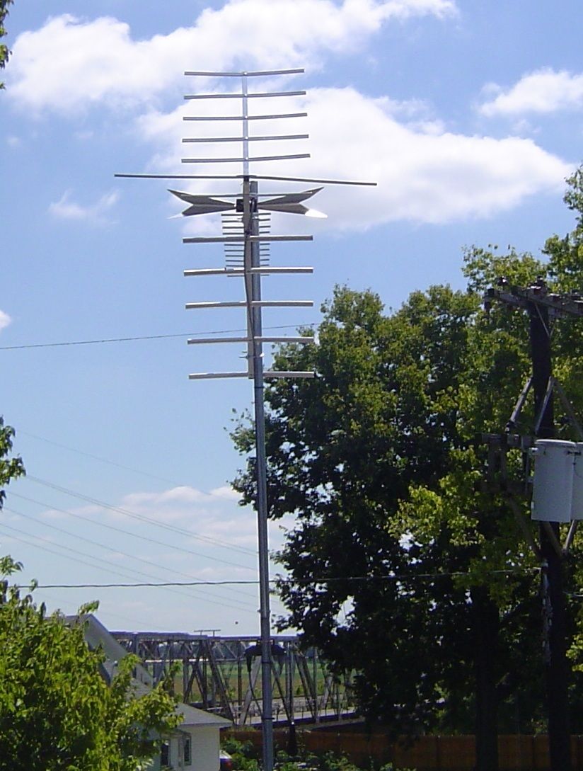

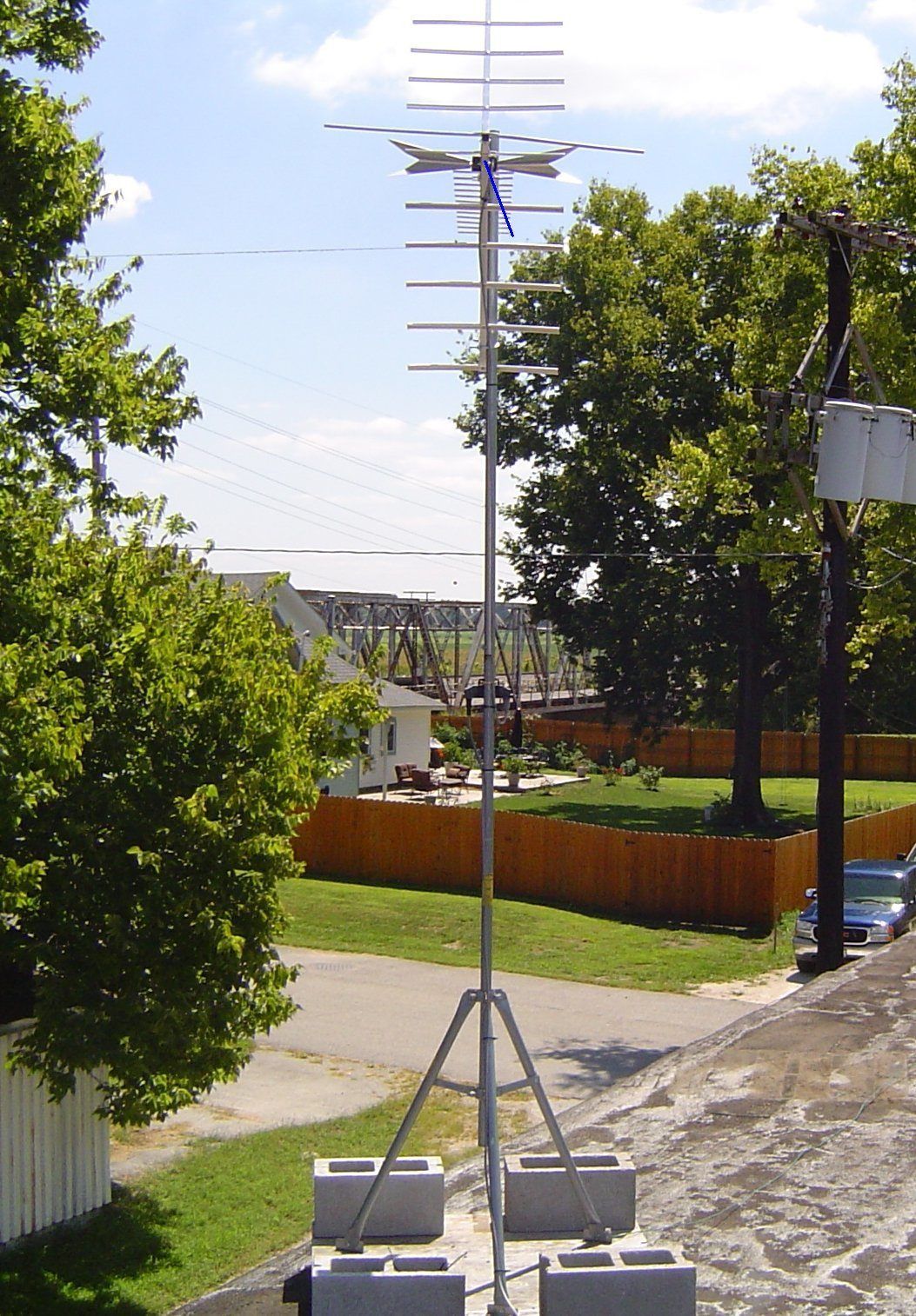

Here are the pics:

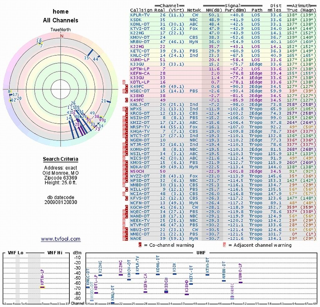

Looking at your TV Fool, 46.1/47 should be an easy job. I agree that you need to move the antenna about a bit first.

All that writing and I JUST NOTICED THE BUD WITHIN 10 FOOT of the antenna! :eek: :rant:
I have such problems with the Digital TV reception and the Horizontally polarized signals. A full BUD on plane with the antenna that is NOT in the Null zone of the antenna (around 90 and 270 degrees usually) will cause strong echoes.
Move the antenna back...:D or lower it below the BUD reflector.

Which why most times higher is better........unless your 10' BUD is higher than your antenna. :)

Which channel did you use to tune the antenna? At 160 degrees az. channel 47 is a little further south than the rest. Try tuning to that one.

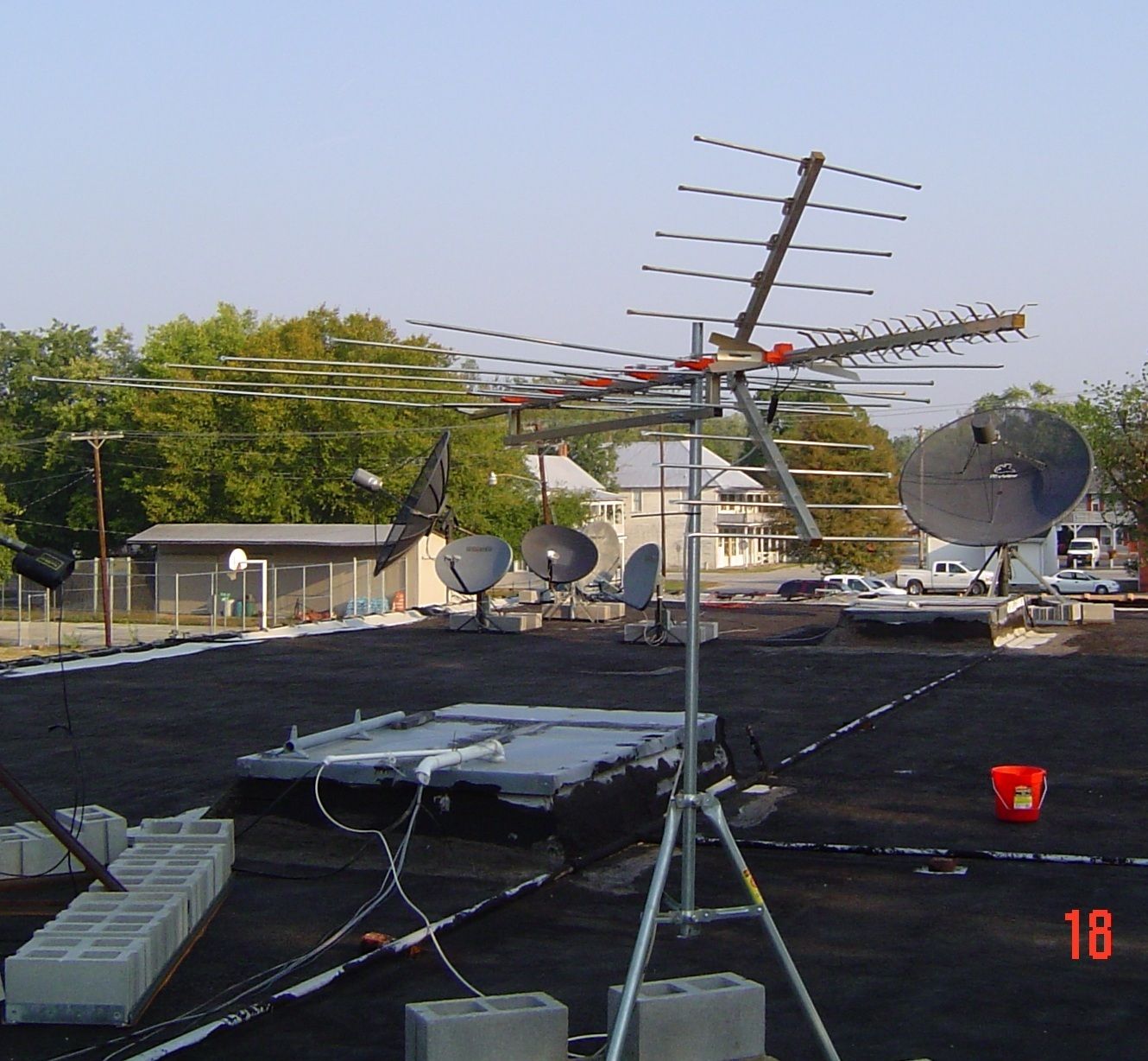

First thing this morning, I went to town and traded the distribution amp for a Winegard AP-8275 Pre-Amp.
Got back and took the tools to the roof for a re-tune of the antenna. I used a Zenith DTV tuner with my mini-dvd for screen output to tune the dish.
I moved it on the roof some and backed it away from the BUD about 10 feet. As big as my roof is, you'd think I would have more room to play, but i have 8 BUDs up there along with an assortment of Primestar dishes, plus the South side has big trees, and the East side has big trees. So my "window" view the the SE towards the city is limited.
I actually got my best signal on channel 47 through the big tree to the South. In the first picture below, you can see the line I drew. But having the antenna in that direction did cause some degradation to the other channels further East, so I moved the antenna slightly further to the East and compromised.
Tried moving the antenna up and down as much as 2 feet lower, but no better signal.
I finally settled for what I had which was actually a little lower than I had yesterday.
Put on the new Pre-Amp, and buttoned everything up.
Got inside and all was pretty much the same except that I had less signal on channel 47 than yesterday. I was a bit discouraged, and came to the computer to ask about perhaps mounting 2 antennas. Using the new one pointed far south, and the old one pointing more to the East, and I still might do that. :)

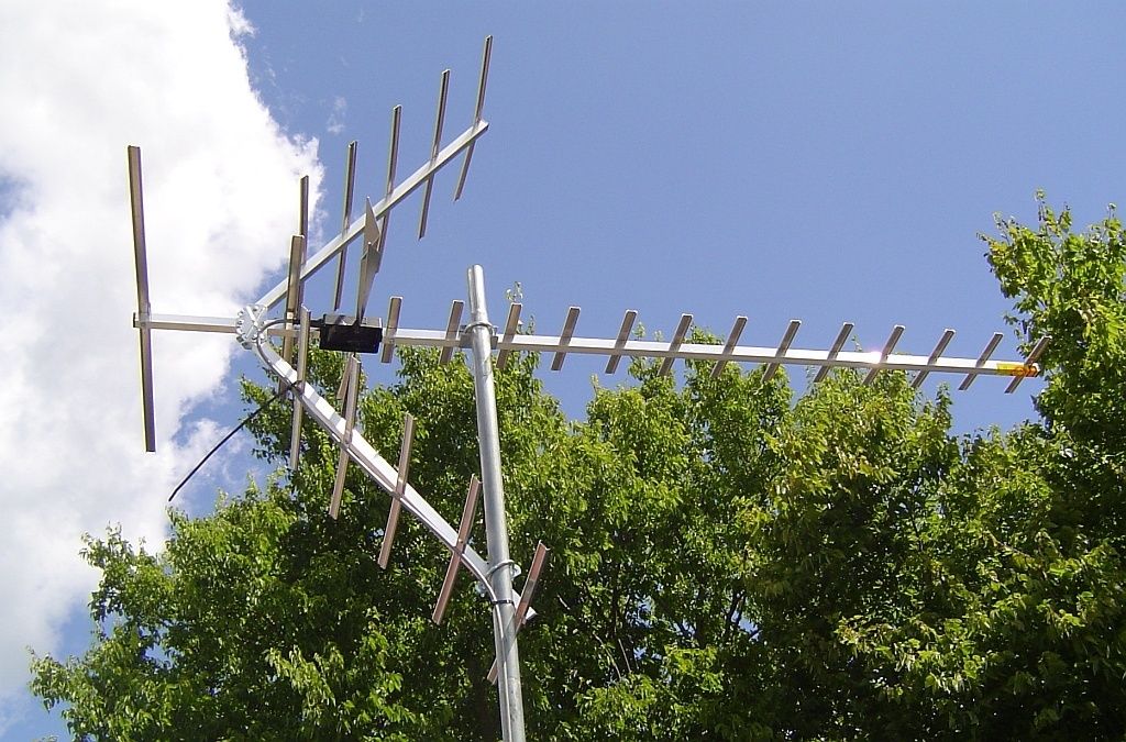

See the pics below:
