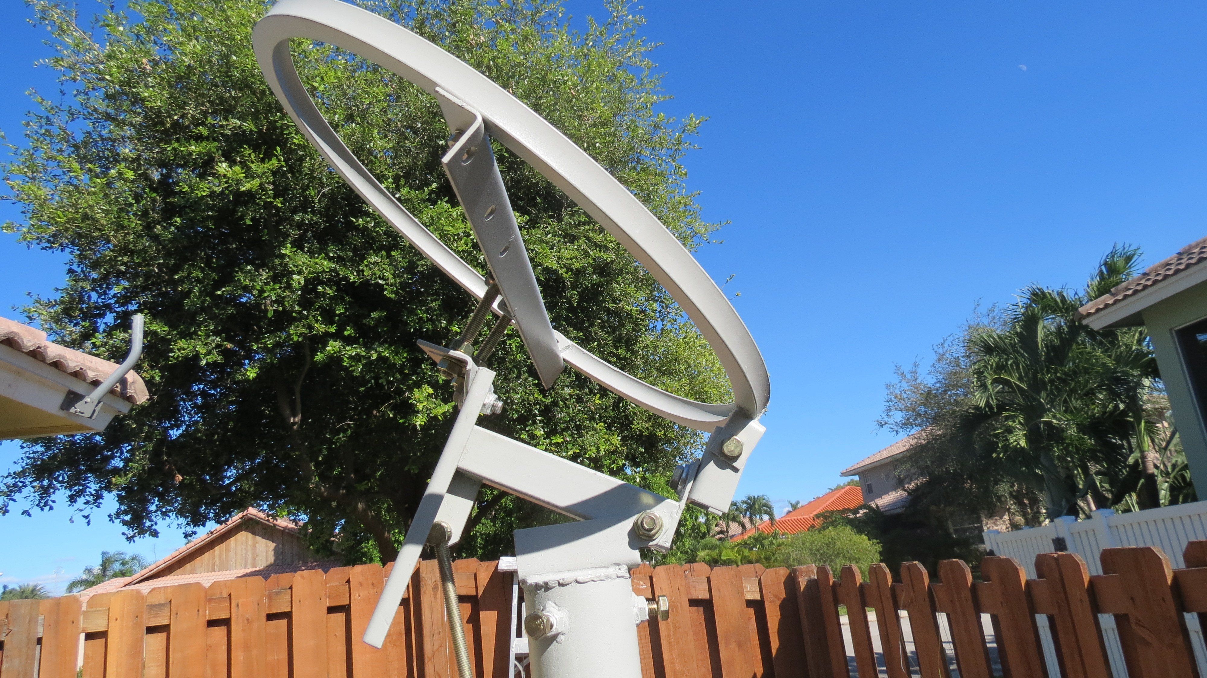

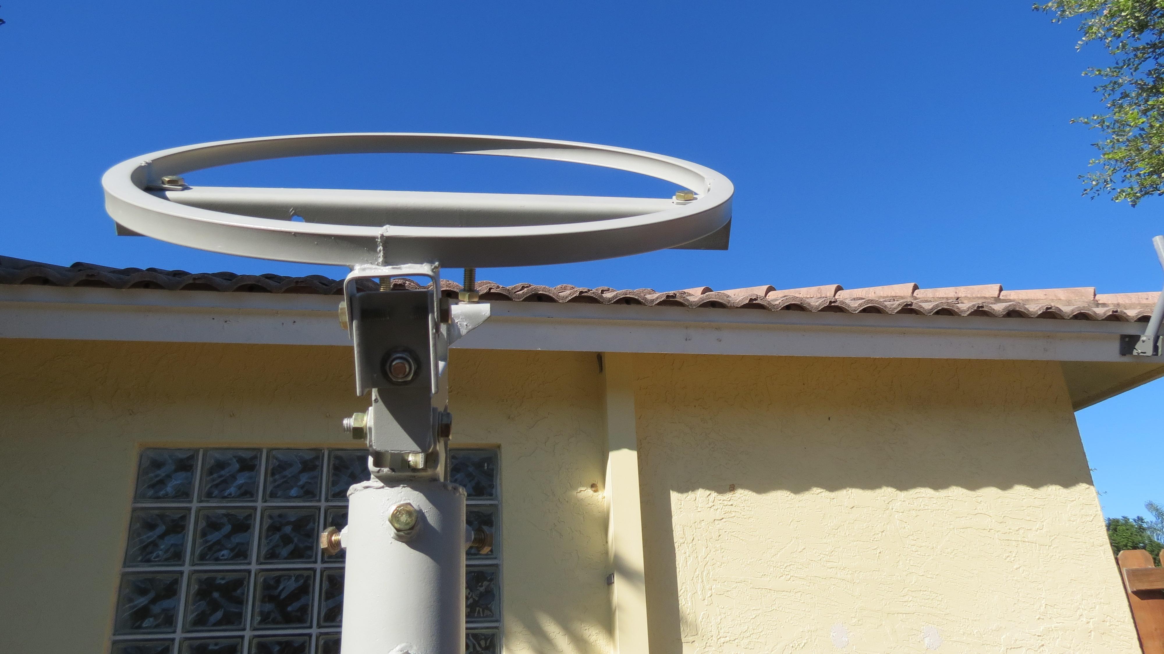

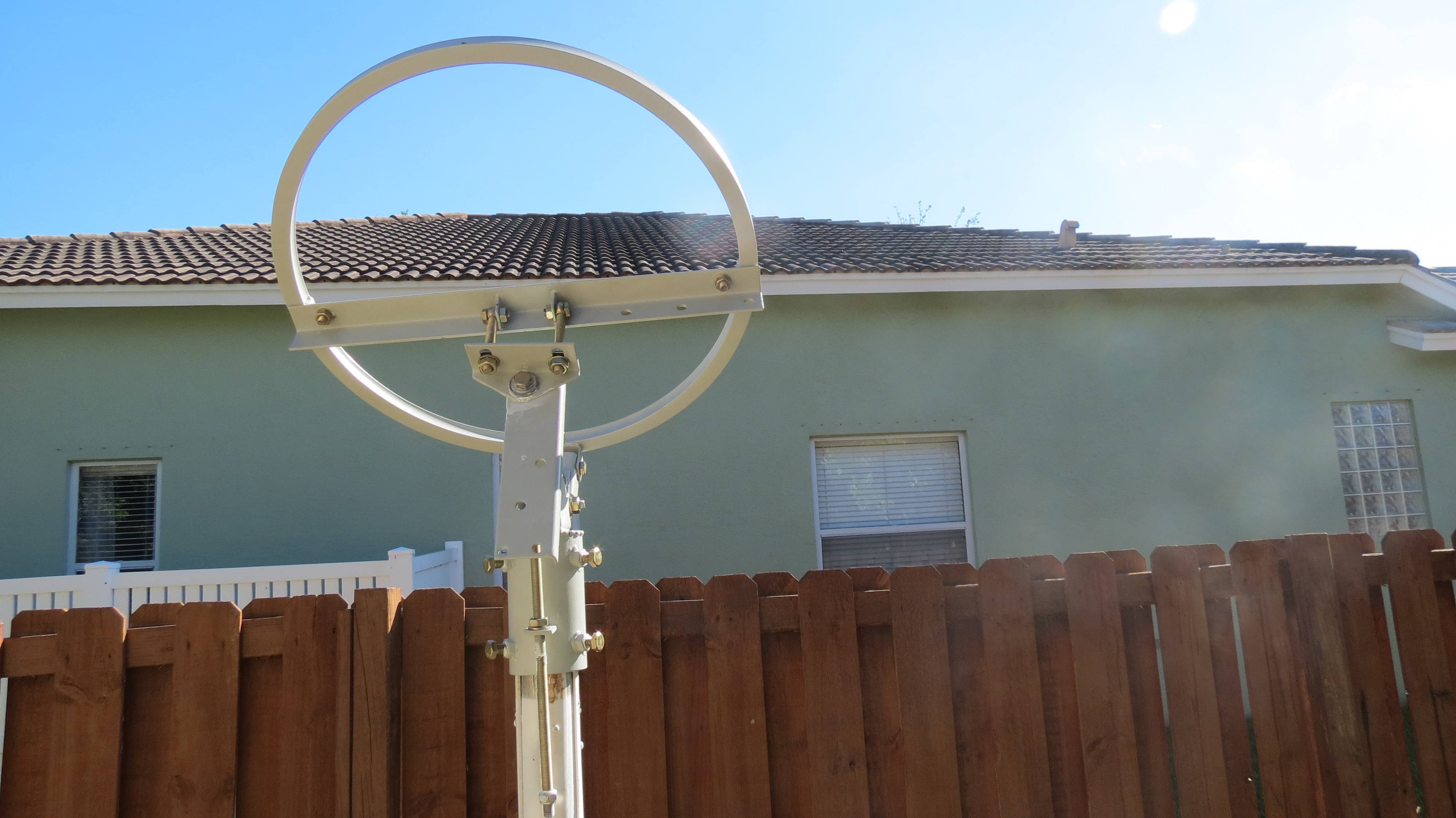

jibaro29 SatelliteGuys Pro Original poster Mar 13, 2007 377 12 Lake Worth FL Oct 11, 2013 #1 This the first time I have put together a Fortec polar mount and I am uncertain whether or not it's put together correctly. I have two questions: Is that the way polar mount is suppose to look? Where do I make dish elevation adjustments? Thanks
primestar31 SatelliteGuys Master Lifetime Supporter Mar 15, 2005 13,460 13,769 Beta Omicron Delta III Oct 11, 2013 #2 The long threaded rod on the mount by the pole is for Elevation/Latitude. The two threaded rods towards the top, are for setting Declination.
