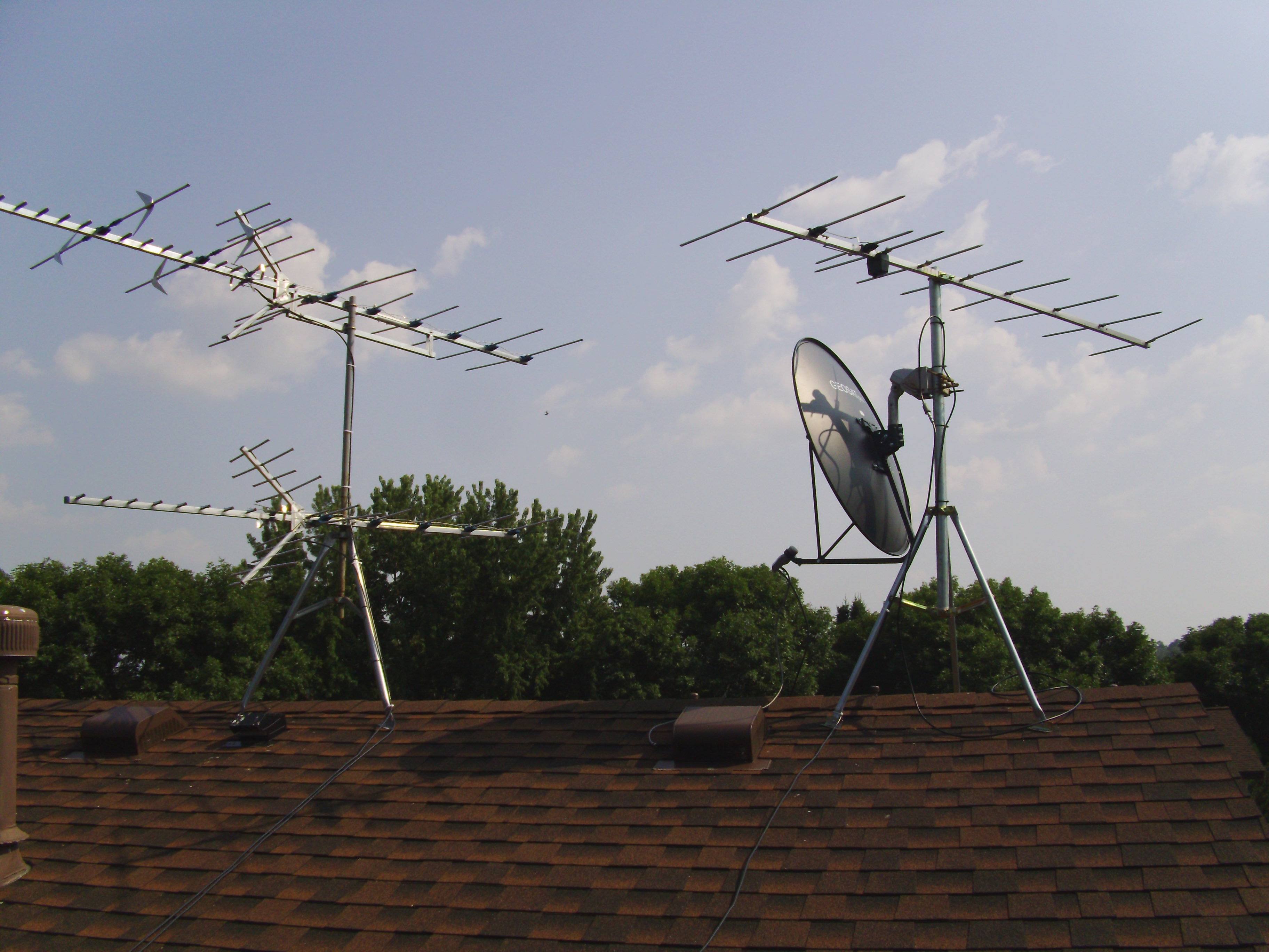

By the way here is my antenna setup
left mast is the HBU44 (on top) and the HBU33 (on bottom)
right mast is a VHF only antenna aimed at Mankato for KEYC 12 (CBS/Fox subchannel)
the dish up there got removed recently ;)
