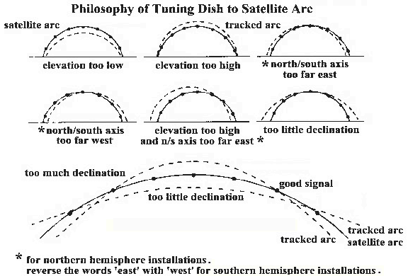

When moving west I have to elevate dish when moving east lower dish.
That sounds like you are not properly aimed South
See diagram in upper right of Pic....
