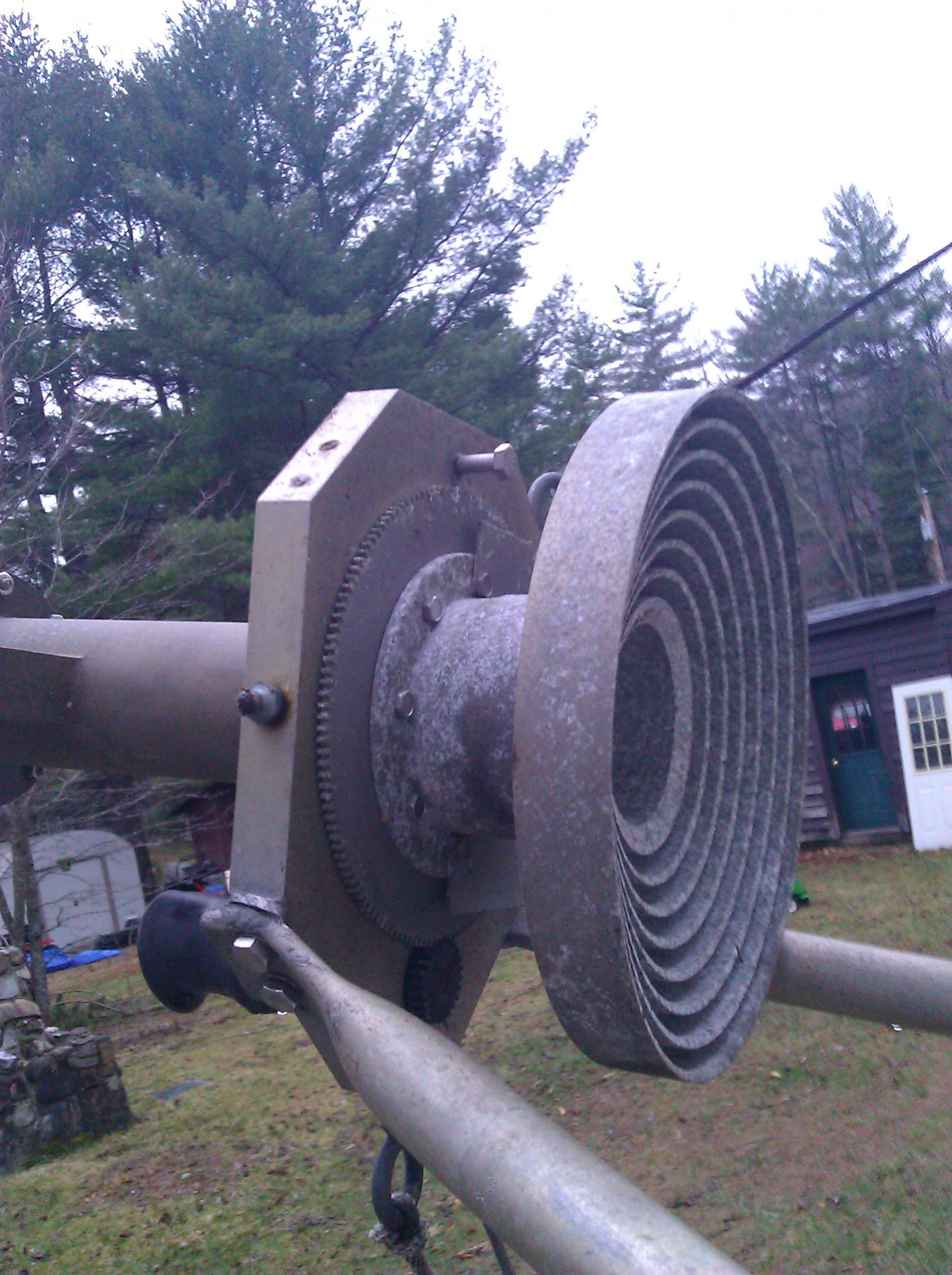

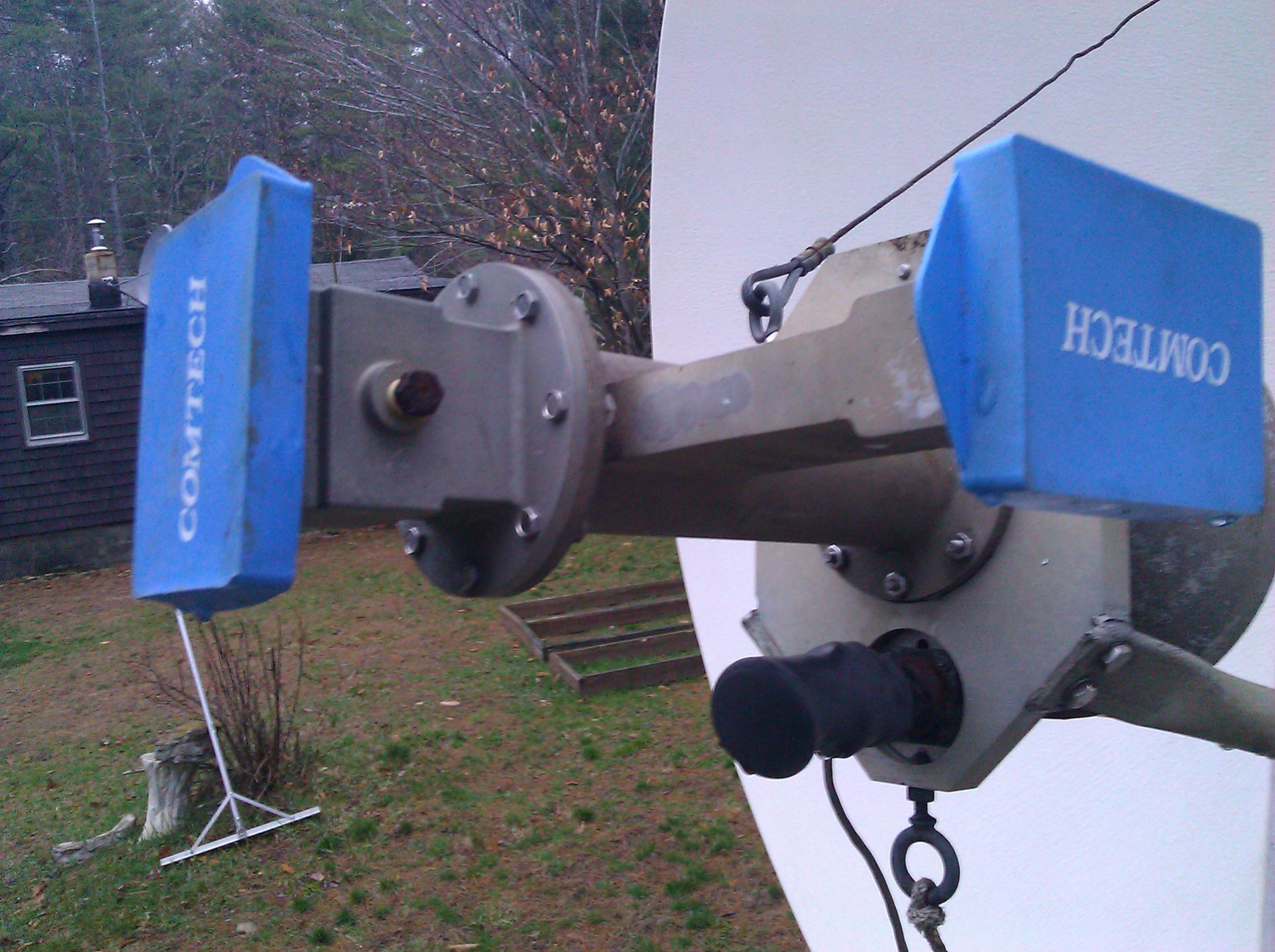

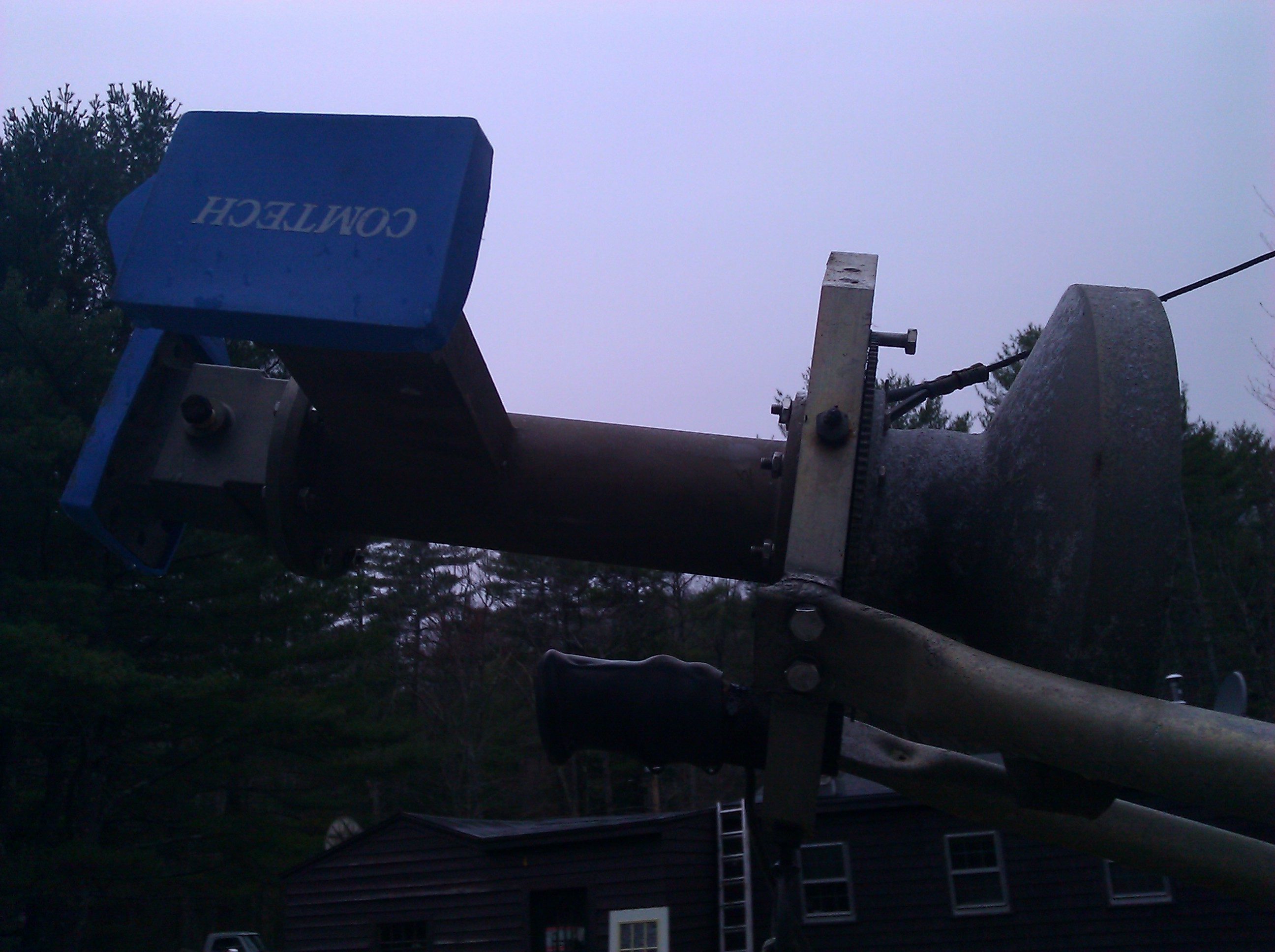

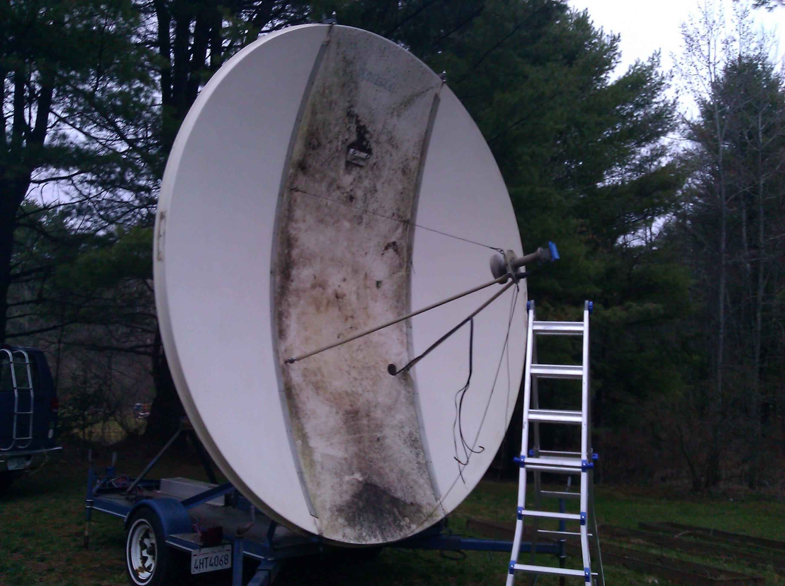

I bought a 12 foot Com-tech Portable dish. I am lost as how to setup the Feedhorn and LNBs on it. There is a cover on the front of the feedhorn and on the side. It looks like you can bolt LNBs to both covers. There is also a couple of gears. Is this to adjust Skew? I am also not sure how to set the elevation. I would like to point it at 87w, 91w, or 135w. I know how to setup Ku dishes but I am new to C-band. I already have the mount level on it. Does anyone have any recommendations on which LNB to buy? There is no motor control for this.

Where the covers are you install cband lnbs.
This feed horn gives you both H and V polarities.
I've not seen the gears before but would guess and agree this is for skew, kinda cool!

Can't see the back side of the dish, but I'll bet there's a place you can stick in inclinometer.
I wouldn't want to take a 12' board up the middle on the front side, just to check the elevation. :)
The mount being plumb may not really matter much for fixed operation (more critical if you're motorized).
That knob below the feed looks like your skew.
Maybe you pull down on the lanyard, then twist the knob half a turn at a time (?)
Suspect it'll be obvious to ya, once you play with it a bit.
For the dirty middle of the dish, I'd go with a power wash.
Some guys have discussed a stiff brush, hot water, soap, and maybe a little bleach for cleaning.
You've already got an orthomode feed (two LNBs, one for each polarity).
And a fancy matching scalar.

Cool I ordered 1 lnb for it I suppose I will order another now. The dish came with an inclinometer. The LNB that came with it has a different fitting on it. I think it came with some of the switches you speak of but they have the bigger style connector on them. You aren't talking about the Diseqc switches are you? I have several of those. It also came with a smaller feedhorn which I think the guy said was for Ku but I just want Cband for now.

The Ku lnb flange will be smaller and square compared to the cband rectangle shape. The collector or arm for ku is different to cband. From your pictures it doesn't look like the feed horn supports ku.
For an example check out the chaparral supercorator which supports cband and ku on a single feed horn using a polariser servo.
Just reread your last post, you have a separate ku feed horn which is correct.
