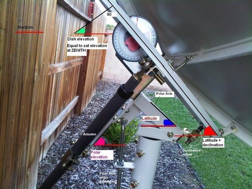

Start by finding the satellite closest to your latitude by setting your dish up as shown here (The modified and true latitude angle are pretty close to each other(measurement errors)
attachment.php
Adjust the elevation and twist mount on the pole to peak your Quality reading.
End of Step one.

Step one, set the elevation adjustment. Elevation is ONLY adjusted on the highest satellite above your horizon. It's the satellite closest to your longitude. Use the actuator to 'center' it's position to the polar mount. As shown in the above pic.

or similar. With the dish 'centered' about the mount/polar axis. Make sure the difference between you latitude angle and the latitude + declination angle is as close to 5.96 a physically possible to measure. Then set the polar angle. (latitude) and then the dish is at the correct height to find your Zenith satellite.
Then proceed with the alignment previously outlined.
