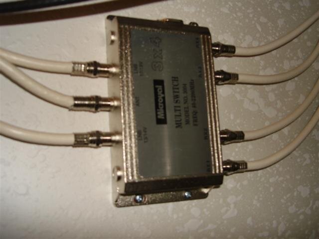

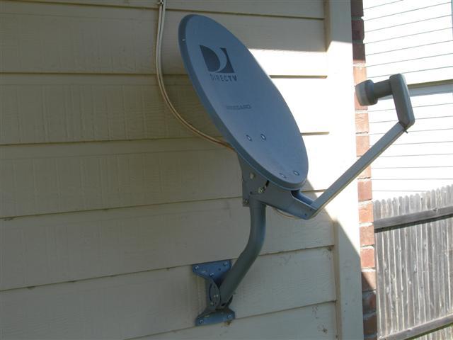

At this time my house is set up for Direct TV, Standard Dish with a dual LNB, Quad shield cable thru out the house and a 4-port multi-switch. I haven't been using Direct for about 3 years now.
I understand that I will need a new receiver what are your suggestions as far as one that has options and upgrade ability. I saw a few using USB and most using serial cables.
Anyways Thank you all for your input, I'm hoping to get a system on order the end of this week so I can hopefully get everything installed and running next weekend.
This is the system I'm thinking about ordering. Motorized FTA System - Viewsat Ultra FTA receiver, 31" satellite dish, motor and invacom LNB.

1). if you get that system, I'd take the one cable off your switch, that went to the room where you want to put the receiver, and use it.
The rest of the cables and the switch would be there for future expansion.
2). you'd use the diseqc switch that comes with the receiver for switching between linear and circular.
3). I wouldn't choose that particular brand receiver, as I think they're overpriced for non-hacker use.
However, I'm sure it'll work fine.
I'd get one that has a USB hard drive connection, or one that is priced less.
....hrmmmmm.... odd that the price is about the same with a Mercury II . . .
4). the rest of the equipment generally seems fine.
5). get some other input if a 36" dish might be a better choice.
Where you live might be a consideration.
