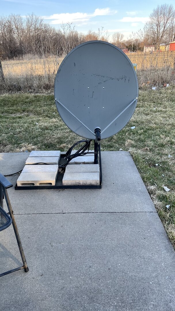

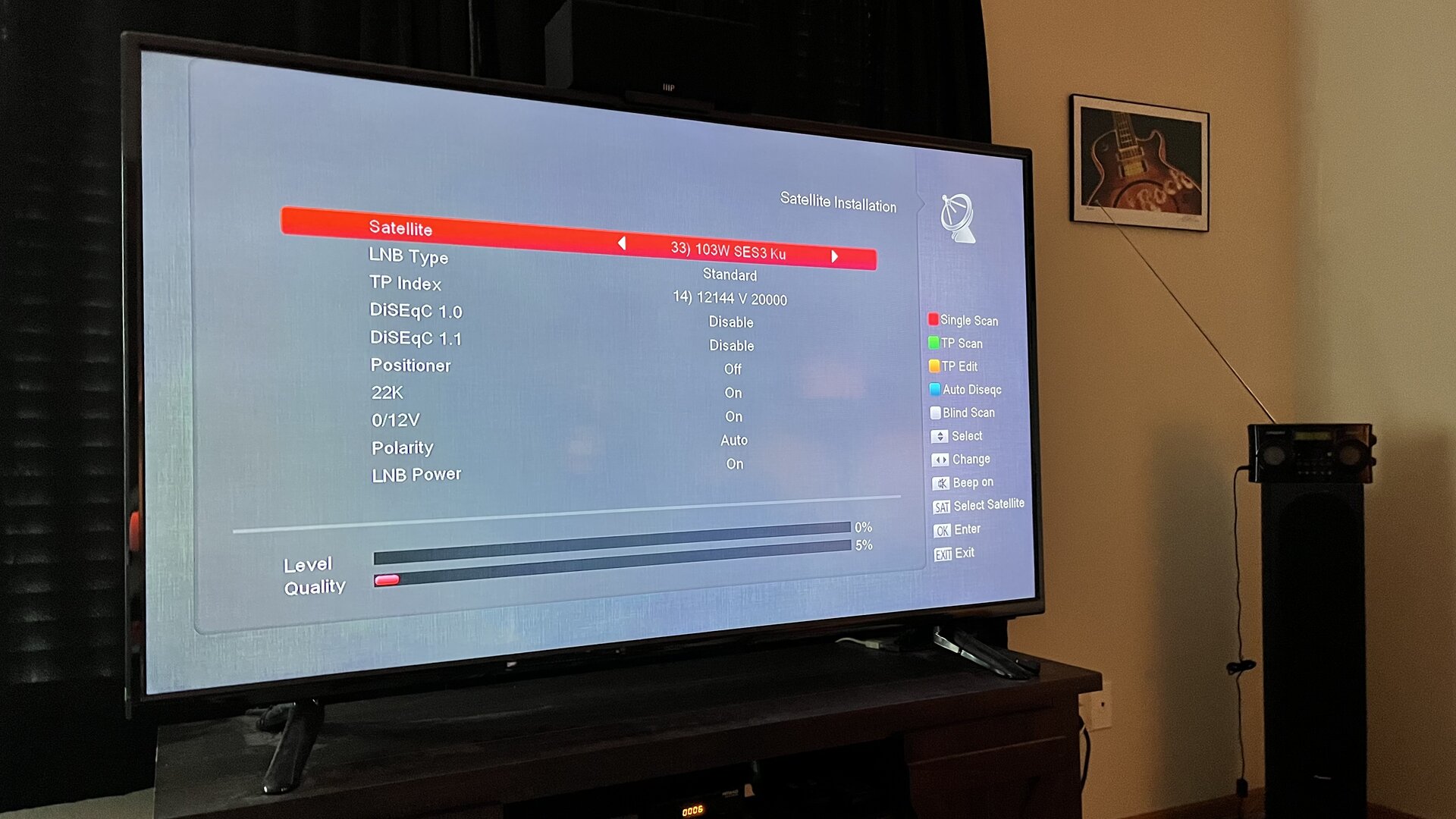

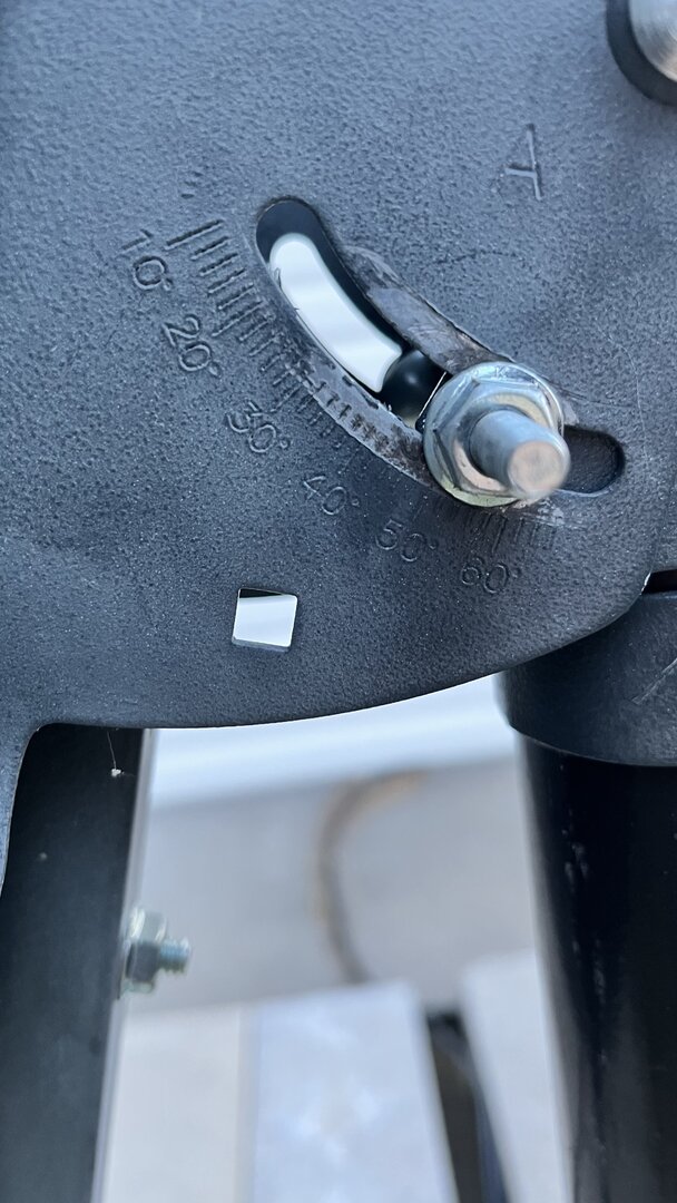

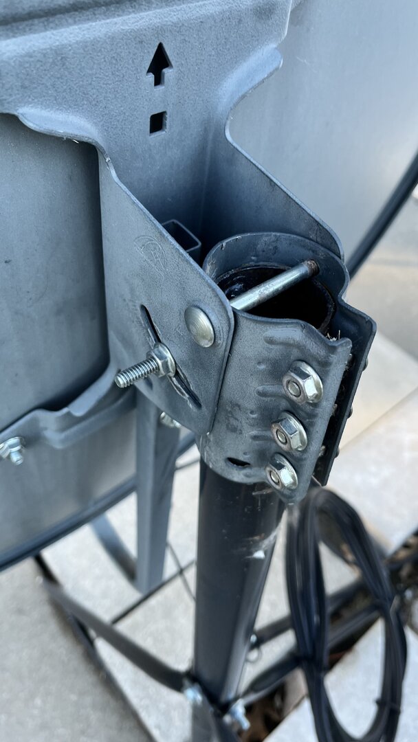

Long story short I retired my motor today, after months of it proving unreliable and drifting off course. I'm trying to locate 103 and I'm having zero luck. I guess it's been so long that I've forgotten how to align a stationary dish. What am I doing wrong here?
LNB is a universal dual.

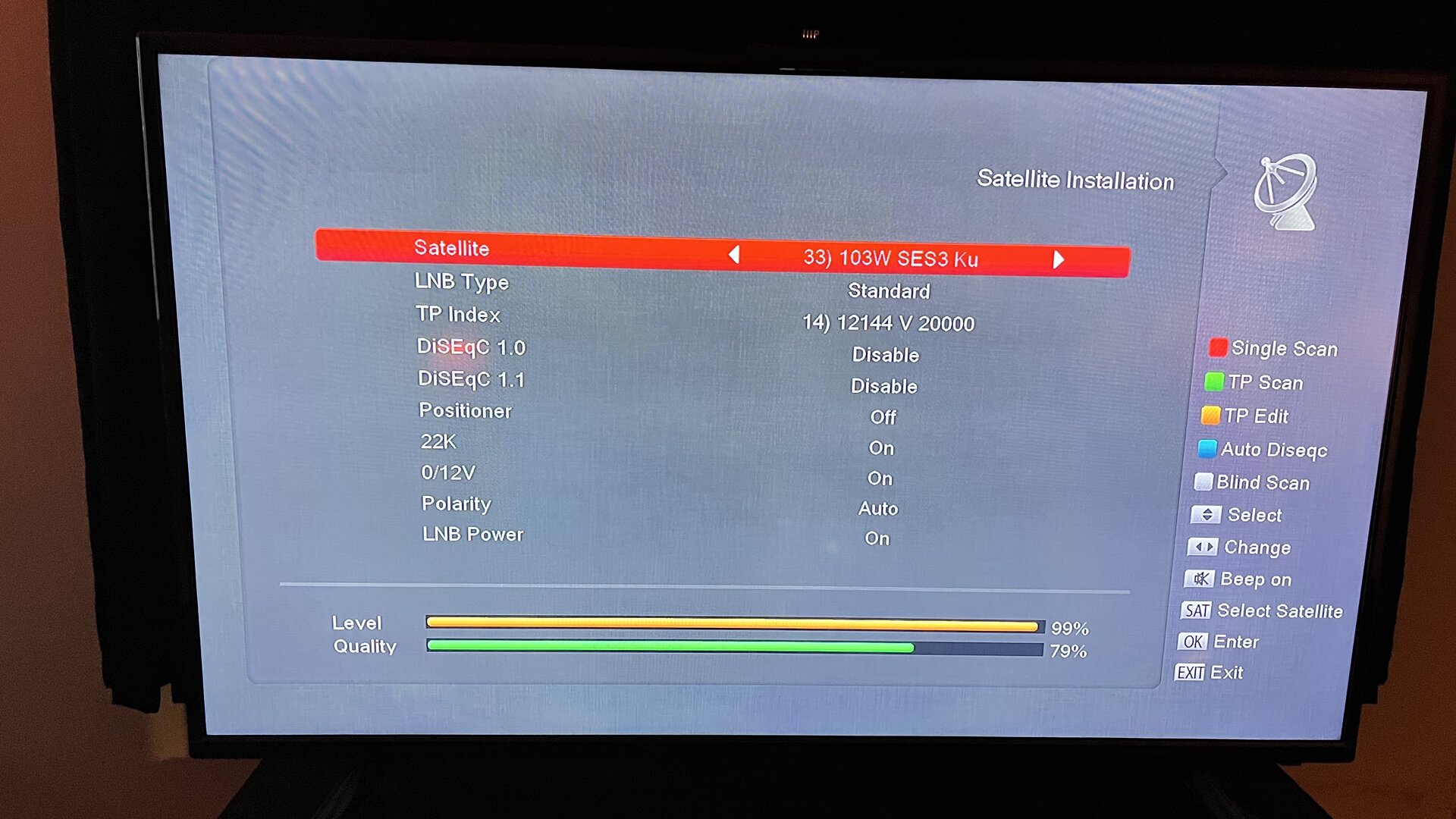

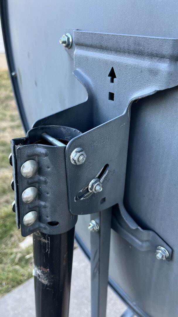

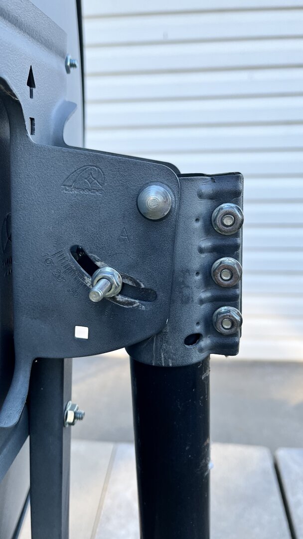

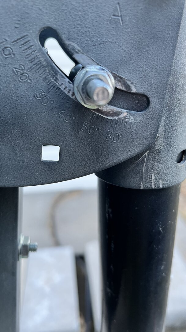

Since for some reason, the site won't let me edit my own post, where do you find your LNB skew and elevation degrees?
Glad you got it lined up and are receiving a signal. But I am not sure about the LNB type. Shouldn't it be set to 'Universal' instead of 'Standard'? (Based on post #1)
