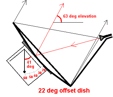

Also remember an off-set dish looks to be pointing around 22º lower than where the signal is actually coming from!

As luck would have it, this satellite is at 24 degrees elevation from my location which is exactly the offset for the 30" Winegard, so all I have to do is put a level on it and make sure that it is vertical. It is pointing about 15 degrees to the left of the satellite, though, I'm picking up a deflected signal, it is pointed right at a solid mass of trees that are 60 feet tall and only about 30 feet away. Maybe I'll go out this afternoon and do some sweeps and see if I can pick these other channels up...
