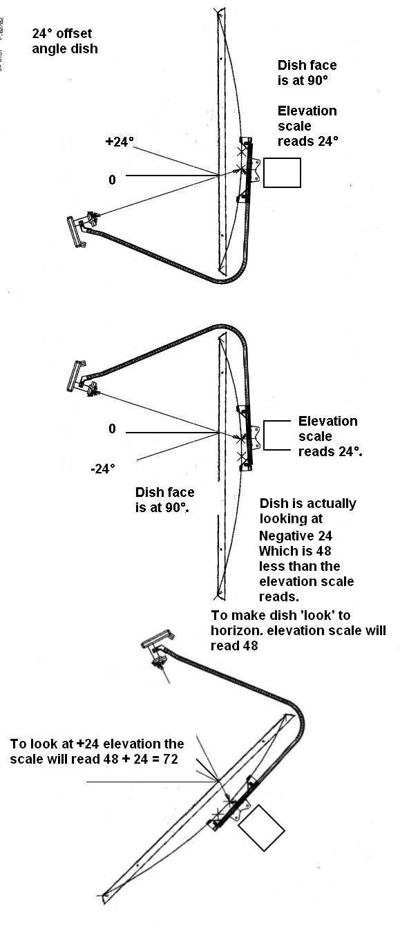

"I want to better understand the elevation of an inverted dish"
See attached.
attachment.php
