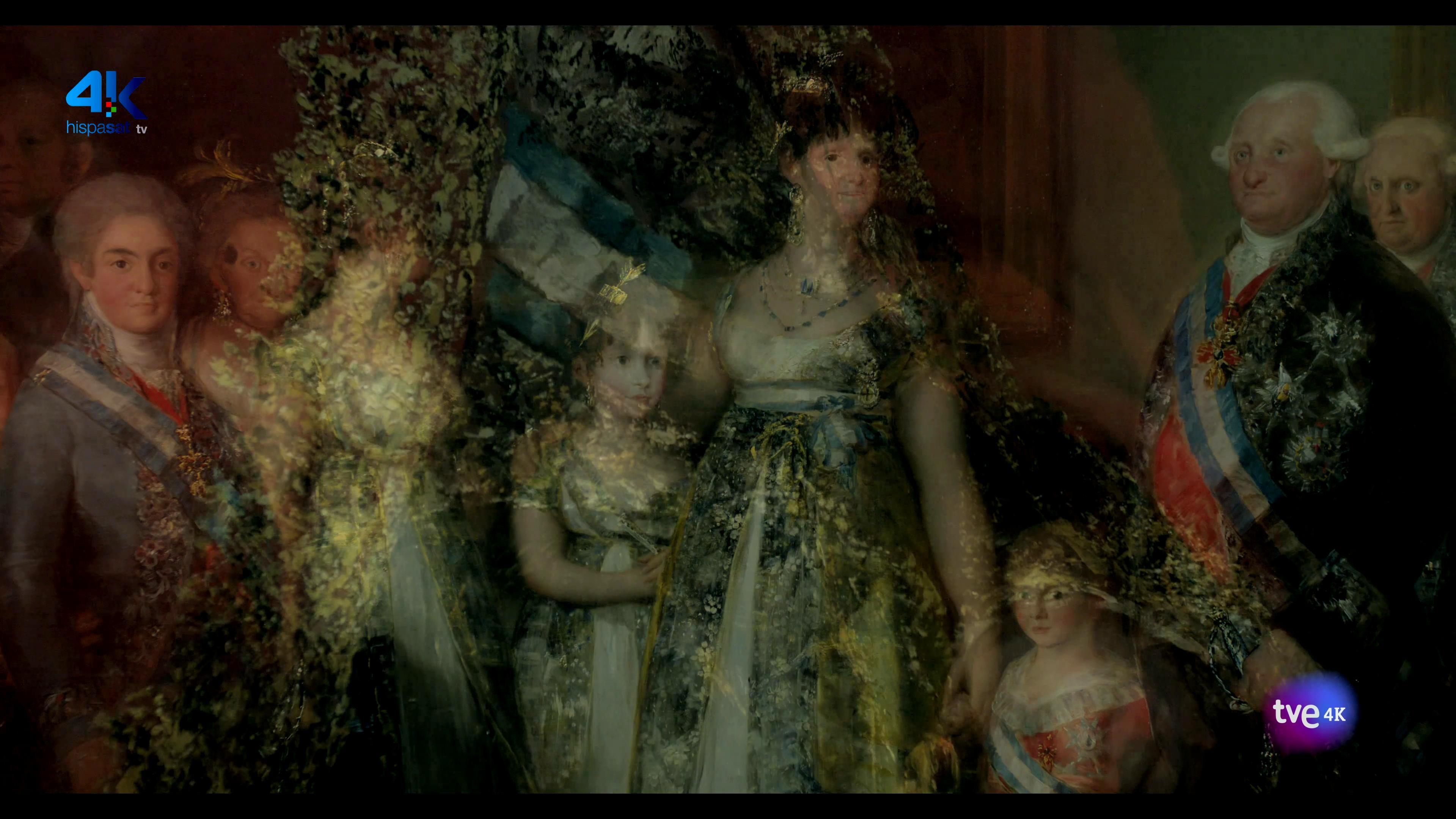

I was able to get a good signal on my 6925. the normal HD played flawlessly on my pc. screenshot attached. it wouldn't lock on my AZbox.

sorry guys. here 's the info. 61W Amazonas 3 12012 V 30000 S2-8 2/3 Pilot on. Crazyscan is reporting a good strong signal @ -37dbm @16.5DB C/N. VLC scanned as ch-1 with ID-110 3840x2160 24HZ 4:2:0.
