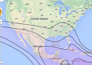

According to the footprints, Intelsat 11 is visible for North America. For Amazonas3, it looks like it is visible in Texas, but would probably require a larger dish to pull in.

Here is the footprint for Amazonas3

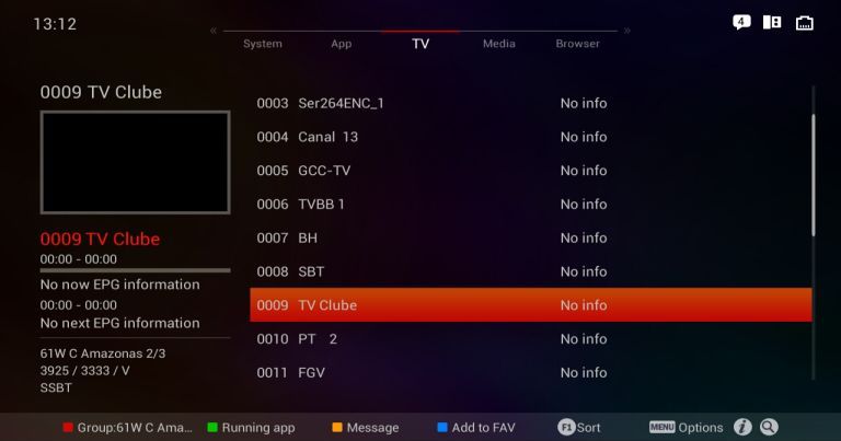

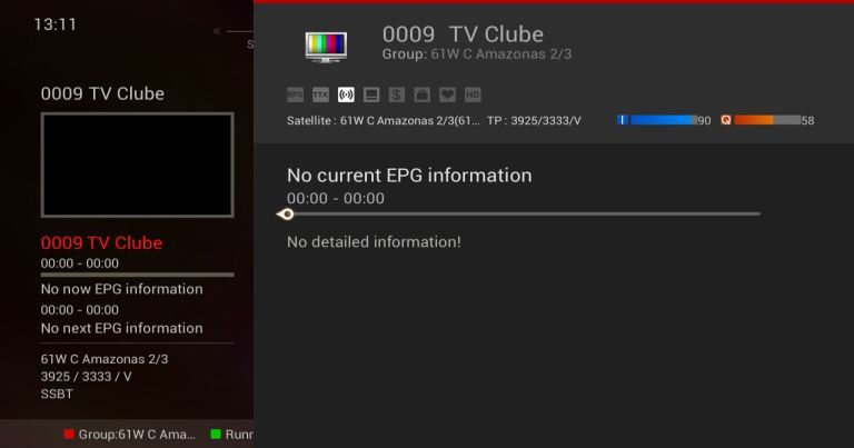

I have no C-band line of sight to anything east of 50W because of trees. A blind scan of Amazonas3 here in central NC with my 8ft dish yields 11 FTA channels. None are in English and not all are full-time channels. Quality varies depending on the time of day but is generally between 48 and 65.
