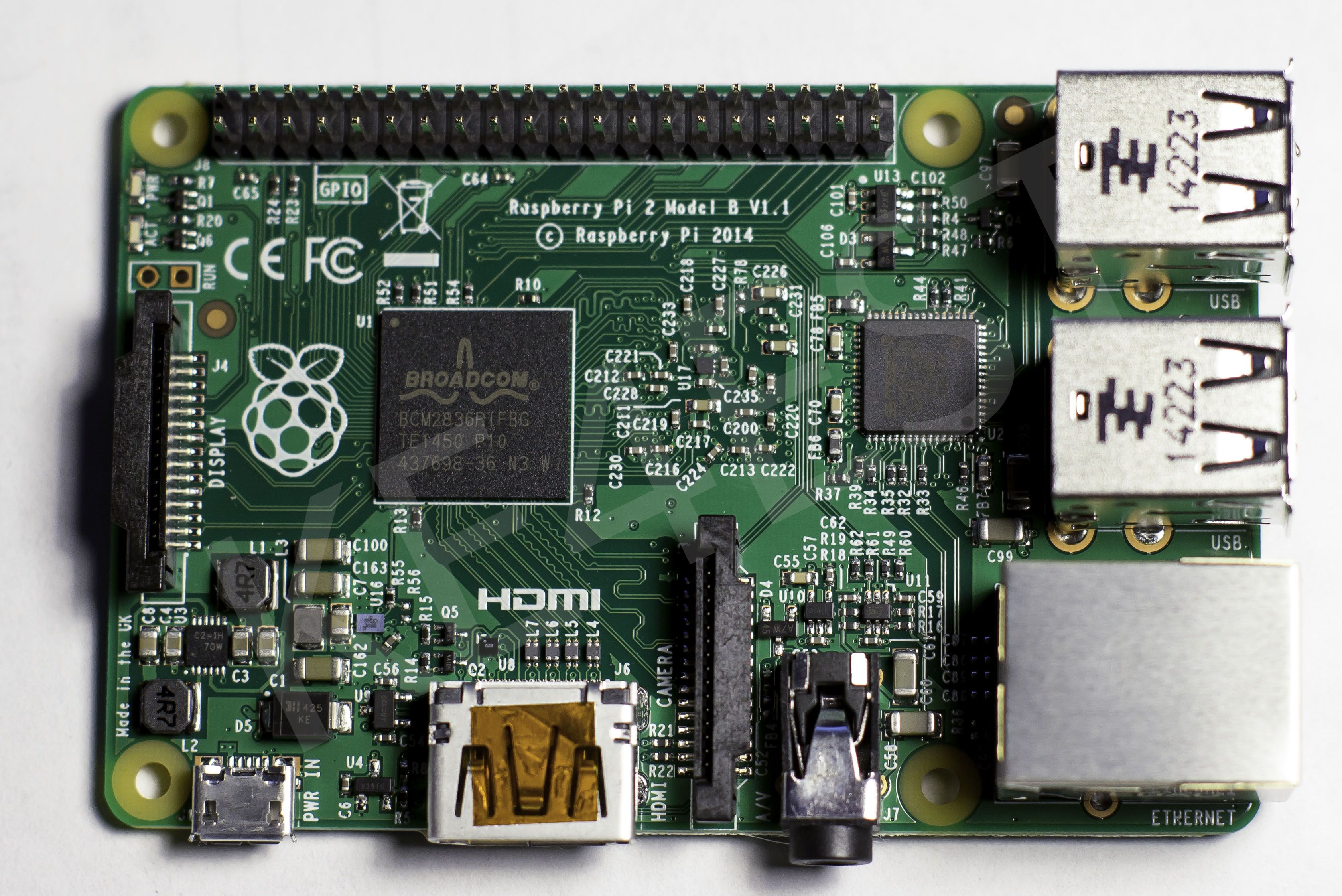

Got mine a few weeks ago and I love it over the B+, although it is a lot more picky on power. If it dont like the power supply your using you will see a rainbow box in the top right of your screen every once in awhile. :)
Reactions: Titanium
Yeah I have read that you have to make sure you are using a good power supply, especially if you plug in a full size keyboard and mouse.
Will fire it up in a bit and do some testing with it. Looking forward to seeing the performance boost.
Just got this in the mail today!
I just got my shipping notice a few hours ago, it should be here soon. Luckily I will reuse the accessories from my old model B and save some $.
I did have to order a PI 2 specific case however.
