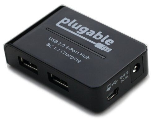

On my old model B I had to use a small powered USB hub to get all my accessories to work. I worked like a charm in taking the load off the Pi's power supply.
Its pretty small.
On my old model B I had to use a powered USB hub to get all my accessories to work. I worked like a charm in taking the load off the Pi's power supply.
Yep that is the best way to go. :)

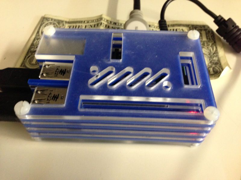

This case looked great, but the RTC (Real Time Clock) unit will not fit inside the case as each layer has different cut-outs and is extremely brittle material that snaps easily (yep, I did). Will need to either add a GPIO riser or check out other options down the line.

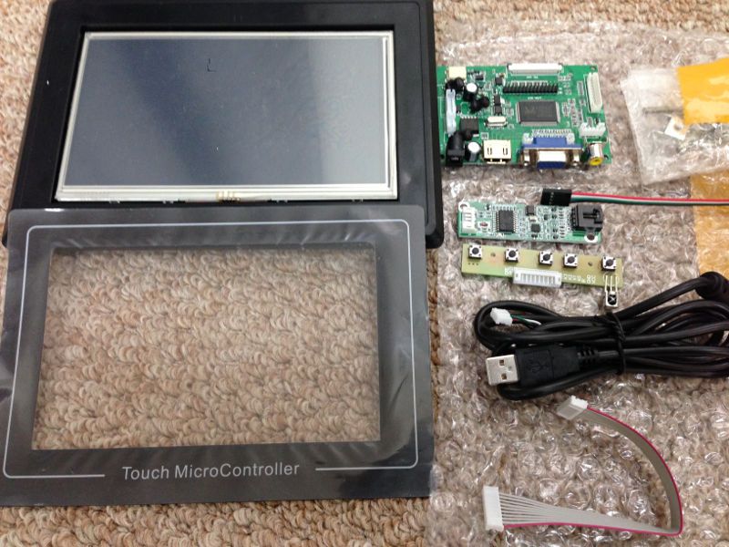

The 7" LCD with driver, touch screen, control pannel/IR receiver, power supply case has great real estate for operation, but will be too large to fit the ASC1 case faceplate. The LCD poly case might make a great portable stand-alone case and has enough room to house a laptop type battery and the RPi2. This hardware could pair nicely with the UpdateDVB firmware for a portable spectrum analyzer and signal snooper!
Does that screen run off USB or 12v power? What's the resolution?
UDL
That is an impressive 12/5Vdc portable power source! Thanks Updatelee!
Test fit the RPi2 inside the LCD case and plenty of room left for a battery and USB tuner or two... :)
