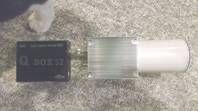

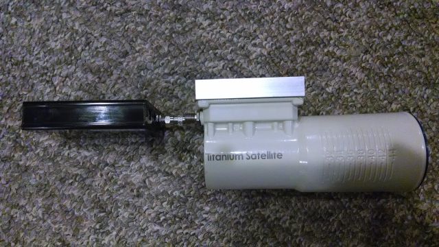

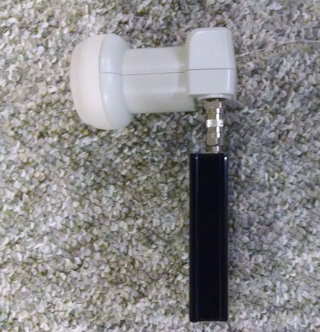

You could throw the RPI directly on the tuner, it's a host. Again it's getting the power to it.
Kinda looks cool having it all in one. Esp if you put a WiFi adapter in the RPI. Now you supply power and the entire thing is wireless minus the power.
There are pico power atx adapters that are super small. Like basically built into the atx plug small. These will supply the 5v and 12v required.
