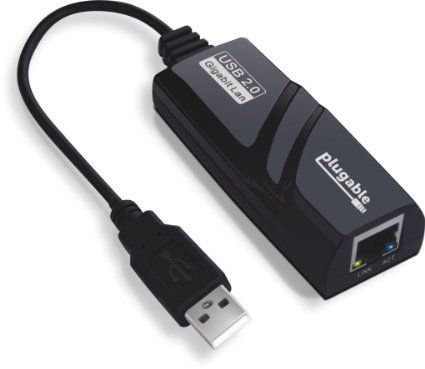

My first thought was to use the same methodology as above using this:
It is a Gigabit Ethernet USB 2.0 adapter with Linux support. But then I thought about the theoretical maximum speed of the microSD as published is 384Mbps whereas theoretical USB max is 480Mbps.
In this case the microSD would be a theoretical bottleneck. Then updatelee mentioned dd to an external drive which would remove any microSD bottlenecks from the equation, especially when there are no published write speeds.

My only issue is what device to use as the test subject? I don't have anything on hand good enough.
You really want to test a device where the bottle neck is usb bus speed and not read/write times of the media itself.
Is there someone else that can run the USB test using dd?
If not I can try the Gig Ethernet adapter.
So the equation (Measured USB Max Speed) - (Measured Ethernet Max Speed) should give us the remaining throughput left over on the USB bus for a tuner.

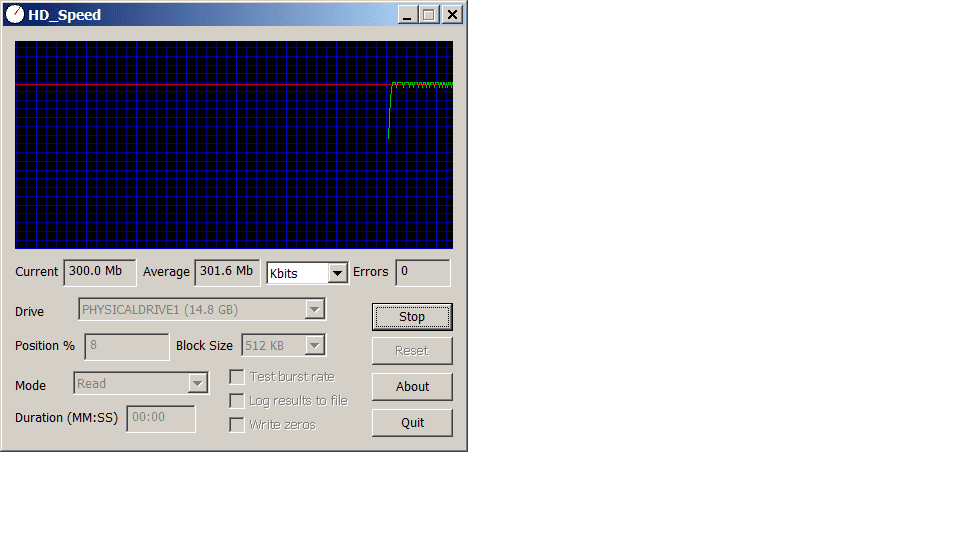

Just a quick note. On Win32 Disk Imager I noted the following when reading and writing an image to the above mentioned microSD:
Read speed 33 MBps = 264 Mbps
Write speed 13 MBps = 104 Mbps
This laptop has a proper card slot.
So far it does not look like the card will be a bottleneck for the Ethernet tests.
I don't have a way to connect a microSD to my ITX Box to test using dd.
I found a windows program to test it's speed using my laptop's card slot.
Read speed of around 300 Mbps (vs 384 Mbps published) and write speed of about 97 Mbps.
Once again, good enough for Ethernet testing. An inferior microSD card would definitely hurt Pi performance. Doing some research, there are some really really slow microSD cards out there.
