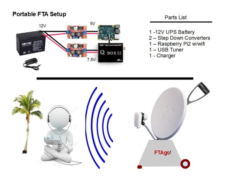

Practical and Fun Application of This Technology
Take your favorite shows camping, tailgating, to the beach or summer rental!
No wires, stream to your favorite device, or Pi based TV tuner.

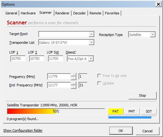

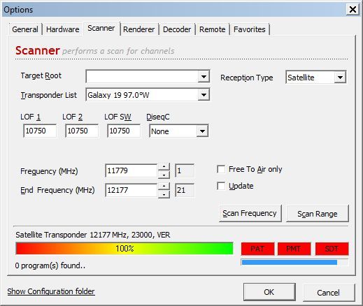

Help Needed with Tevi S662 in Windows for testing.
I switched gears and started working with the Tevii S662 since the S660 had driver source, headers and includes to other modules that I could follow in the new kernel source. I just started with the dw2102.c file replacement and followed the dependencies wherever they took me. It been taking a while since you have to wait for a 4 hour compile to complete just to get a failure and go back to the drawing board. But I am at the point where the Tevii S662 is recognized by the kernel and mumudvb on the Pi2. After compiling and fixing things for three days straight. Valuable experience to tackle the TBS5922 soon.
The problem is the tuner wont find anything on the PI or in Windows! I may have a bad Tevii.
I switch the cable over to my TBS5922 on the other linux box and boom channels, not an issue with my dish setup.
First I need some help with the tuner in Windows. See the attached picture and tell me if I have the scan settings correct.
The transponder frequencies, polarities and symbol rates in their 97W transponder file are mostly valid.
The second picture looks like its getting a good signal, just no channels.

View attachment 105529View attachment 105533
it looks like the lnb is setup wrong in your program what i have noticed in windows dvb software is that north American ku standard lnbf is label as ku circular and the ku standard is for ku universal lnbfs
it looks like the lnb is setup wrong in your program what i have noticed in windows dvb software is that north American ku lof is label as ku circular and the ku standard is for ku universal lnbfs
What are the correct settings for LOF 1, LOF 2, and LOF SW? 10750, 10750 and ?LOF SW?
Which dvb program are you using because there may be a ku circular setting which will set LOF to just 10750
The settings for LOF 1, LOF 2, and LOF SW Is for universal ku lnbfs that you have to specify ku low frequency ku high frequency and the switching ku frequency
lof 1 should be the lnbf you are using ;; 10750 is standard L.O. local oscillator (10600 is if universal lnbf lo for NA); lof 2 0 (other lnbf if standard and 9750 if universal 22 khz. "off") lof sw none for standard lnbf; and 22 khz "on" (555timer) if universal for 10600 would be in lof 2 (22 on) NA frequencies; and 9750 would be in lof 1 22 off? Some of the receivers have auto-detection for SW; some receivers have blind scan. switches in lnbfs universal can need other lo sets; but the switch is always high (22 on) to get the middle of NA frequencies in bandwidth. I am watching Madame Sec. (good wife?)
LOF - line your firing control on. where the 14/18 vdc siwtches; and any other switch tone. if one wire to lnbf lof 1 is the wire going to it.
It is the program that comes with the TEvii S662, called tevii player. I put in 10750,10750,10750. It is uses a standard Ku lnbf. I also tried 10750, blank, blank.
