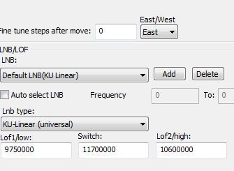

It is the program that comes with the TEvii S662, called tevii player. I put in 10750,10750,10750. It is uses a standard Ku lnbf. I also tried 10750, blank, blank.
try this program smartDVB i had real good luck with it when i had my s662 and you can set it up like the pictures shown it is attached below
tevii player doesnt look as easy to setup and use as mytheater that they use to package with those tuners

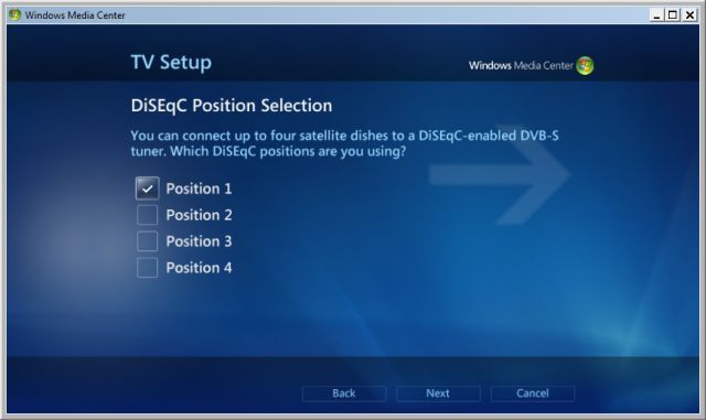

Thanks I will try that too. Since when does Windows media player do this? That's nuts!
Its Windows, they have the Sat names wrong, I could have guessed that. haha

Typical setting for a Standard LNB:
LO1 - 0
LO2 - 10750
LOF - 11700
Universal LNB:
LO1 - 9750
LO2 - 10600
LOF - 11700
LOF is the switching frequency between low LO and high LO.

10600 blank blank worked the last time i had winkno's installed (windows). The boost is the debug on 22 khz on or off. 10600 however; will allow some lower frequencies of the whole pie is not programme matched per Country (match for/by the freq./sr/pol. entered) to come in when it is truly a universal lnbf circ. or linear it does not care (a piece of plastic in lnbf does this); just the task in getting a number of numbers to match where they are "a slice" of raspberry pie. Has anybody USB 2/3 typed network definitions into enough of them; to allow say a number of single-ended users with correct params to multi-output to multi-users say "any old pc" type installation; for companies with many cellphones?
10600 would only be used with a universal type LNB. It also must be used in conjunction with 22KHz switching. The 10600 setting is not correct for use with a standard type LNB (LO of 10750).
A mismatch of the LO will not log additional frequencies. A mismatch only incorrectly identifies the downlink frequency.
sO, if the program for the operating system (driver); has a 10600 parameter at the display; it tells the tuner to set-up the defined channel list from the frequencies; or if the defines are 10750; and just the displayed information that set's the LO? In some receiver's, the 10600 also forces 22 khz on (and the freq's. stay aligned for NA freq. listed) instead of showing 10750; it really aligns the tuners pre-defined center of a band (which is a 500 MHz. for NA) depending on the lnbf it needs to tune.
10750 seems only the force to tune each slice...what if the pc program i got was from Australia; where they talk in different language. Their channel list would have different defines for each typical australian lnbf would use 9750 3.4-3.9 and then the defined channels setup the tuner.
What I am saying is; the display is not lying; it just can lie to yout eyes by doing more than one thing with a display (because it does say 10600; but it really means center of band for tuner). Window's uses .bak; a problem is the child...
Darn if my dvb xxx does work 11789 V 28125; and the program needed 10600 to set the tuner up right on a NA listed; then the freq. lock worked correctly (equipment manufactured for ascertain any country).
Lucky for me i am old; do not have to know that is how it works. Update replaces old .bak's! As a spectrum analyzer and a oscope both on the same machine shows, what slice is locking! The trinket is that 2x500Mhz. is selected with 14/18vdc sw. Then the 10600 I entered into my card dvb really meant center of standard lnbf because the .bak told my tuner with a local oscillator to 14vdc lof1; and center tune a stabbard lnbf; because the .bak told it to do ALL OF IT!

If the user manually inputs a frequency parameter then the LO must be correct and matched for the calculation to tune the desired IF.
A defined LO frequency does not force a 22KHz signal. The LOF identifies the switch point if the function is enabled If the defined downlink frequency is below the LOF, no 22KHz signal is issued.
There isn't such a thing as a different language. LO frequencies and LOF switching operate the same internationally with any LNB type or LO frequency. A LNB either has one LO or two. If two bands, then a switch point is defined and issued to select the band.
Tuner frequencies are based on IF, not downlink frequencies. If the software allows and the user wishes to define frequencies as IF, then no LO frequency is necessary.
Reactions: fred555
And, the tuner selects the slice at the width; for instance in the tuner a vco gives the exact voltage for the tuner to tune a (11789 V 28125) of the whole band; just another slice of pie or any other is not tuned.
Now look at a wifi; any test says I am getting a full 4 Mb up and down with the link I am on. But really, I am only a slice of that band I run on (which goes up and down depending on how many others are slicing around me at the same time).
What I noticed in hdvr1200 the other day was it will not tune a stacked lnbf fss by DN fully. I don't care why it doesn't. It just won't relate; or allow, the 11840 to be the auto-updated "change a definition"; that frequency isn't my matched routine (cuz the freq. is a must match) typed in rhinking; it also needs a different LO for the middle to be hit correctly (and they stack both ends to the middle, which is blanker at the middle and wider than 1 gig) when aiming it at a fss satellite g-19.
Let's look at tuners; then maybe i can understand it. The tuner in a 4DTV 922; it is marked and read as 950-2150. This should mean it can tune that band (fully 2 gig). Now I look at my microHD, the tuner is marked satellite in and 18vdc 500 milliamp. Lotta good that comparison did. The tuner is so small; it hasn't even got a label (must be new one though). These typed tuners can only tune a full 1 gig. So standardly, in fact; it can tune 2x500. And it does tune one 500 (H or V) fully at one time (or is that the loop out typed tuner?). It has usb2! And the dvb-s2 format; dvb-s hd!
