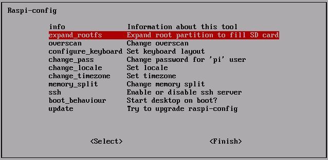

Boot up the PI, you will get to this screen:
Expand the root file system to fill entire SD card.
Once we get ready to actually watch some shows, I will explain how to setup overscan and other video tweaks on the PI to get the best picture.
Configure your keyboard.
You can change the default pi user password here if you want
The default user on Raspbian is pi with the password raspberry.
Change locale.
Change timezone.
We will look at memory split later when we optimize the pi for video.
Make sure ssh is turned on.
Do not start the desktop on boot. If you really want the gui later, type startx at the command line.
Installation of USB DVB-S2 tuners will all be done at the command line and the gui is just extra overhead during compile.
So turn it off for now.
Run raspi-config to revisit this screen later on.
