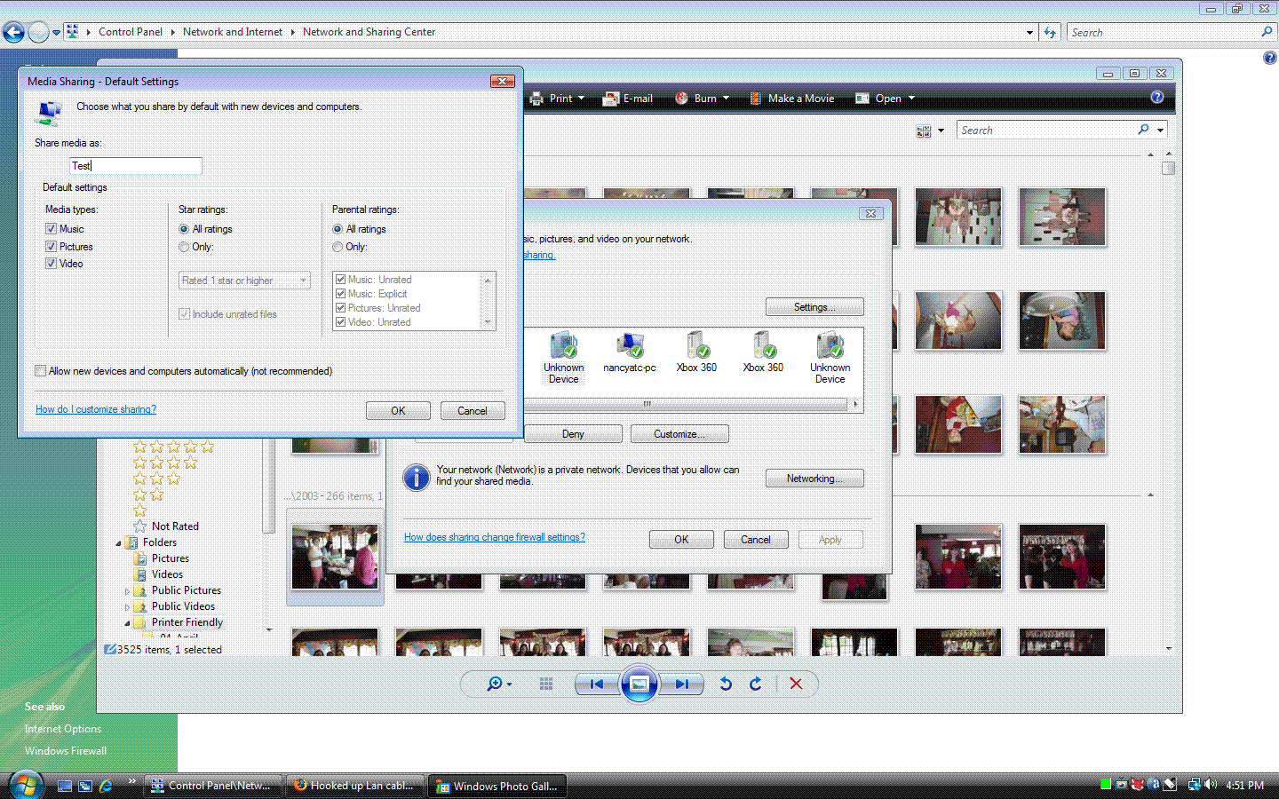

For Vista its as simple as setting up Media Sharing. It will then see the HR20 and then you have to allow it to see the server with permission toggling.
Control Panel\Network and Internet\Network and Sharing Center
Change. Find the Unknown device and allow.

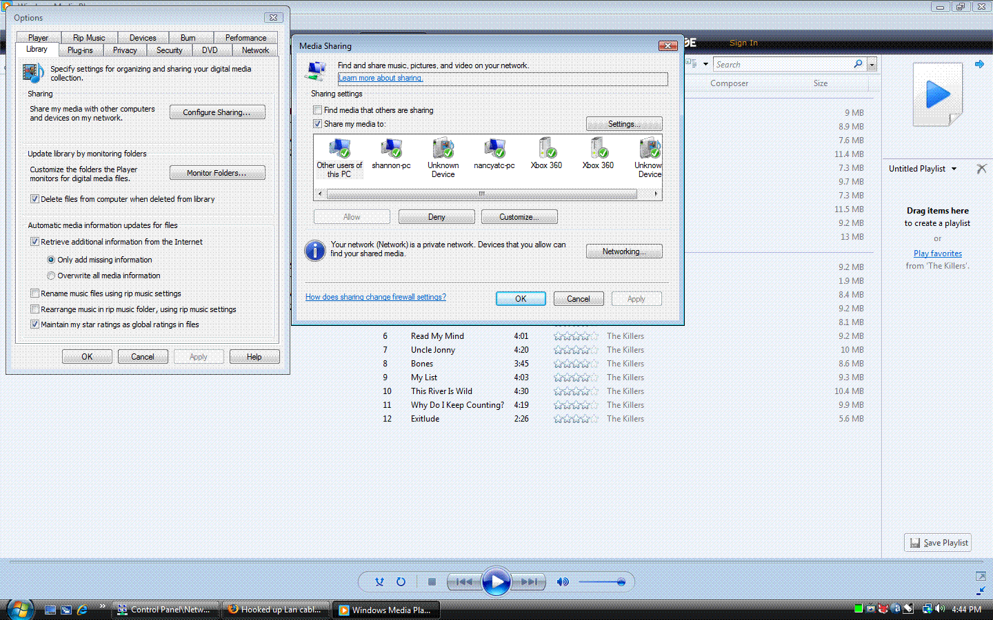

You can also do this in Media Player. Tools - Options - Library - Configure Sharing
The best way to get the folder of choice sharing is to open up Windows Photo Gallery. Define the folder using File - Add Folder to Gallery
You can do sharing here too. File -Share with Devices. Make sure when you pick the Unknown Device, you select Settings so pics are shared.
Give a few minutes for the shared folder to show on the HR20
