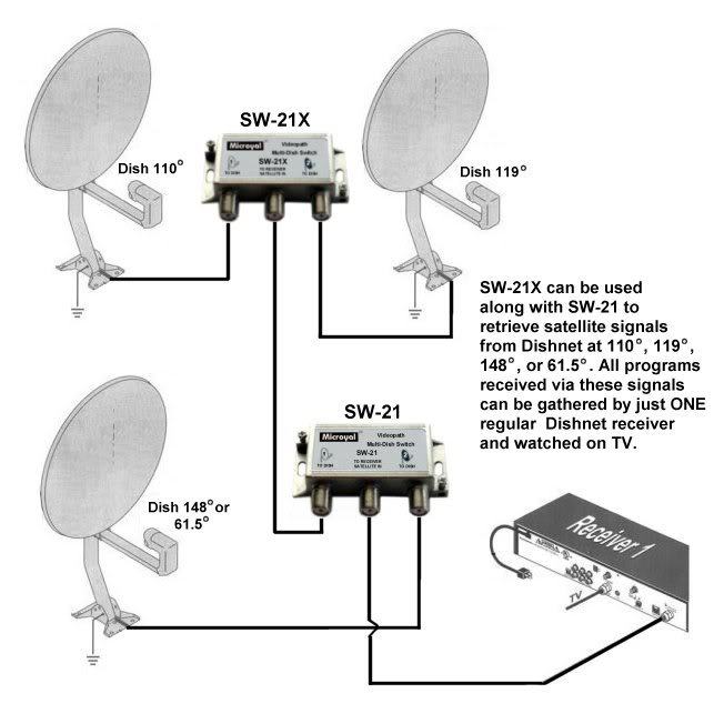

a friend of mine has a poor man's dish, 2 single lnb's going into a sw21 switch for 110 and 119.he also has a single lnb dish that he wants to get 129 for locals. question is, how do i connect all 3 cables.do i need another switch? he doesn't want to get another dish
actually if you can find a SW-21X that would work too since its a single receiver setup.
They're on Ebay pretty cheap and the setup would be as such
110 & 119 into the SW21X (make sure it says 21X)...output of the 21X into port 1 of the SW21. 129 dish to port 2
The 21X switch is like a SW42 which is very old but allows you to cascade switches. I use to have a SW42 (4 lines in 2 lines out) and SW21's for 110/119/61.5
I have used the sw21 and 21x setup, but was told you can just cascade 2 sw21's.
maybe worth a try if you have one.
I've tried that and it wont work. It will recognize both ports on the switch closest to the receiver but only port 1 on the "back" one
