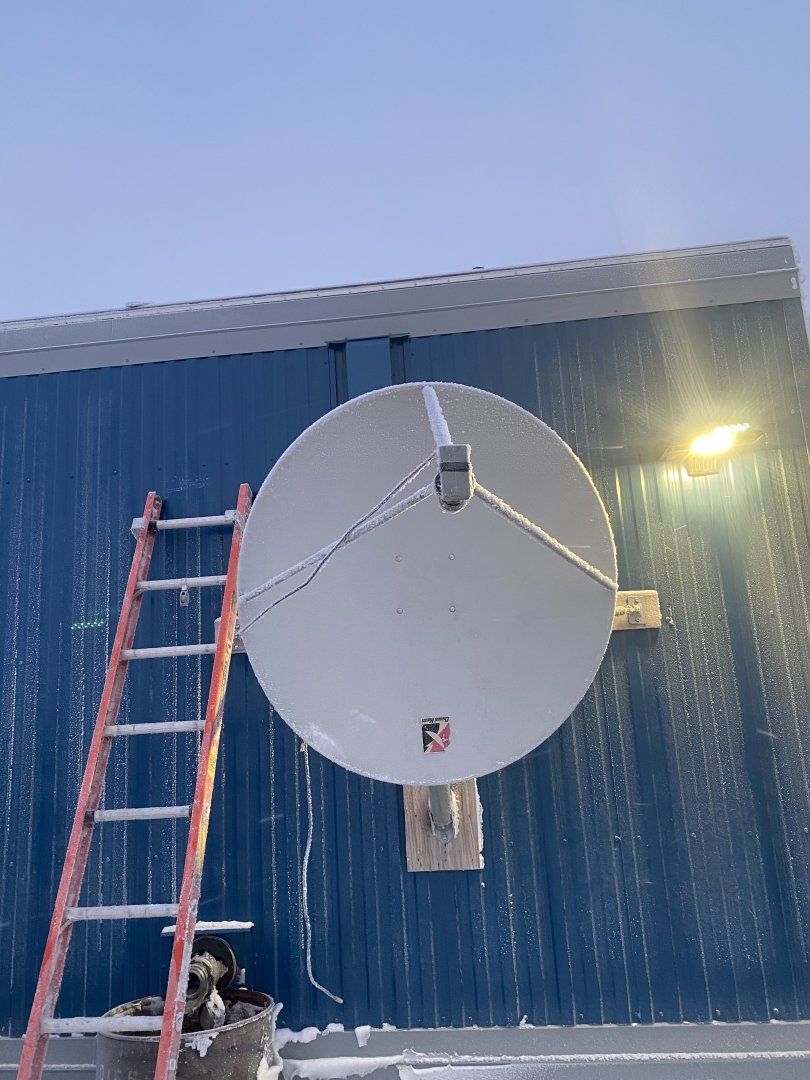

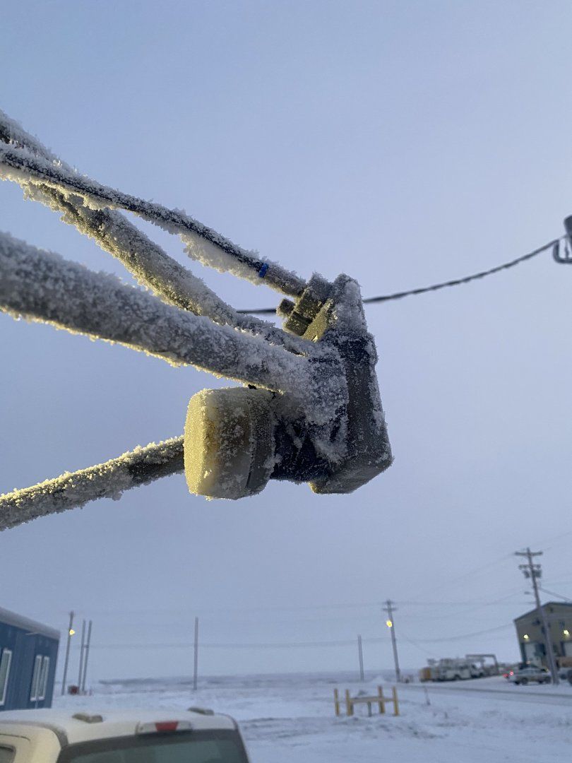

This is the current LNB and dish configuration. I need the 36" dish to acquire signal. How do the DPP 500's attach to this style of dish.

There is an older model of 1000.2 LNB that is DPP. If you can get all three satellites (110, 119, 129) then the 1000.2 DPP would be needed. For 110 and 119 only, the DPP 500 LNB should work. I am not sure how to attach the LNB's, so someone else here will have to help you with that.

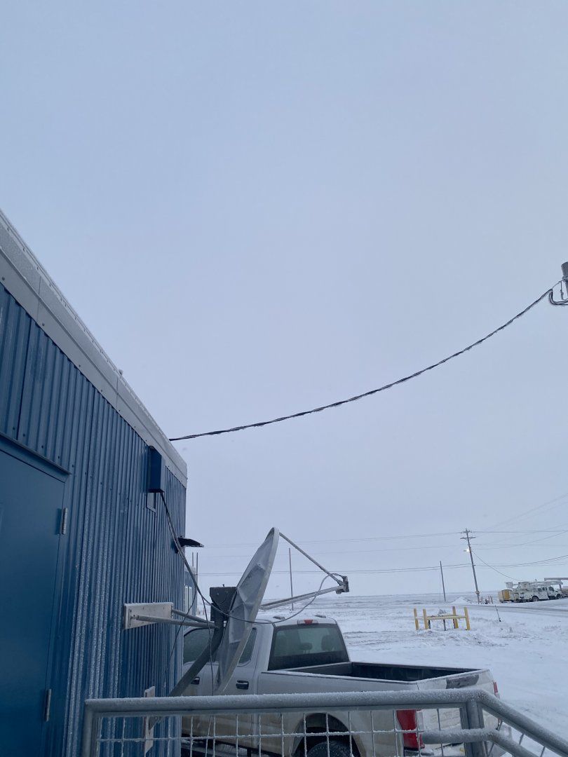

Is this what you're looking for as a side profile of the dish ?

That is normal. Mounts will not adjust to the proper angle in Northern Alaska. I spent years doing field work for Alascom in northern Alaska on C band stuff and ran Dish and DirecTV for many years living in Fairbanks. Now live near Anchorage and use DirecTV. Do not quote me but the offset angle is around 17 degrees, so take the expected elevation above the horizon and add offset angle to get in the ball park.
So I be looking for a degree in the 25° Range based on a 17 degree offset ?
You are WAY WAY off there. Probably 34 degrees low.
Gotta go way up gotcha, I did some perusing of the village and it appeared that most of the residents dishes were pointed almost at what looked like directly the ground.
I'll adjust the dish to see if I can't be gin to get a signal.
