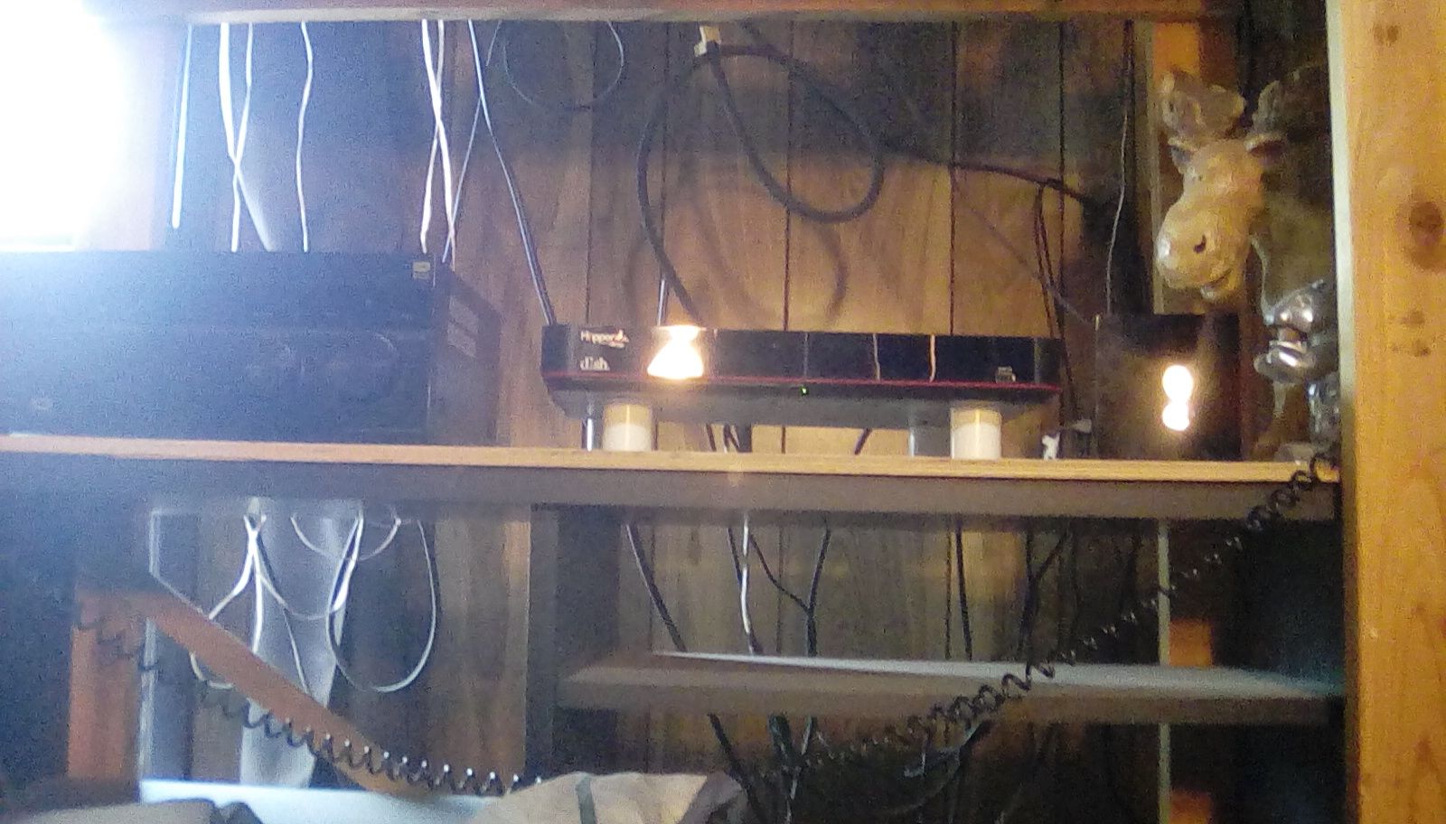

I found these PVC pieces at Lowes and place them under my hopper. They are just the right size and raising it up helps keep it cooler I think.
