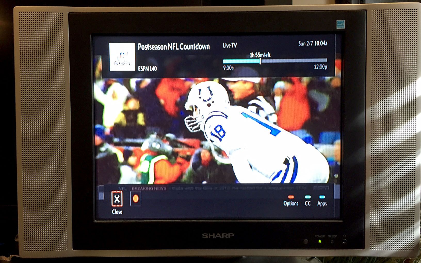

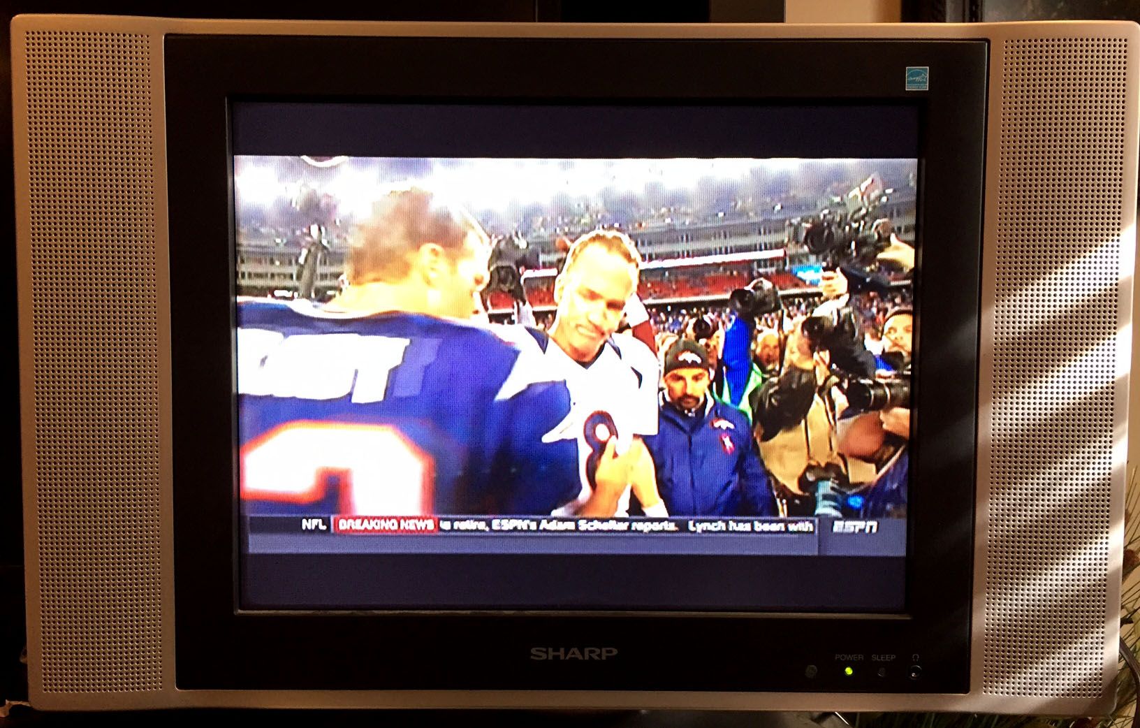

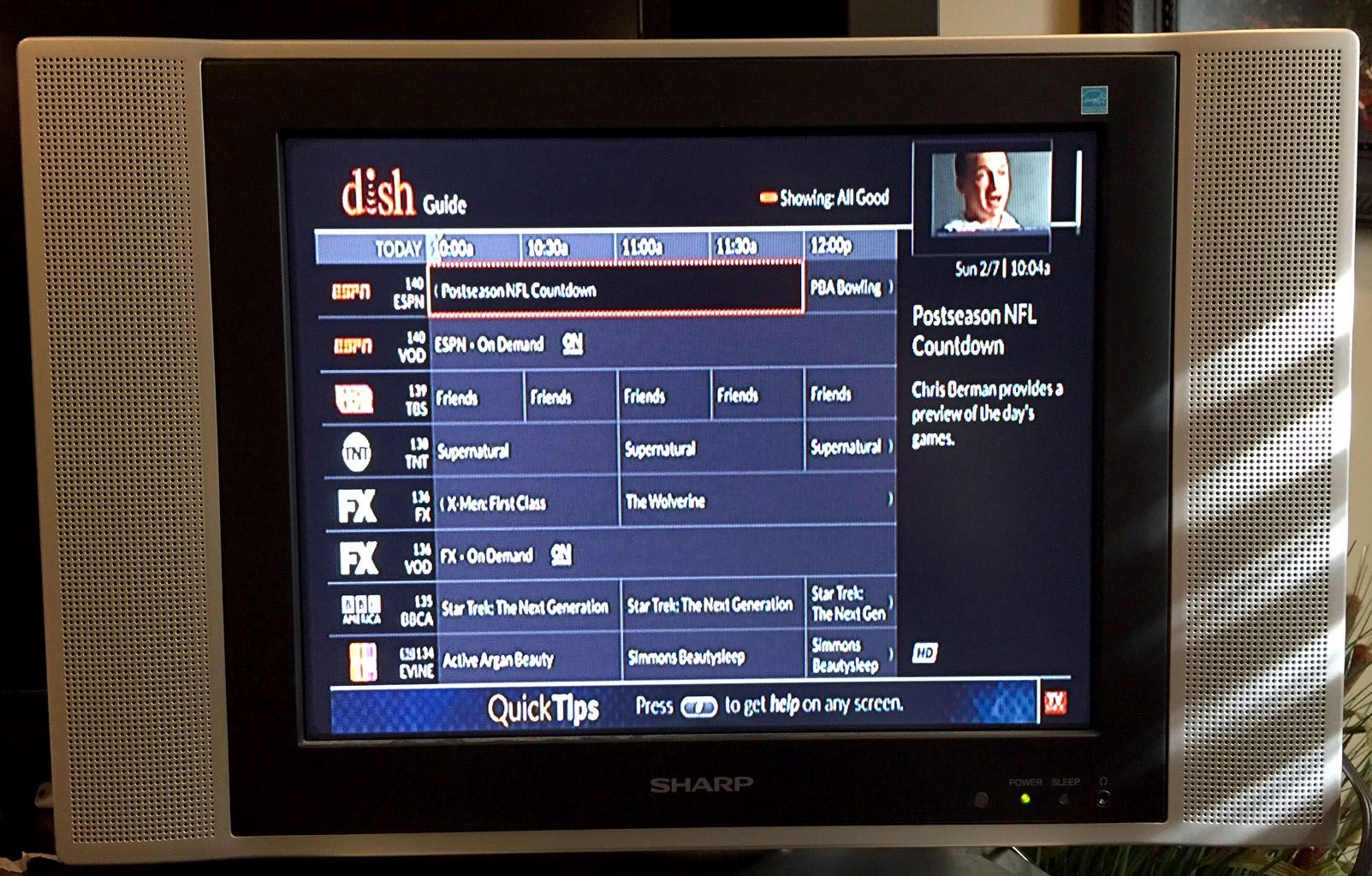

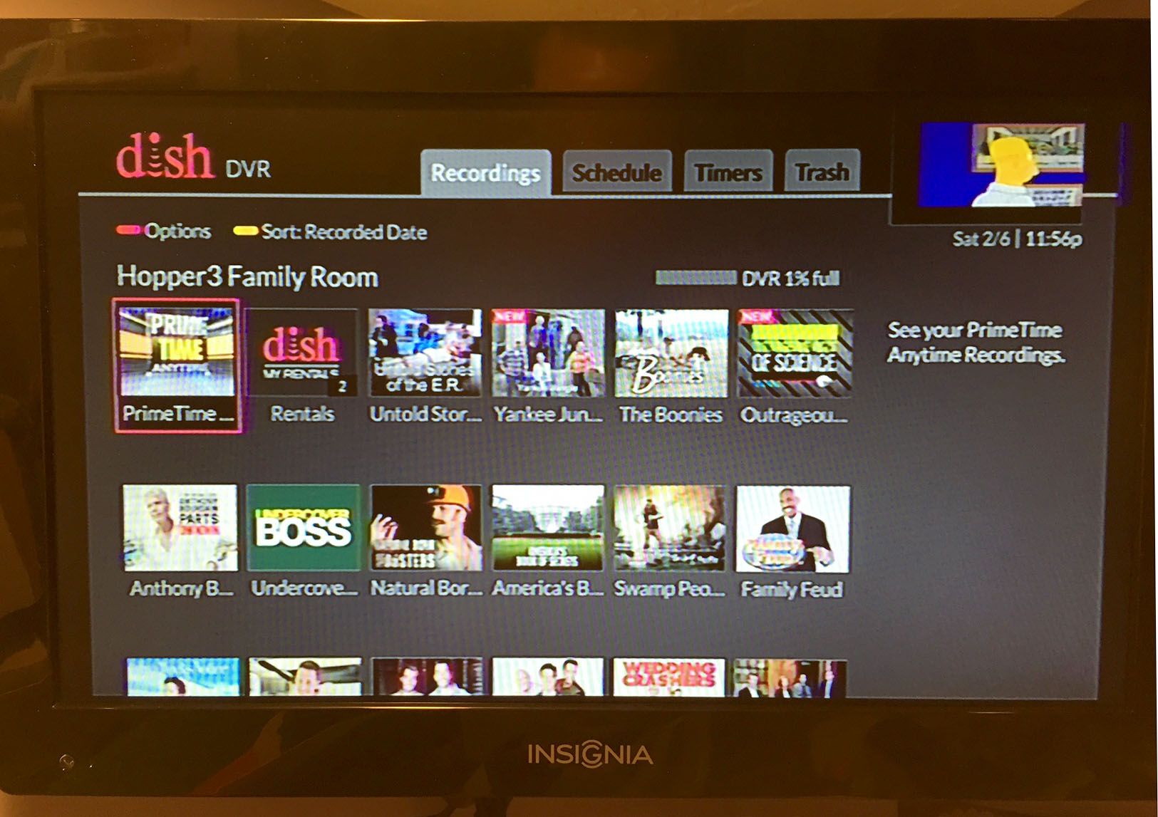

The video coming across to the smaller TVs in my house is being forced into Letterbox (black bar on top and bottom) by the H3 and Joey 4k. The H3 and Joey 4k graphics (ie. Guide, info, Home screen, etc) are proportioned correctly, but the video feed of HD and SD channels are forced to letterbox size. I cannot find any settings on the H3 or Joey 4k where I can affect the video coming out of the Composite outputs. I have plugged a TV directly into the H3 via composite cables (yellow, red, white) and the same behavior exists, so I can rule out the modulator as the culprit. The modulator does degrade the video quality, but that is an entirely different issue.

The attached images below show what is happening when the Receiver is squishing the video vertically, but the GUI is normal. Very odd.

I have been using modulators since 1995 and hope that they work the same as they do with the HwS. Menu/Guide full screen, programming Letterbox. But your programming look stretched. But that's on a 16:9 screen (your pics). What about on a 4:3? I trust that's what the output is set for and would look "normal".
Letterbox on the composite A/V output is the new standard for the latest software in all Dish receivers from the 211's on up. The way I got around it was to buy a component to composite converter so I modulate the component output and it looks good on mirrored TV's again.

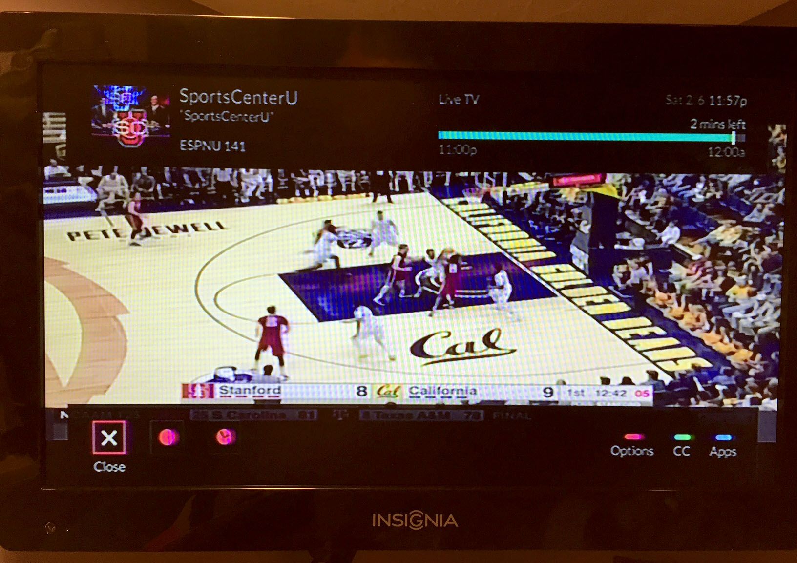

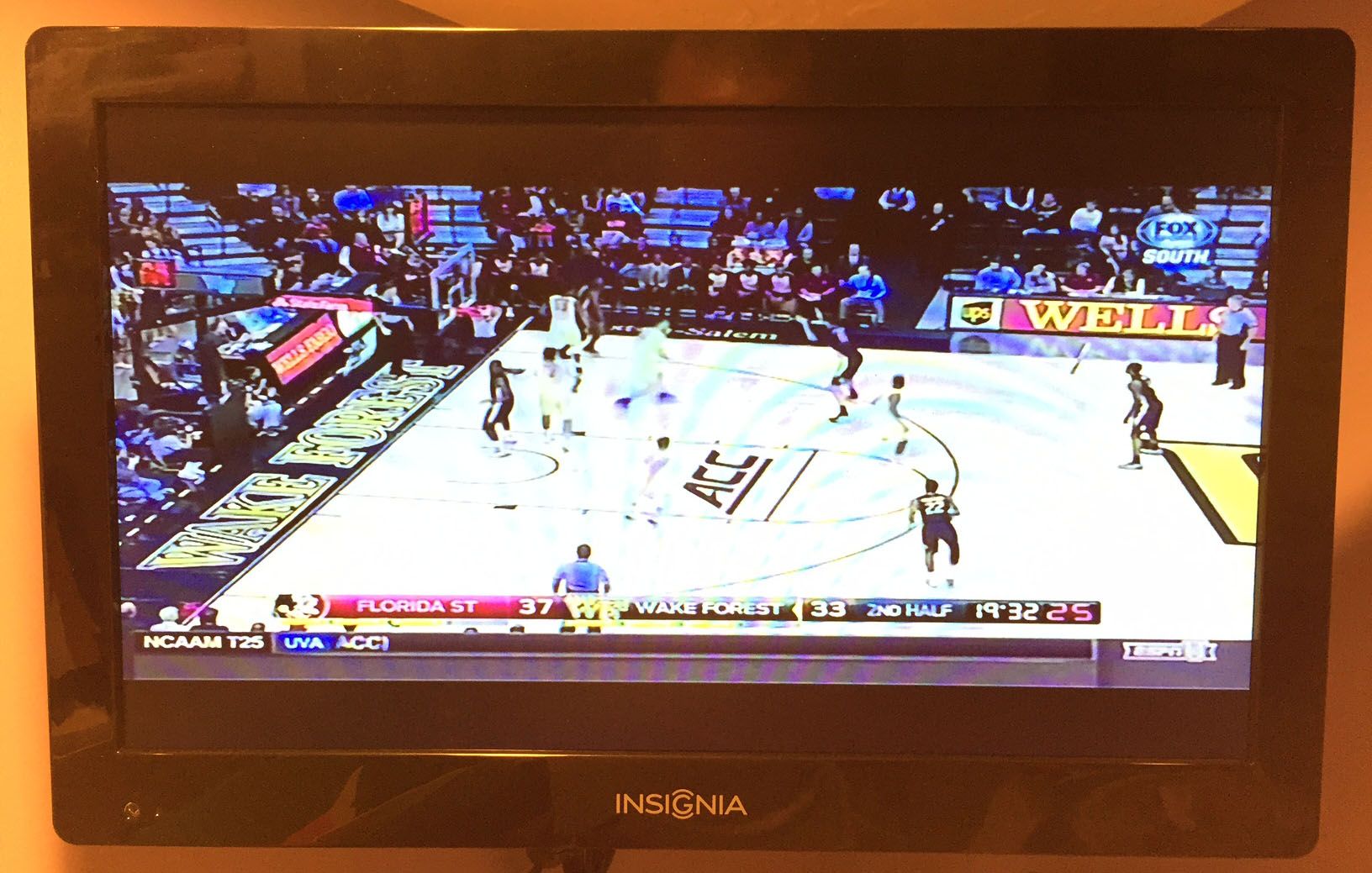

I tested an old LCD 4:3 TV by directly connecting it with Composite cables from the 4k Joey and it is formatted correctly for 4:3. See pics below.
