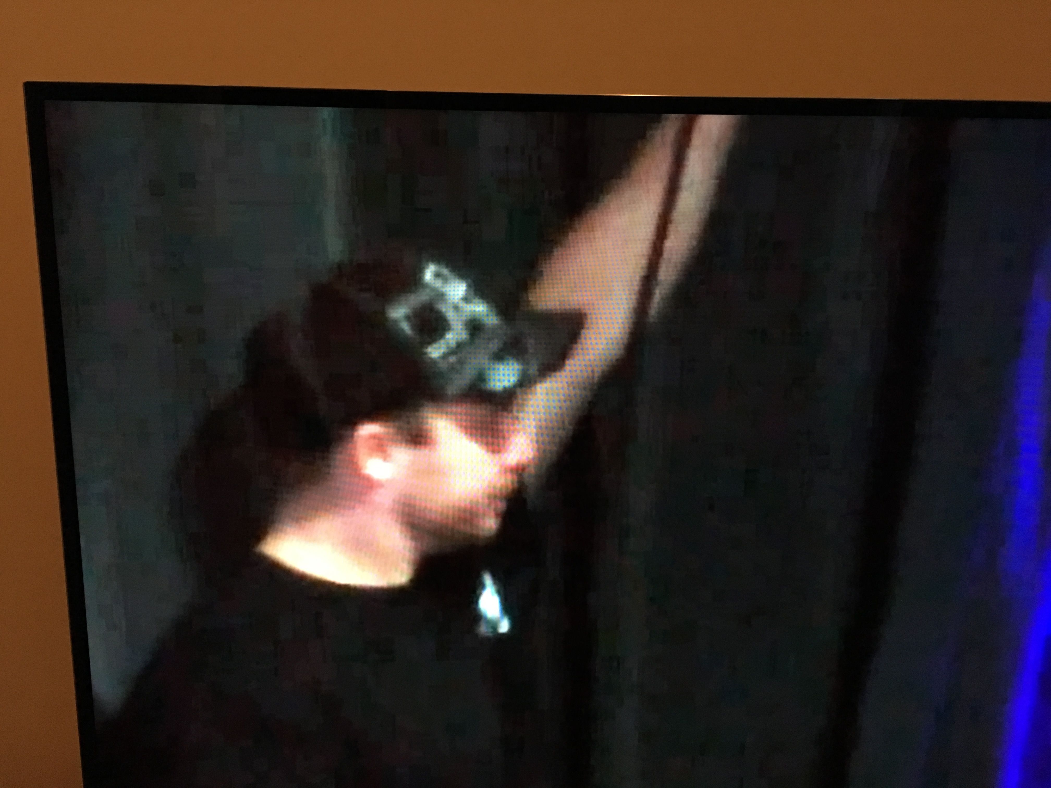

Hopper 3 terrible HD picture
Whoops helps if I attach the picture.
Here are some pictures.View attachment 114038
This is on an LG 65EF9500 4K OLED
What channel and show was this image taken from?
This whole issue boggles the mind and common sense.

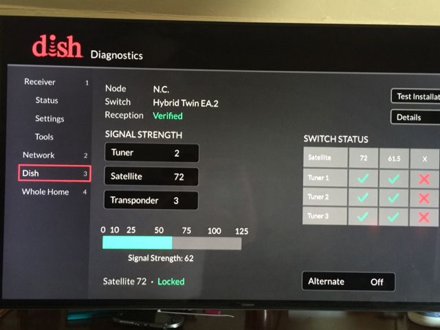

My thinking is that everything in the Dish system, i.e. LNB, coax, hub, and inputs to Hopper and Joey has to be good. It's a digital satellite signal and a digital MOCA network connecting everything. That all seems to be in place. If it were faulting, you'd see many other issues associated with corrupt data streams, not just poor video quality.
This leaves something suspect in the video stream delivery, from HDCP compatability to a prossessing issue.
What's the effect of a low bandwidth HDMI connection?
Would a ground loop introduce anything to consider?

Even component cables looked the same. It was Fox but all my channels look terrible.
Then thats great all they need to do is bring a Hopper with sling out and hook it up to try it. Easy enough.
Yup as if they swap everything out it's only more work for them.
Again its not the LNB or even the cabling. Its digital, meaning it decodes or doesn't decode. The LNB and cable dont change anything and if the signal was too low you wouldn't get a picture at all. Because its digital you gets whats there as it is there the LNB and cable do not change that. Its not like the old analog days where if you had a weak signal then you would get snow or ghosting. Digital is digital.
Again I believe this could be a power issue to the Hopper which is causing its output to be sending out crap. Which is why it looks bad on the other TV's too. The power issue could be not enough power or too much. I don't think its the Hopper 3 itself as they changed it out... which again because you are getting signal from the LNB and the Hopper 3 is able to decide it and because its sending out a crappy picture to each TV tells me its more than likely a power issue.

So are we saying my whole house has a power issue or the Hopper 3 is just more sensitive to it because we did move the Hopper 3 to another TV and power outlet with no improvement.
What kills me is the 4k on demand played right off my hard drive look great. That should take everything in the house off the table as an issue because those are downloaded from internet to the hard drive.

Hopper 3 is set to 4k, 1080p, 1080i not really many other options. I have tried all the picture settings and they all look equally terrible.
My TV is using the same calibrated picture it was using with the Hopper 2.
